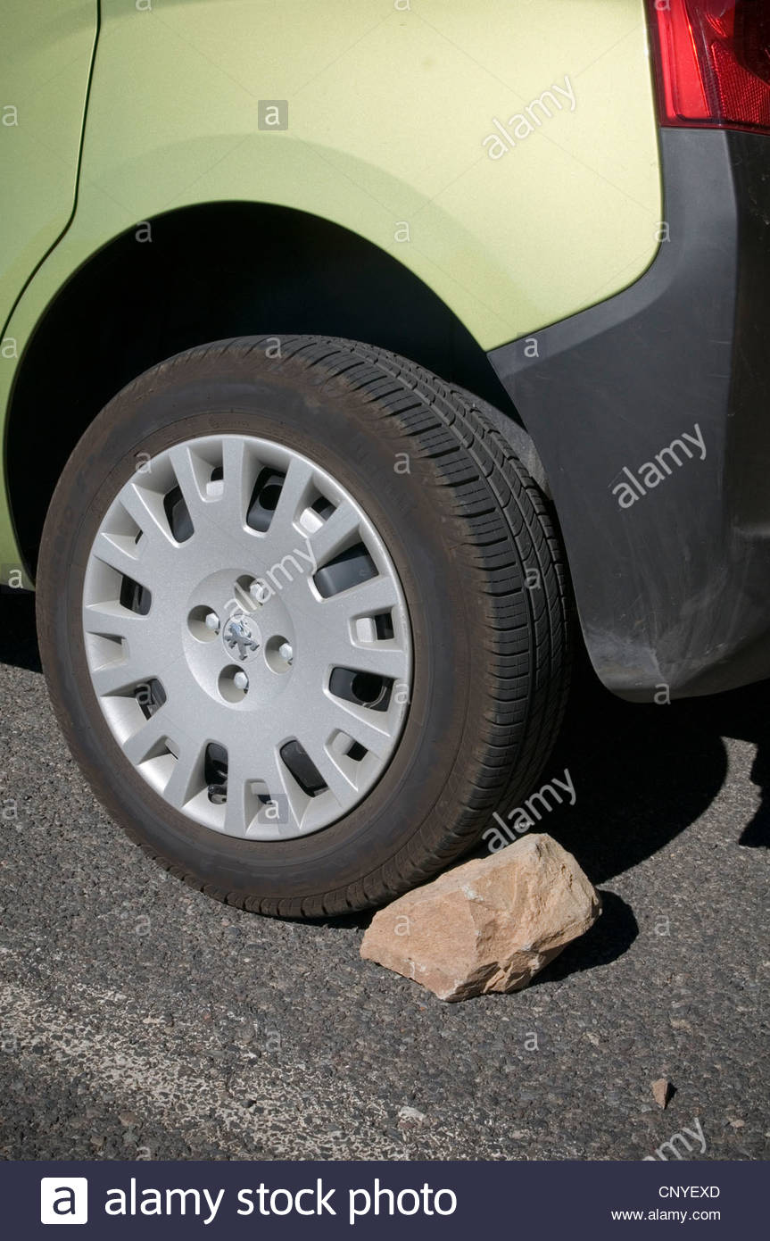

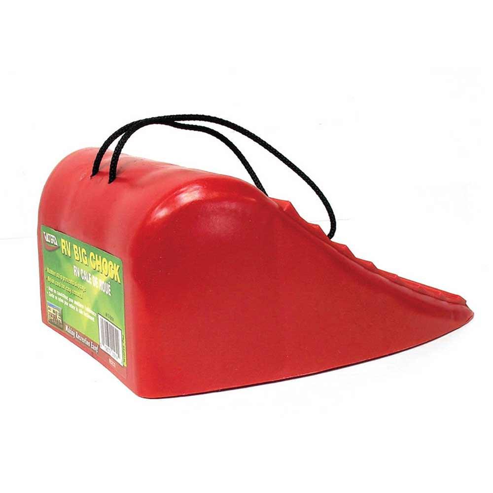

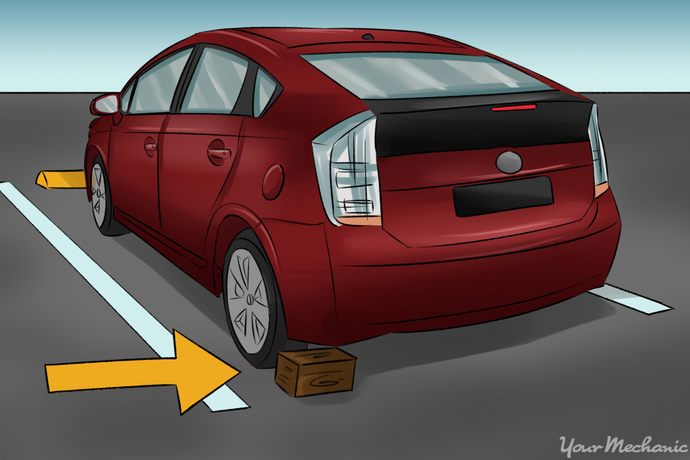

If really concerned it will be back to the future and the need for Blocks / Bricks / boulders or Chocks in front of the wheels in the coldest of weather.
5a6eecef7d5f4_4b-HowtoChangeaTire-carparkedonaflatsurfacewithreartiresblockedwithalargepieceofwoodarrowpointstowoodpiece.jpg.70cea9aacada2e9003d62dd5fc209e72.jpg
wheel-chock-chocked-handbrake-hand-brake-brakes-hill-parking-on-roll-CNYEXD.jpg.4b2980a6422aa8cf6bb397f140a8f159.jpg
