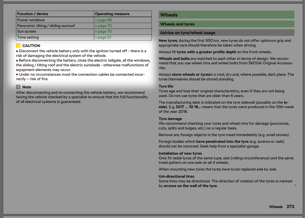

Window madness can be due to memory loss caused by disconnecting the battery without proper precaution.
Resetting the memory is a service job, I'm afraid.
