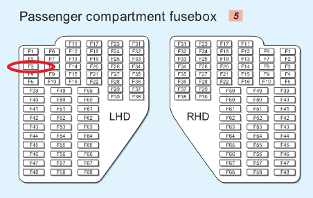

1. What possible causes are that my scanners are not communicating with the OBD2 port and ECU computer? Is there a fuse that I need to check in order to the port or ECU to work with the scanner?

Is the car left-hand drive?
yes
left side is the driver side
19 minutes ago, lalwong said:
yes
Fuse number 3 is the diagnostics fuse. It is 5 amp.
Edited by TMB
Thanks, I will check that for sure. Then will go to other steps for fuel pump relay, etc. Thanks a lot. I will let you know the outcome. Have a good night
No problem.
Have a good night
You too :thumbup:
Fuse is fine. Something is wrong with the K-line pin 6 will further search as I had read an aftermarket radio can cause this problem
