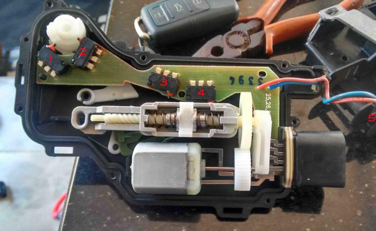

There are two microswitches inside the lock module that tell the system that the key has been turned. One of them could be faulty or have a bad solder joint. You would need a new lock module or to fix the bad solder joint(s) which requires the door stripping down. Stripping the door is not easy unless you're good with that kind of thing.
Numbers 1 & 2 in this pic are the key switches.....

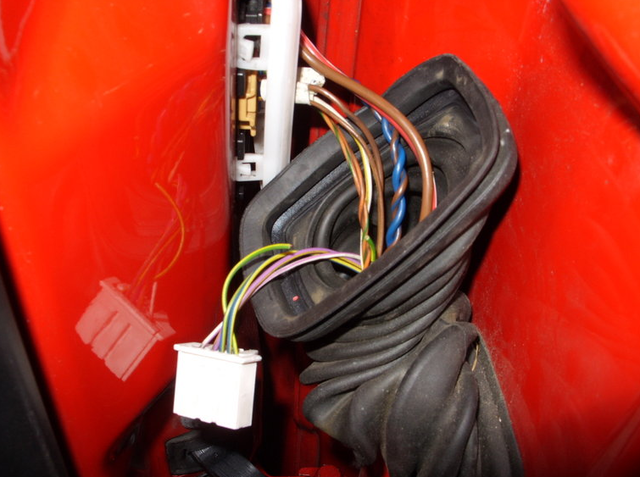

Also check for broken wires inside the rubber door bellows and check for corrosion at the plugs/sockets.
