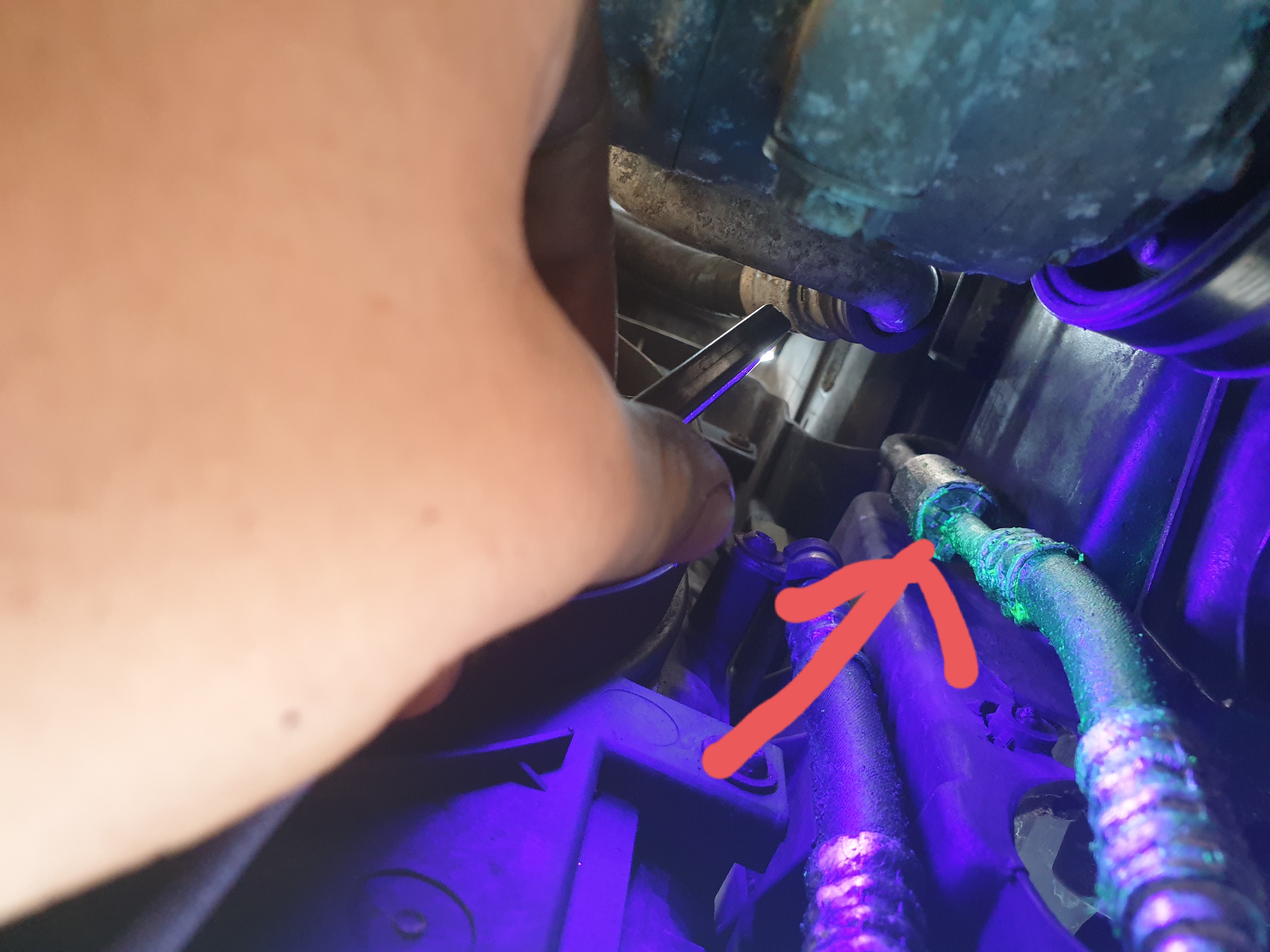

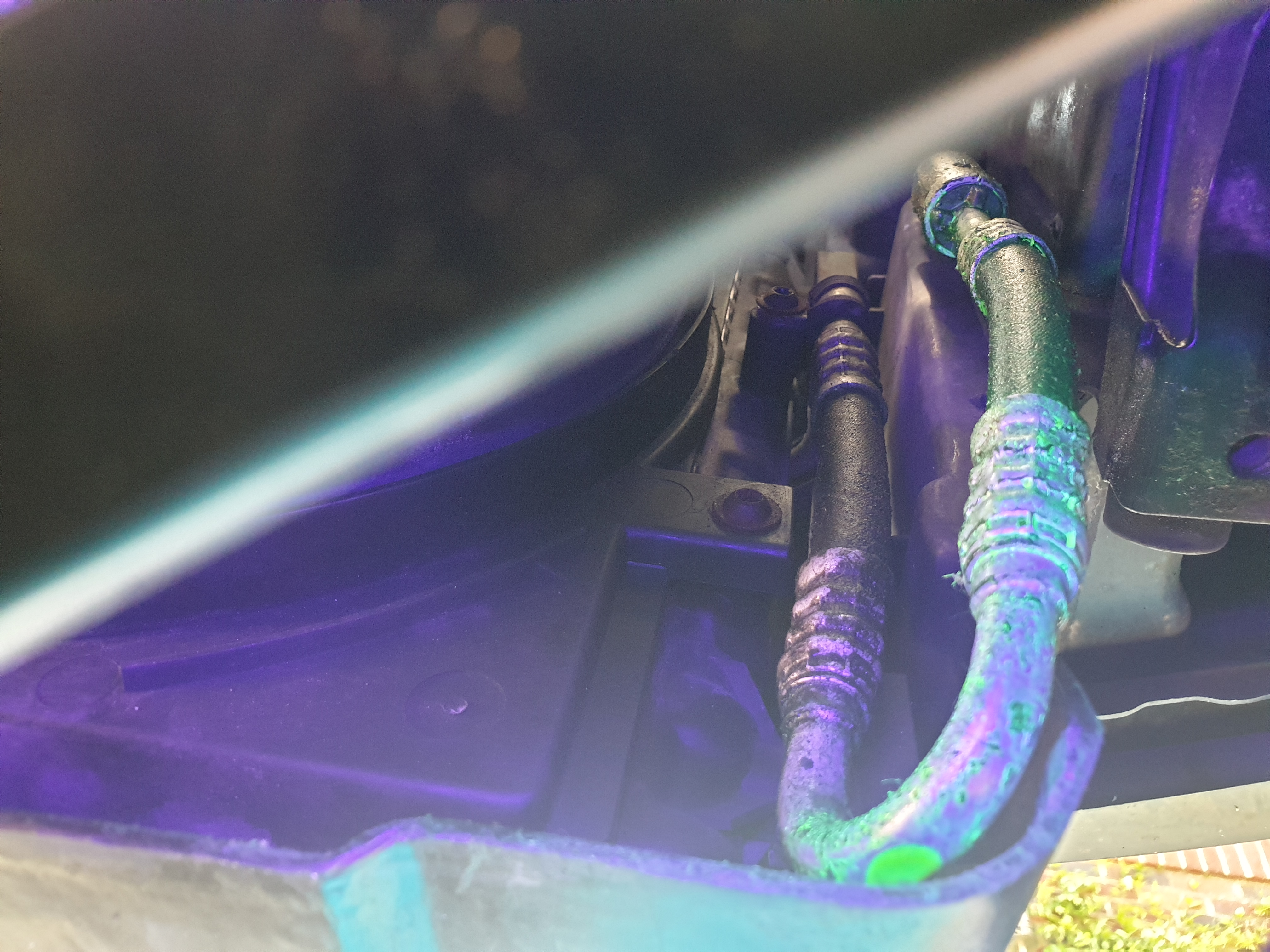

  9. Also looks like this bit is leaking from the point with the arrow.
  10. I suspect as in the picture that my ac is leaking slowly from the low pressure side. How difficult is it to replace that seal? And which part would I need?
