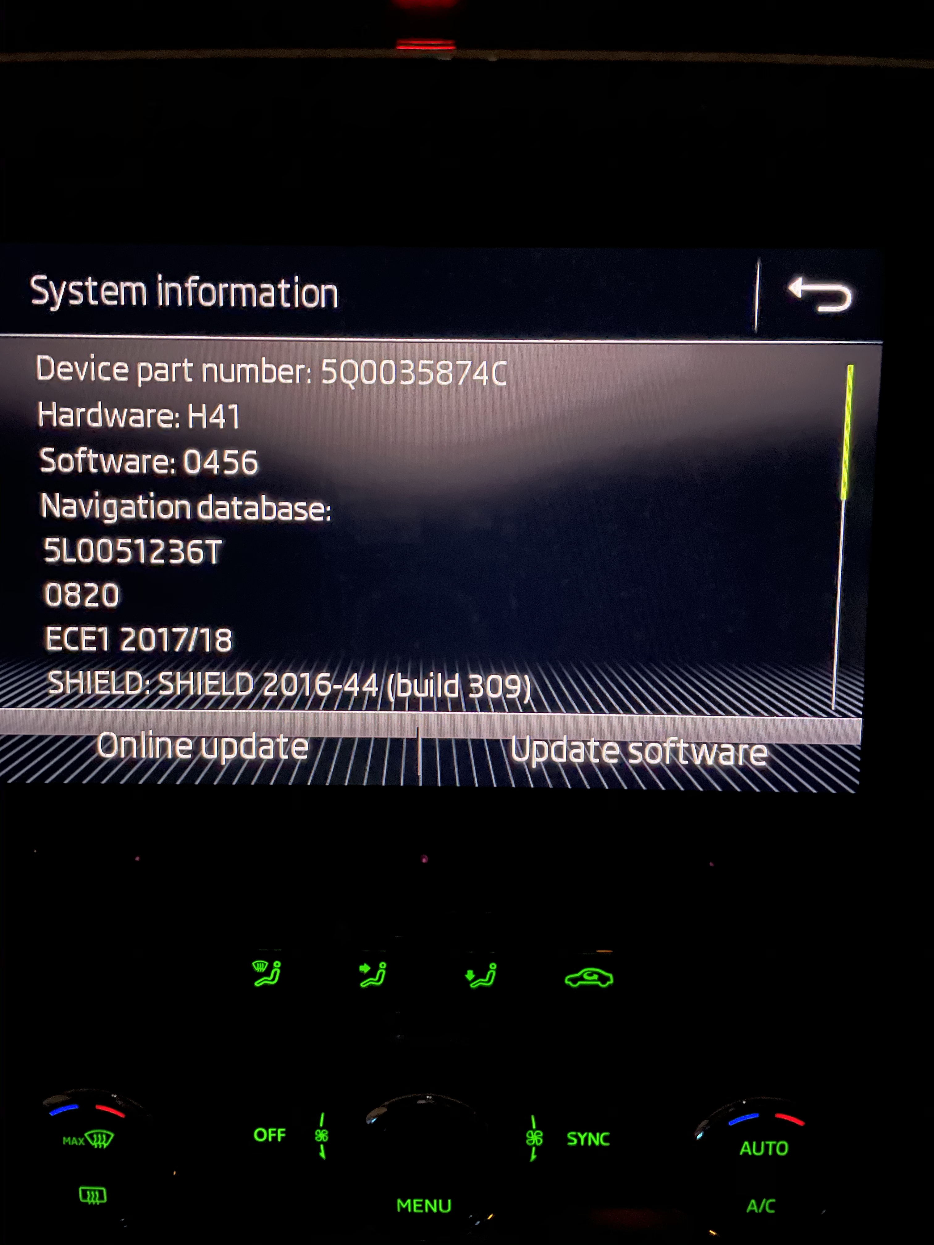

I have the Amunsden Head Unit. Version Info is
Yes - that's fairly ancient firmware.  I'll need to confirm with @pab567but I think this is an Amunsden MIB2.5 unit - with which the most recent firmware is 0478.  You also need the latest maps from http://updateportal.skoda-auto.com/
Yes going to do the maps tonight all being well. I've downloaded the 13GB Europe file, just need to copy it over to the SD card. Only had the car since last Wednesday 9th. Can I update the firmware myself. This is the new touch screen Amunsden unit with the all black facia, no physical buttons.
