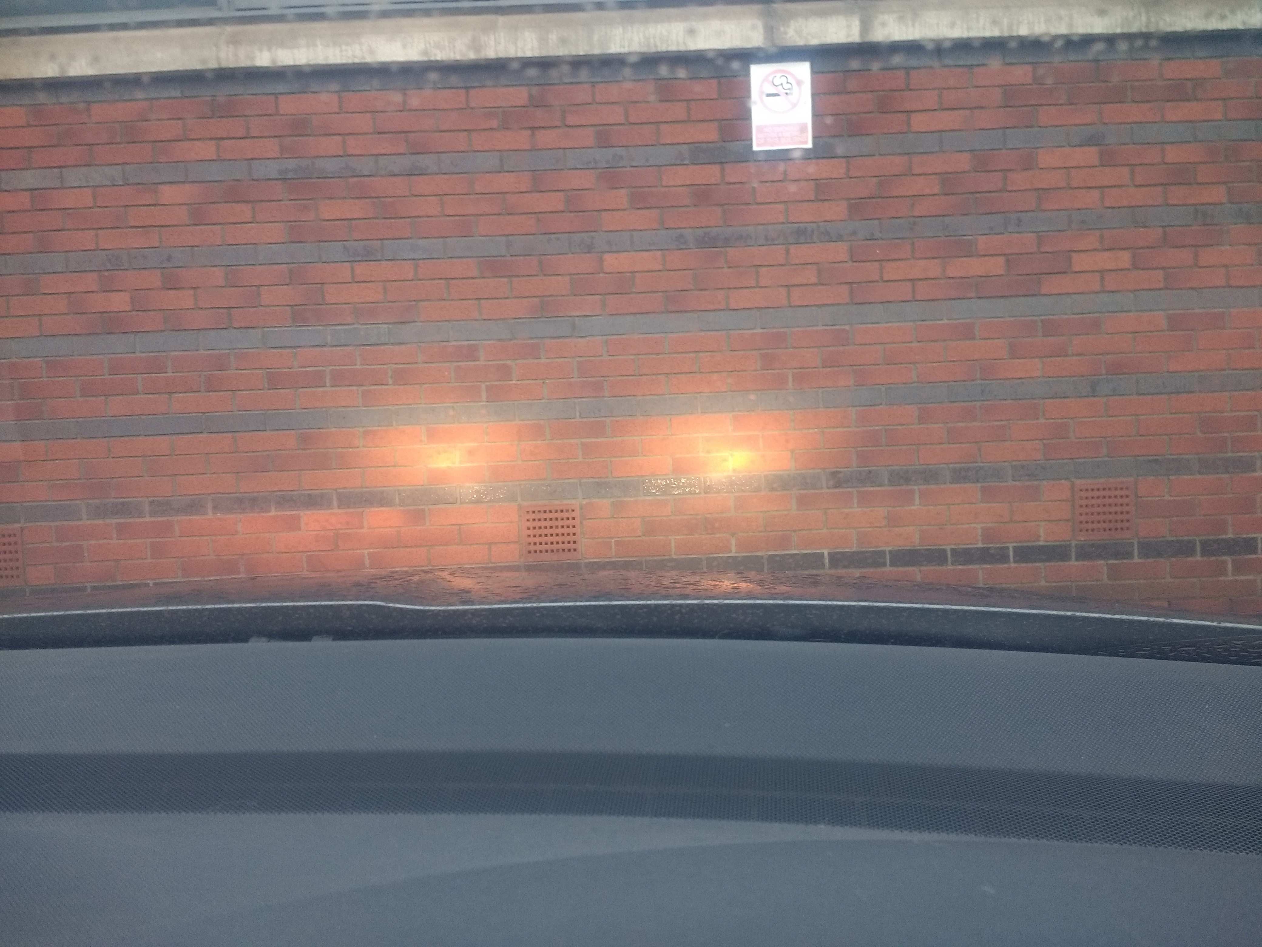

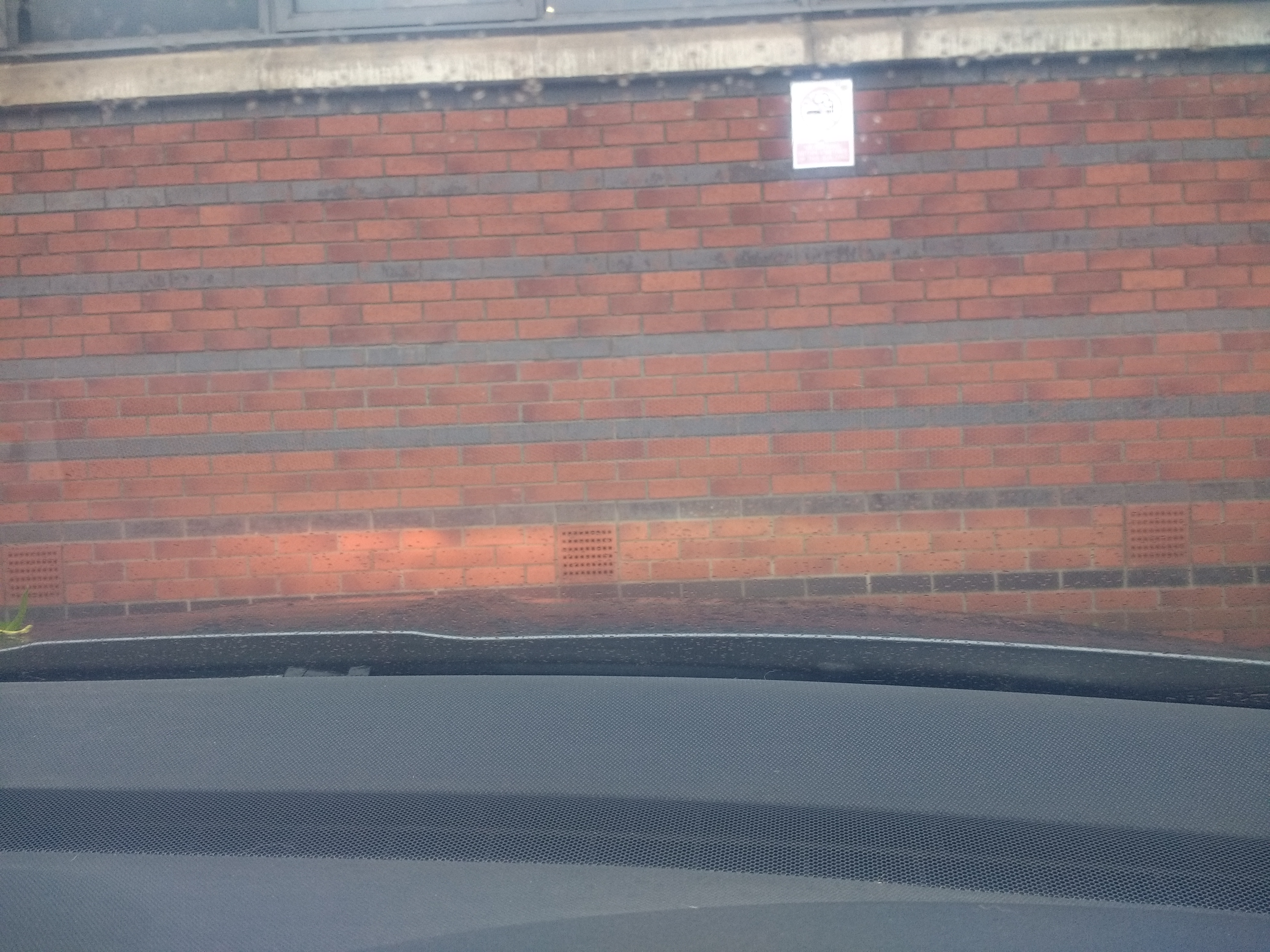

Thanks. I forgot to say, it's a pre-FL model with factory-fit Xenons and self-levelling headlights. So, it would appear, that when the garage failed the car at it's MoT for headlight beams being too low and then adjusting them, it's possible that's something has gone wrong. I only say this because main beam seems a lot higher than before. I wonder, is it just the dipped beam that self-levels or both beams?
The first picture shows just dipped beam and the second shows with main beam too. Is it me or just main beam look too high (relative to dipped which may, of course, be too low now)?
