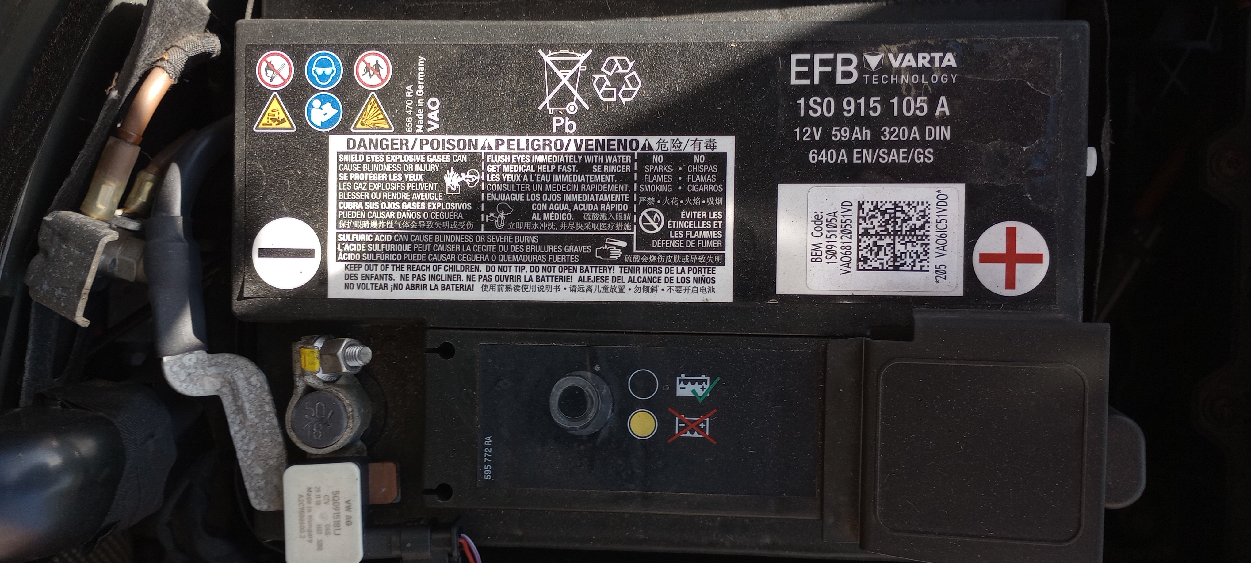

  4. Hi I've always had start/stop issues and put it down to insufficient mileage to charge up the battery. Weirdly, the start/stop works, even from cold. Anyway, could be time to replace the battery. This is what's in there. You can see that the condition indicator window is completely black indicating no issue. Earlier this evening I discovered that you need to code the battery when you replace it so I'm wondering (a) could this be the original (2019) battery or (b) could it be newer but not coded? Also, if replacement is necessary, should I replace like with like (EFB) or opt for AGM? Thanks in advance for any thoughts.
