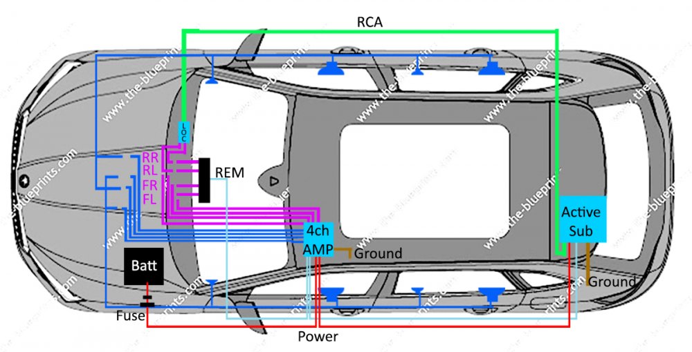

I think, it would look something like this...
I am thinking of placing the 4Ch Amp as close to the headunit as possible, under passenger seat (or in footwell up behind glove box if possible, although this may be hazardous for passengers if within striking distance of outstretched legs)  reason I want it to be clear is that I would like to keep original speaker cable in place through door jambs etc. So cut speaker cable at headunit, extend it and run it to the amp, then run it back and reconnect it to cut cable heading off to speakers.
Power from battery with fuse to the amp and then in relay to the active sub enclosure.
REM on from Head Unit Aerial Power? again in relay.
In order for the low end sound for the sub, I would need to splice into the rear speakers and run the high level through a Level Output Converter so that RCAs can then be used to the sub.  As I am not experiencing bass roll off I think LC2i is a bit overkill, especially on a budget.  So will need more research into this one, maybe one from Connect2.

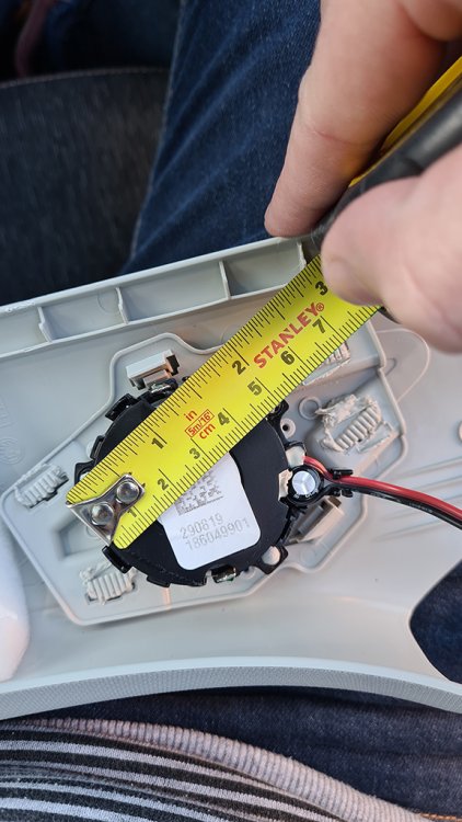

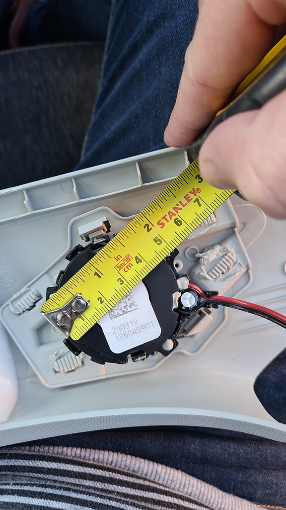

Before I sign off, I also took the A-pillars off to investigate the standard tweeters.
Anyone have any idea how to get these out?  I was able to get the black plastic back off but no further.  To me it looks like the 4 corners of the grey plastic mount are going to have to be drilled off in someway so that that plastic piece can be removed from the clips, then find an innovative way to mount new tweeters behind the A-Pillar mesh grille.  Any suggestions would be most welcome.
Oh I'm also aware that I will need the Connect2 CT25SK01  Skoda speaker adapters as well to replace the door speakers.  Don't think I need a new harness for behind the head unit though, as I am not adding or stripping out any cabling.
If anyone has any thoughts, suggestions, tips or tricks, then it would be most welcome.  Thanks and hopefully I may be able to start on this over Christmas, weather permitting,
you see those three plastic welds? you need to dremmel those off gently. if you are delicate you can leave enough material that they can be melted back on when you refit the speaker holder.

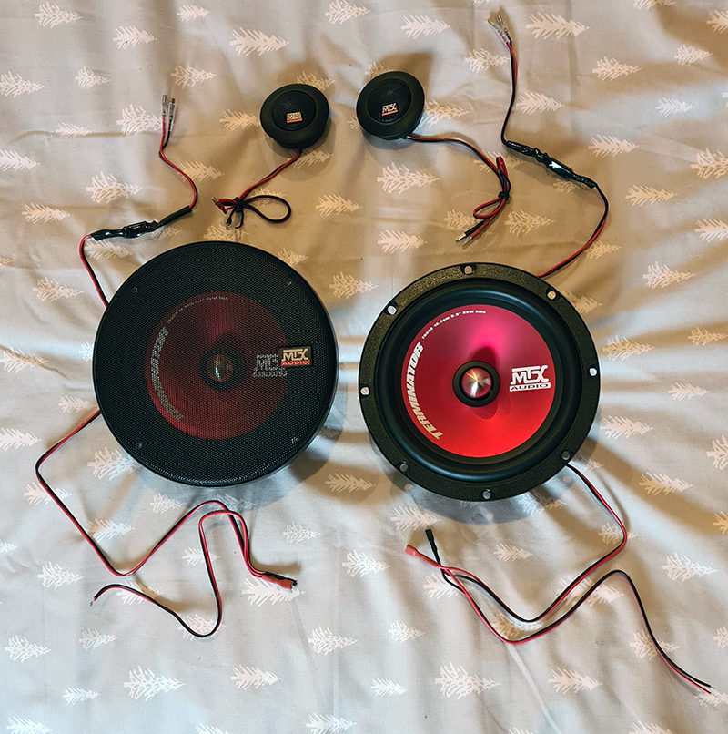

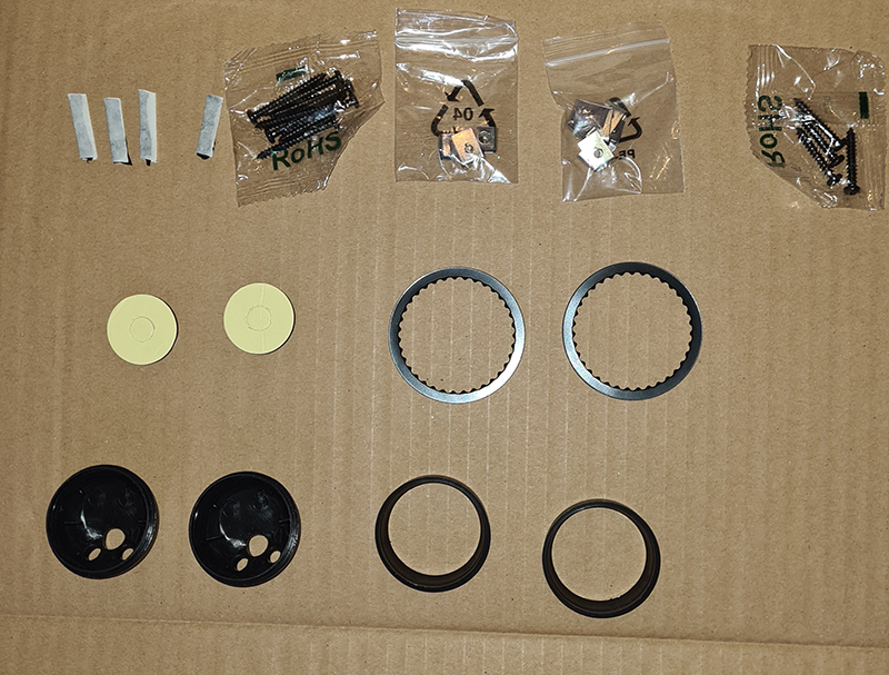

Speakers and Amp arrived this morning.
Speakers have inline capacitor to protect tweeters and product sheet mentions using with the TR450 amp with High Pass filter on (which Johnny mentioned earlier) so this way the amp wont be sending out harmful low frequencies and the capacitor will do the job of protecting the tweeters from the mid-ranges that the woofers can handle.  Will obviously have to cut these wires for the front as using stock wires in the A-Pillar for tweeter, so will need to add the capacitor in there.  But in the back where both tweeter and woofer are in door I am hoping that these cables will be able to be used as they are.
Box also comes with a good deal of attachments.
For the tweeters there is dash mounting sockets, mounting rings, and double sided adhesive rings, so good options available.
There is also 4x butyl adhesive strips.
As well as clips and screws for the woofers, although I am looking to use the riv-nut method that others have used.  These clips are sharp metal and I would be concerned that with vibrations they could scratch the metal work on the door panels.  I have seen that VAG use M3 rivets for mounting speakers, I know some up the size to M5, but these MTX aren't crazy heavy so sticking with M3 so that I don't have to drill the door panel.

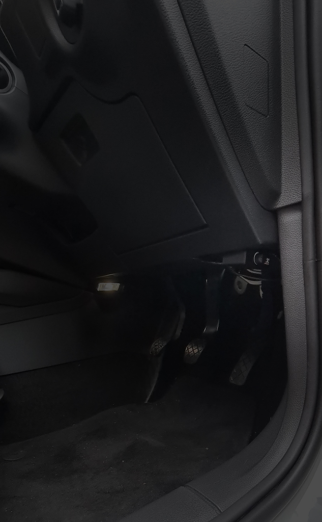

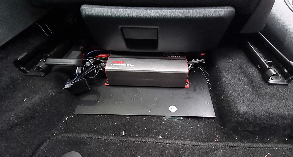

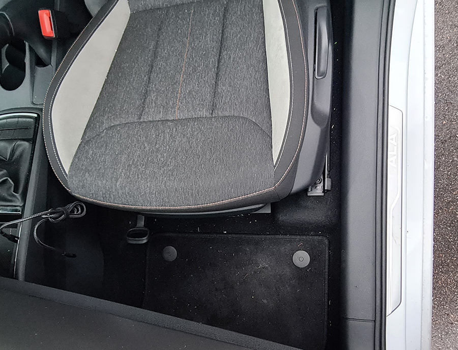

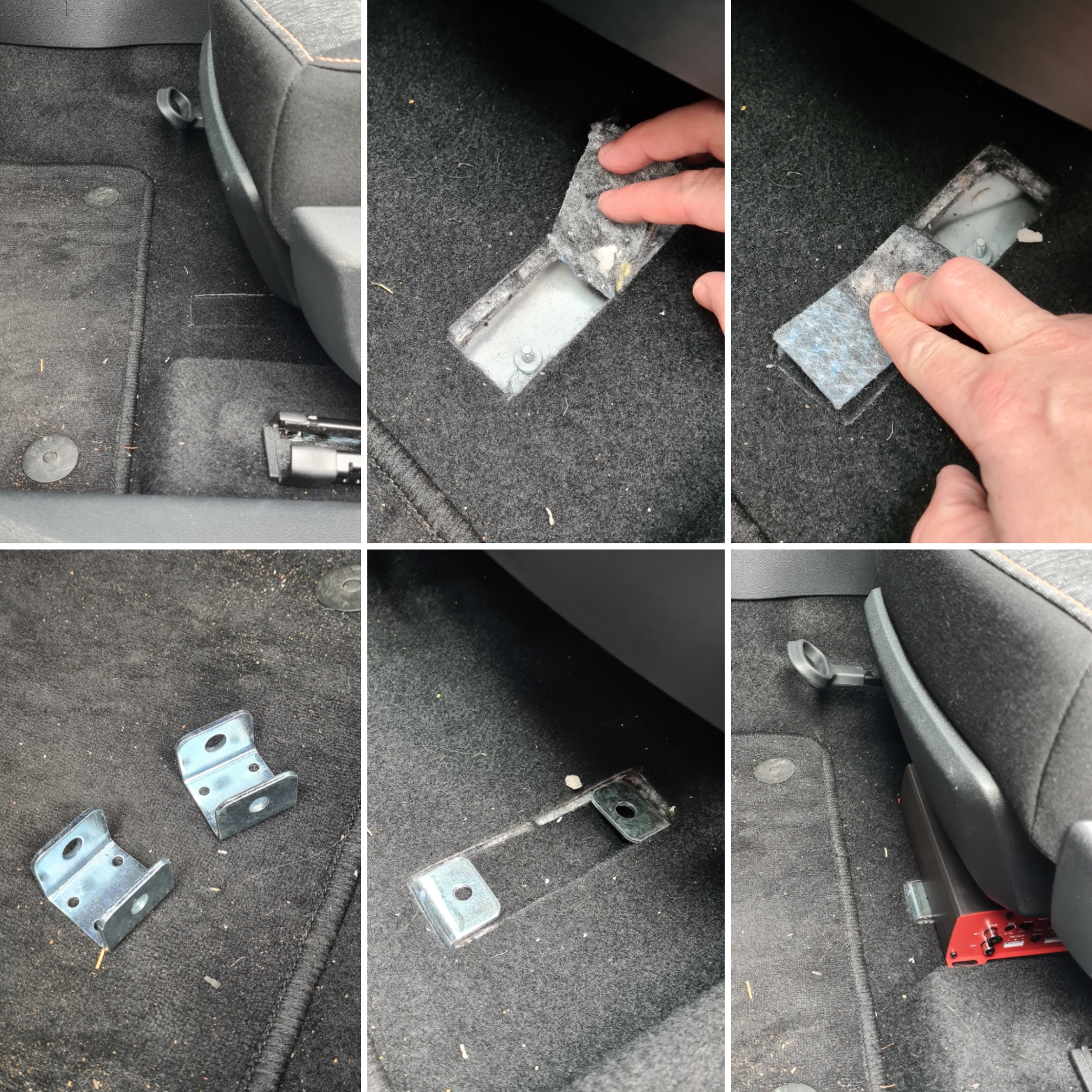

Did a bit of research before doing a detail today.

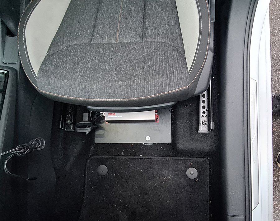

Found that under both driver and passenger seat are these cut rectangles of carpet which fold forward and backward to reveal mounting points.
A rumage around the bits and bobs draw I found some C brackets which will be perfect.
Aim is to attach these brackets to mounting points, then attach a nice sheet of ABS plastic to the brackets as a platform to mount the amp onto.
As the brackets sit flush with the carpet there is good clearance over the amp even with the chair at its lowest.
Will likely mount the amp further back than shown (pic was for clearance ref) with an area of plastic to function as almost a kick plate to protect the amp from passengers feet or rolling objects.  I dont think it should be an issue but luck favours the prepared.
Edited by Steve8O
Missed grammer

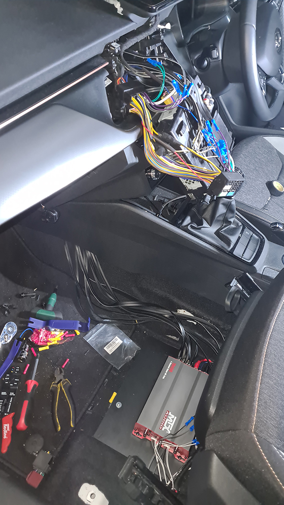

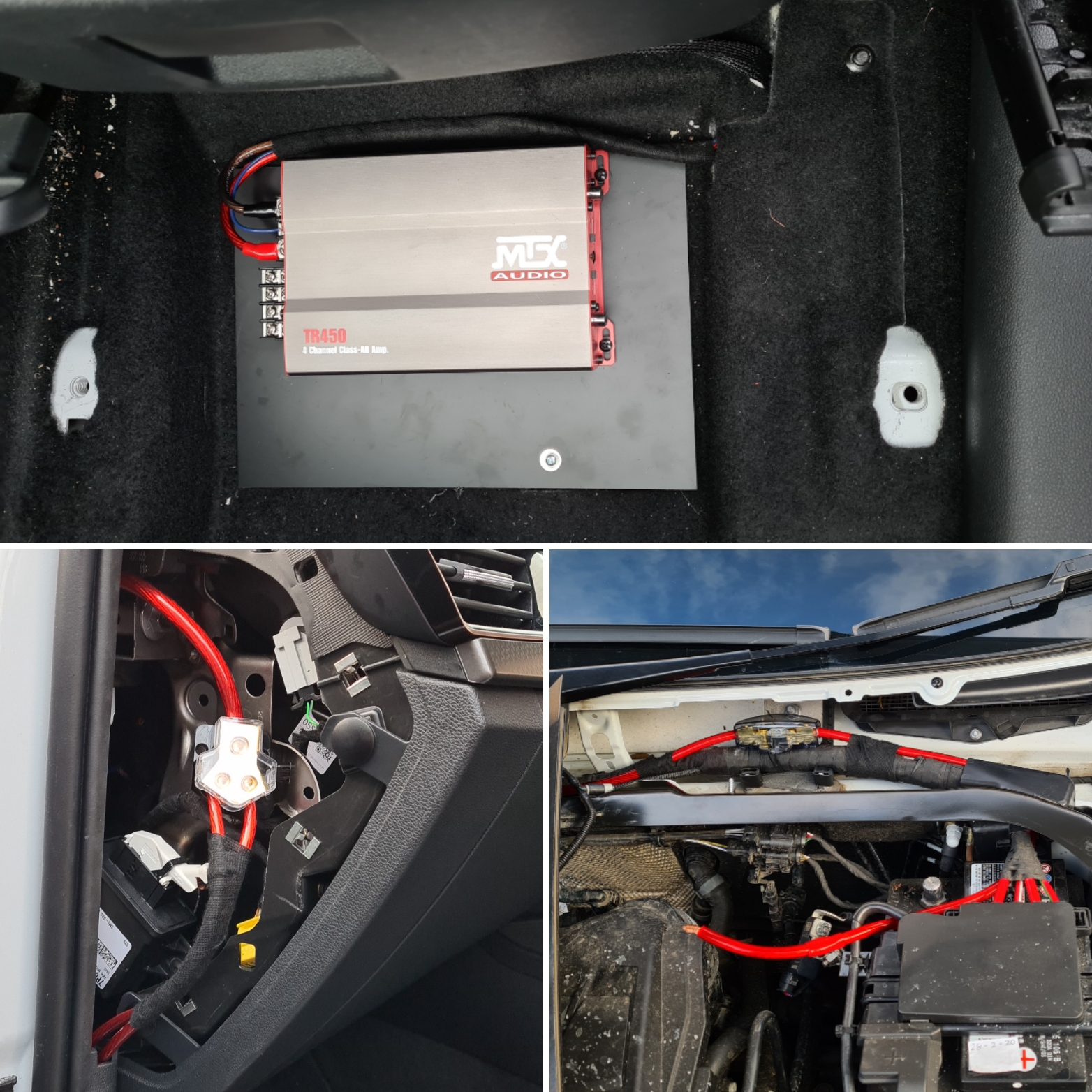

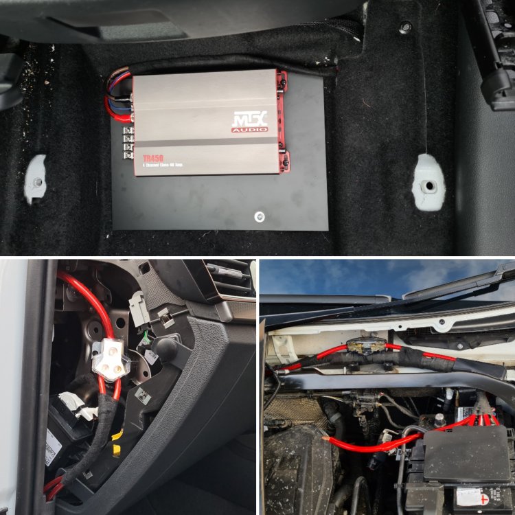

Busy busy day yesterday and today.
4 AWG kit arrived and immediately my first headache.  There is no way for power to get through the firewall on passenger side of the car.  The entire wiring loom goes neatly under the skuttle and wiper motor.  So a lot of patience and care, and I got the skuttle and wipers off, then next to where the wiring loom goes through is a nice perfect grommet. I think this would be for the bonnet release cord on LHD models.
So as the power cable had to go all the way accross the car and in behind the fuse box on drivers side, then behind stearing column, up behind head unit and glove box, the 5m length runs out before it gets to the passenger footwell. Used lots of 5mm closed cell foam and cloth tape to ensure this new cable doesn't rattle or vibrate on anything behind the dash.
Made the decision to put the power block behind glove box.  Terminate the 4 AWG cable into it and then buy a new 8 AWG cable that I could cut and run from power block to amp under passenger seat and sub in boot.
So this is where I am, AMP mounted under seat, Sub in boot, all 12v power cables, REM cables and ground cables in and tidy.
Next I will splice into speaker cables to get sound to sub, then running speaker cables to and from amp, to test the system with the stock speakers before I start switching out the components in the doors.

This is the amp fully wired in situ with the passenger chair pushed as far back as possible.
And this is it with the passenger side chair in its regular position in line with drivers chair.

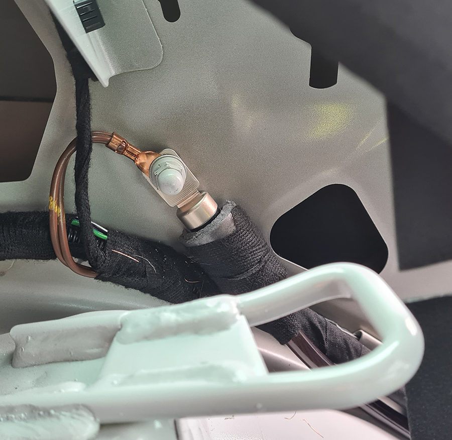

Speaker buzz, read online lots of posts about this being a ground loop.  I had originally ground the amp under the passenger seat and the active sub in the boot, so I bought another power block and a high quality earth terminal.  I now ground on passenger side above the rear wheel, with 4 AWG then split at the power block and run a 8AWG to the active sub and an 8AWG to the amp.  This is much neater.
This is my ground, using an existing location as the factory for something else.  You can see I have wrapped this solid nickel terminal in foam and cloth tape as it is right up against the panel and I don't want any vibration.
Buzzing is still occurring with lights on, poop.  So this could be that I am sharing this ground location with whatever that factory ground is.  Or maybe that the high level input speaker connectors that came with the amp also have a ground and they are creating a loop.  Frustrating but options to try and fix.

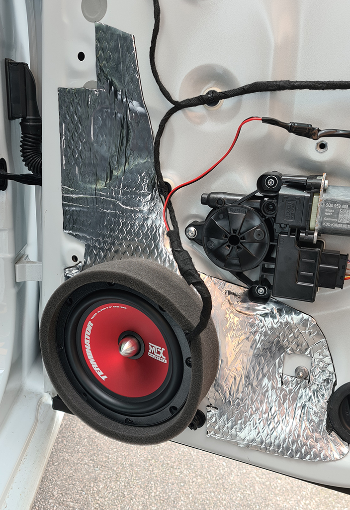

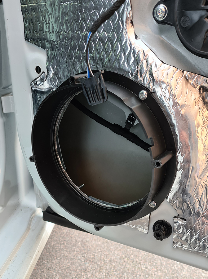

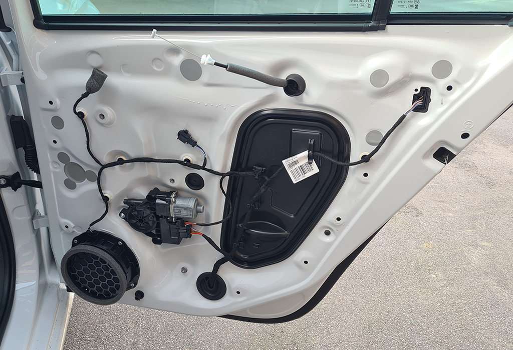

Started with the rears, and followed pretty much the same procedure that is well documented on youtube and elsewhere.
Use trim panel tools to get the door off, use forked tool to really get in behind each clip.  As this car is less than a year old they were really really stiff but the tool did work, you do need to use force, but in a measured capacity, for instance don't go yanking anything but do get the tool in the right position and give it a good measured pull.

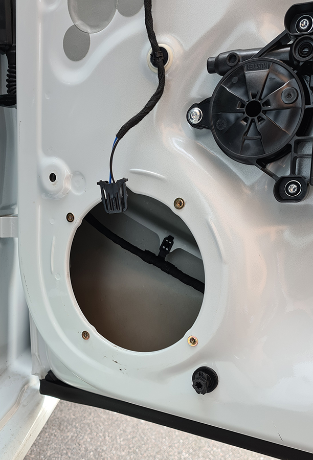

Drill out the rivets for the stock speakers.
Use a riv nut tool to put in M4 rivet nuts.

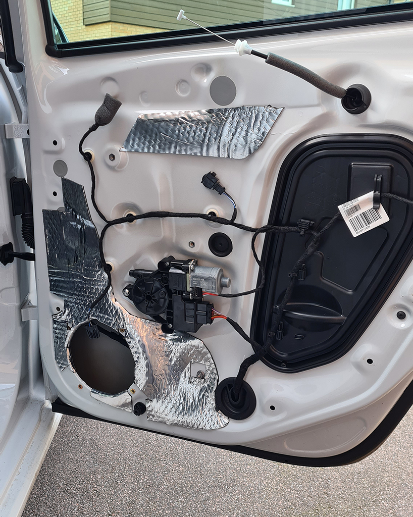

Sound deadening added to flat panels of the door.  I didn't want to go overkill with this stuff.  So added it to the large flat surface around the speaker housing, on the flat panel inside the hole on the exterior of the door below the actuator, then did the knock test on other areas.  Just use a knuckle to gently knock the panel, you can tell by the sound if it needs deadening or not.  A good rule of thumb is flat areas are more likely to vibrate,  bent mental as largely quite stiff and solid.  The difference in the sound of the door closing with even just this little amount of deadening is incredible.
Next on was the connects2 6.5 speaker adapter.
Then I got some of those fast rings that @JohnnyType2 used.  They are awesome!  A solid disc gets stuck to exterior panel, 1 ring gets cut and stuck to the back of the speaker so as you mount it to the adapter there is a layer of foam between the plastic and the speaker, and the magnet nicely rests in to the foam disc.  Then the largest ring goes around the speaker so that when the trim panel goes back it presses up against the plastic, fully directing the sound out the through the grille.  Lovely, must buy product!
looks good, nice tidy job. The fast rings definitely make a difference especially with higher quality speakers.
Yeah, if anything they are good for just pushing up against the interior trim panel to help vibration, but considering their low cost they are just brilliant.

I am going to take the glove box back out again and play with the mounting of the distribution block, currently its getting a bit of vibration when the sound is cracked up.  So I will foam up some areas back there.
As I was rewiring the amp I re-did the mount too, just to give it a more custom and finished look.
https://photos.app.goo.gl/jn4eBYDAeAMhHL629
All holes in carpet, were factory cut.  I didn't have to take a knife to anything so was really pleased about that.  I used a M4 rivnut into the C bracket to really hold the mount board down.  And used M3 rivnuts on the board with 3mm rubber spacers to mount the amp, so that it has airflow beneath it, avoiding risk of it getting hot on the ABS board.
Sound is now great in my opinion!  All levels set on LC7i, amp has about 10% gain on front speakers and about 20% on rears, sub needed no gain at all.  Amp is set to high pass for fronts and rears, and the system does a pretty good job at delivering a full bodied set up.  I think if I was being really critical, the high end treble is the strongest element now, then the base and then the midrange.  A more powerful sub would of course be better, and a higher end set of components with a full x-over system would really deliver.  I don't regret my choice on any elements though, it is a million times better than the stock setup and I really enjoy listening to my music through it.
