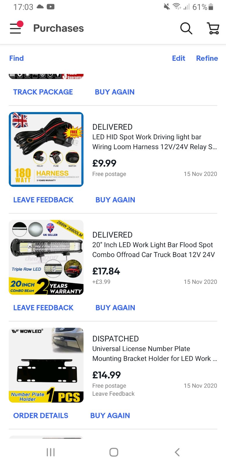

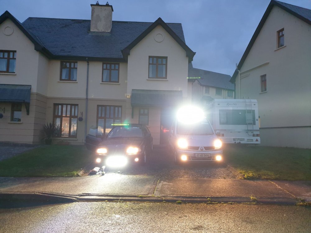

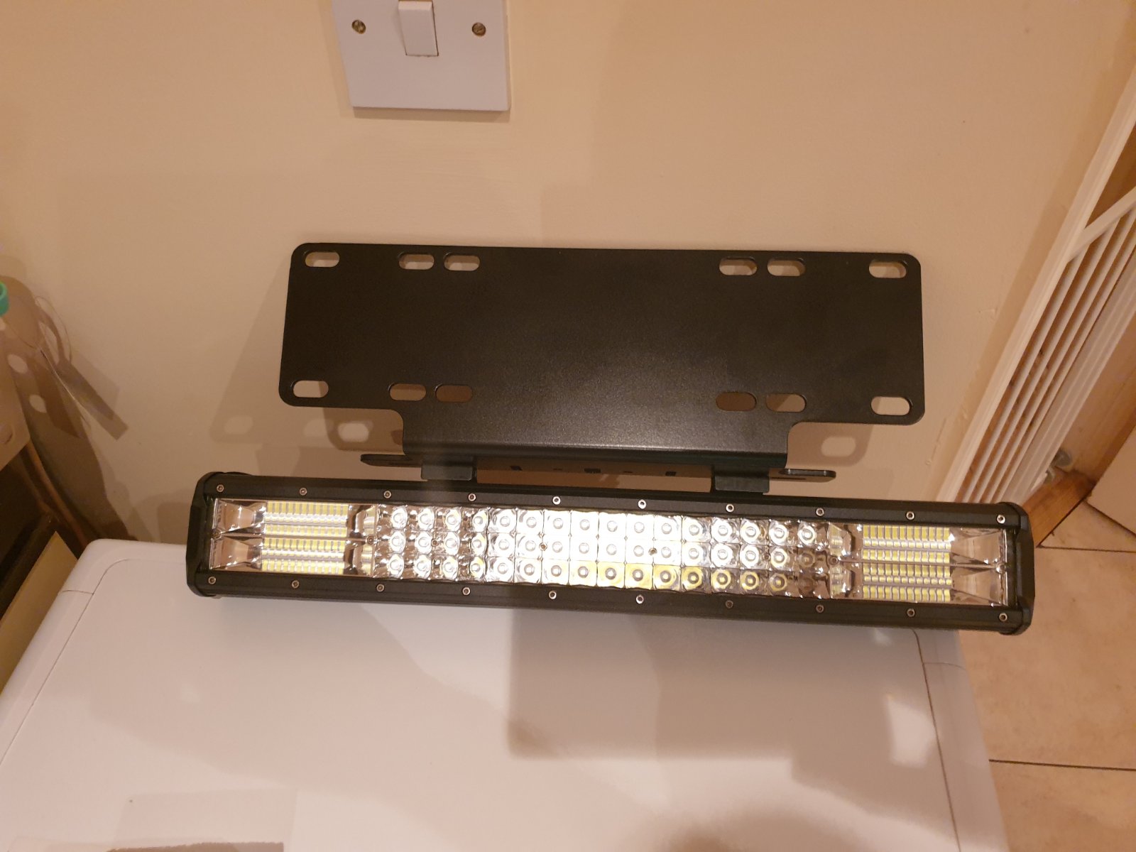

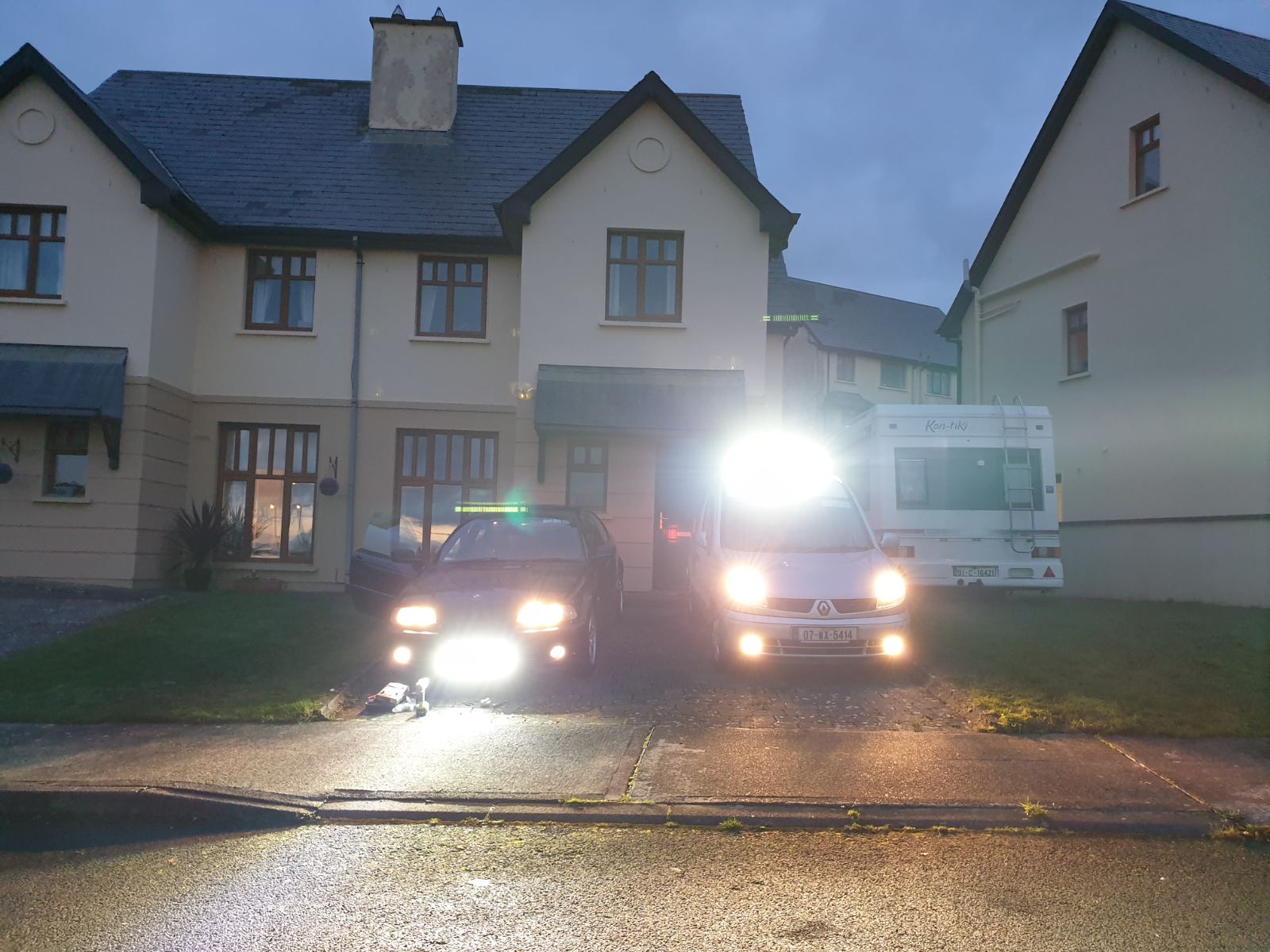

Maybe something like this could work for you? Got the bits from ebay for about £50 (light bar, mount & wiring harness with storage switch). I had it on my old car and it was a massive improvement. BMW on the left, Kangoo on the right has an even longer bar attached to roof bar.

I can't edit my post and see i have a typo. What i meant to say was that the wiring harness came with its own separate switch, so could be totally independent of the cars wiring system only needing a power source and ground connection. Over here I don't believe it would be an NCT fail so I cut out the switch and got a trigger from the high beam circuit for ease of use.
