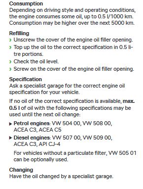

Page 16 of user manual:
And under the engine section:
Edited by Guest
As above.  And when an official VW group video on North America on checking oil says Quart, it needs remembered a US quart is not the same as and Imperial one.  As US gallons are less than Imperial gallons.     @SurreyJohn where did you come up with that bit about any multi grade oil.  That is so back a few decades and nonsense.

Your engine has VW508 00 oil in from the factory.   Topping up with a different spec like VW 504 00 so 5w 30 FS III which is a long life out is OK if needs must.
But
Your car / engine is nearly new and at least 7 months away from an oil change if you have it on Fixed Servicing.
(Your never said how many miles you car has done.)
Really is is advised to use the Recommended Oil for your car until it gets an oil and filter change.  that is 0w 20 FS IV.  / VW508 00
This was showing from Skoda rom the early launch of the 1.5TSI's.
