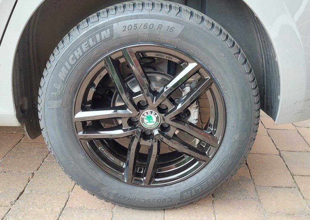

I did that (16 inch with Cross Climate 2 tyres) as soon as I acquired my Kamiq SEL in April this year. Didn’t run it long enough on original 18 inch wheels to make any proper comparison but what I have got feels excellent re noise and comfort. I chose alloys similar pattern to original. Will be interested to hear your comparison.
I have noticed a big improvement in tyre noise and comfort with 32 psi pressures all round. I've dropped them to 32 psi this morning to try for a few weeks. I chose black alloys as i hoped they wouldn't need cleaning as often as the Braga alloys.

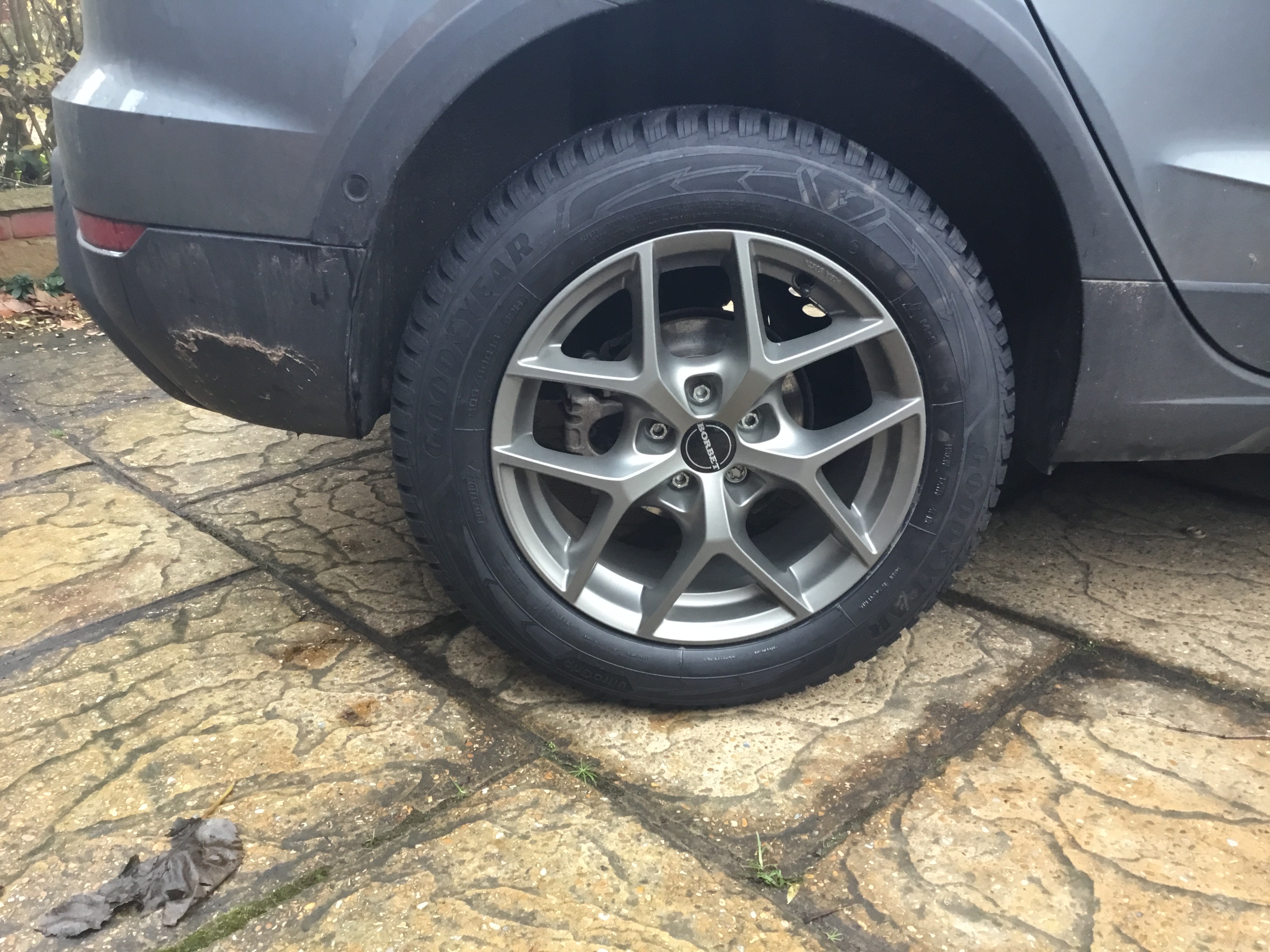

Photo of my Arona with 16 inch wheels on (rims are Borbet Y which fit perfectly with same bolts, no adaptors).   Second photo is for comparison to 18 inch summer tyres
