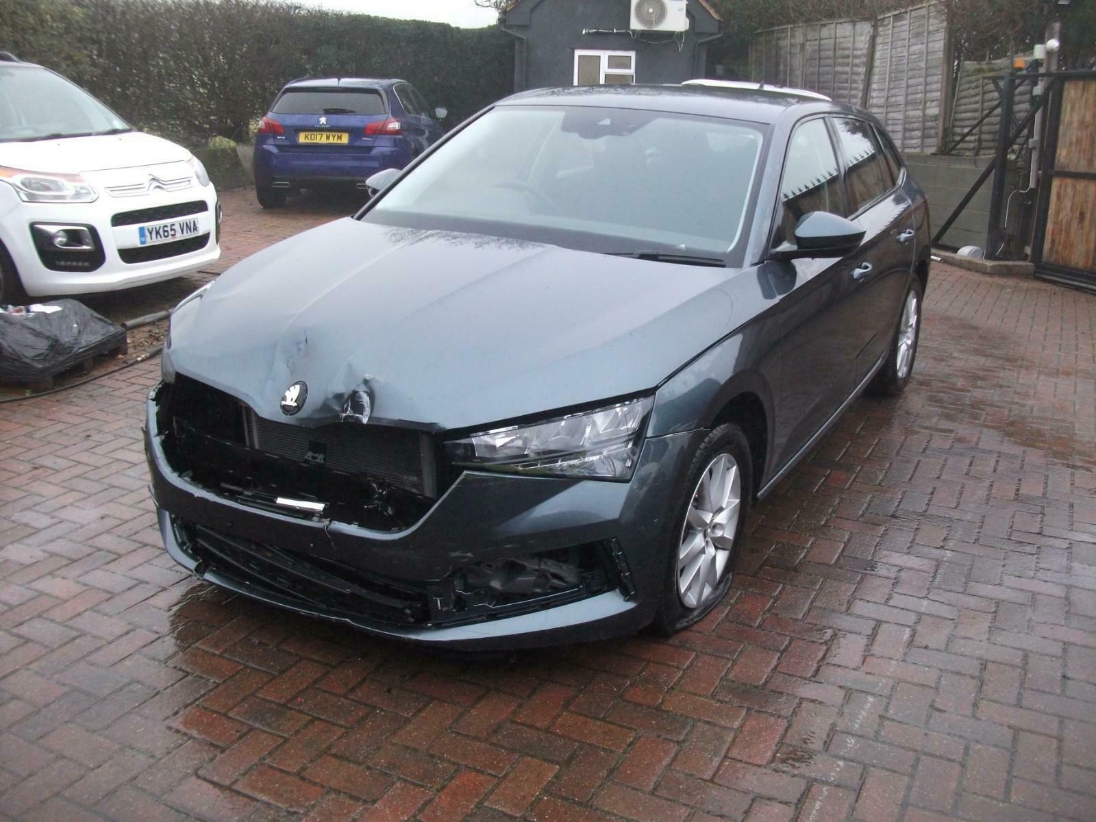

Thanks so much - the one I'm thinking about is here. From the research I've done so far, I can find:
- front bumper with grille and assembly - £500
- Headlights - £500 or so (albeit the lights look OK; am pretty sure the light housings/casings need replacing
- radiator/cooling kit - won't know how much needs replacing, I guess without getting the car to a garage
The obvious components I'm struggling to find / put estimates on are:
- front right wing panel
- bonnet
As you both say, the key challenge seems to be knowing how much more damage there is under the bonnet, and in turn, the cost of labour at a decent garage who are happy to work with second-hand parts.
My goal, for this to be worth it, is a low-mileage Scala with an auto gearbox (and 114bhp or 150bhp) for £10k. Might be unrealistic but that's what I'm aiming for.

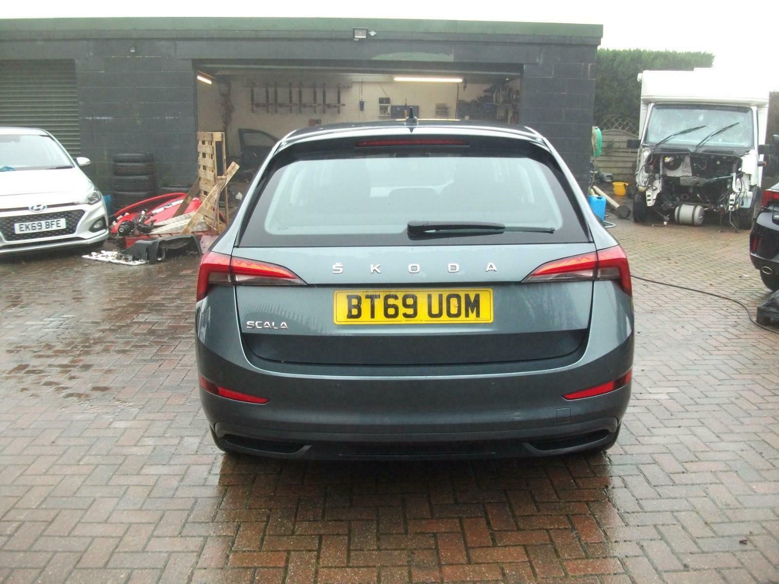

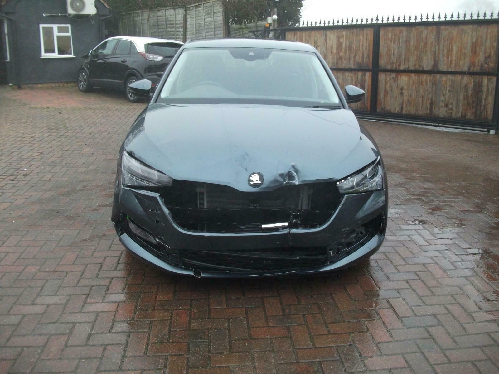

https://www.ebay.co.uk/itm/2019-Skoda-SCALA-SE-1-0-TSI-S-A-114BHP-5DR-SALVAGE-DAMAGED-REPAIRABLE-DRIVES/324451336976?ssPageName=STRK%3AMEBIDX%3AIT&_trksid=p2060353.m1438.l2649

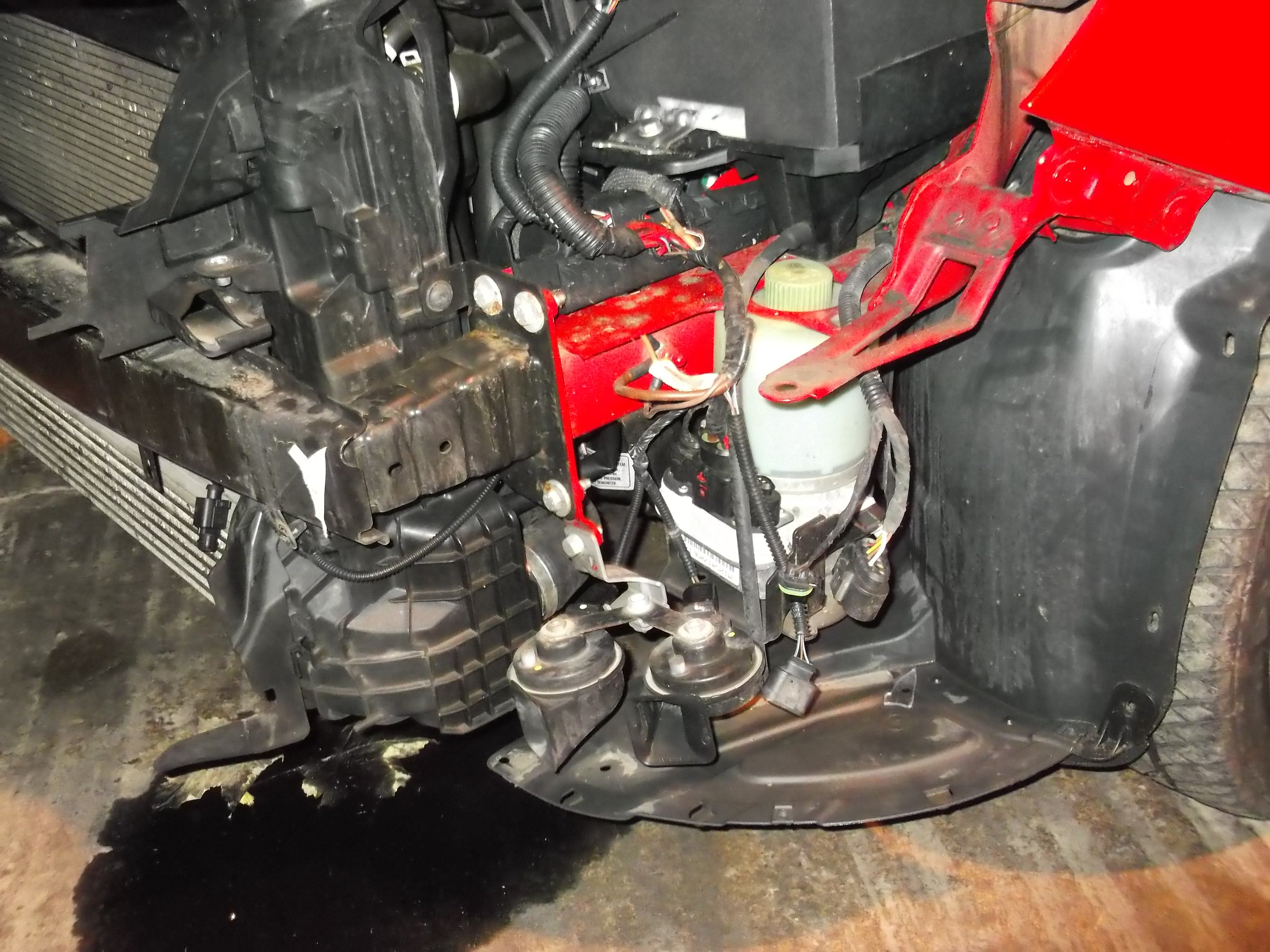

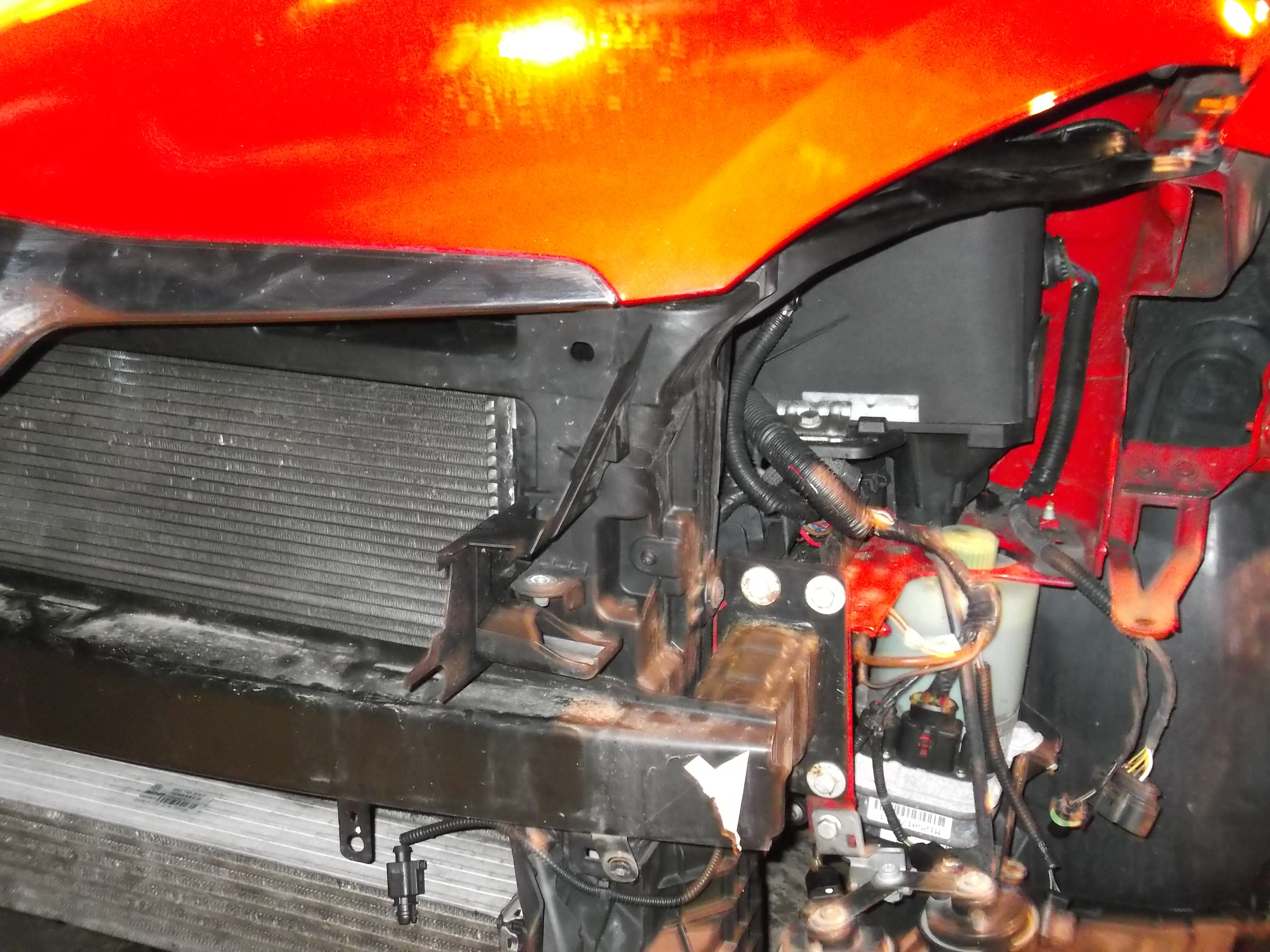

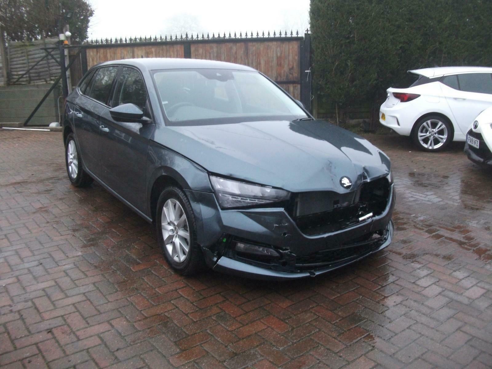

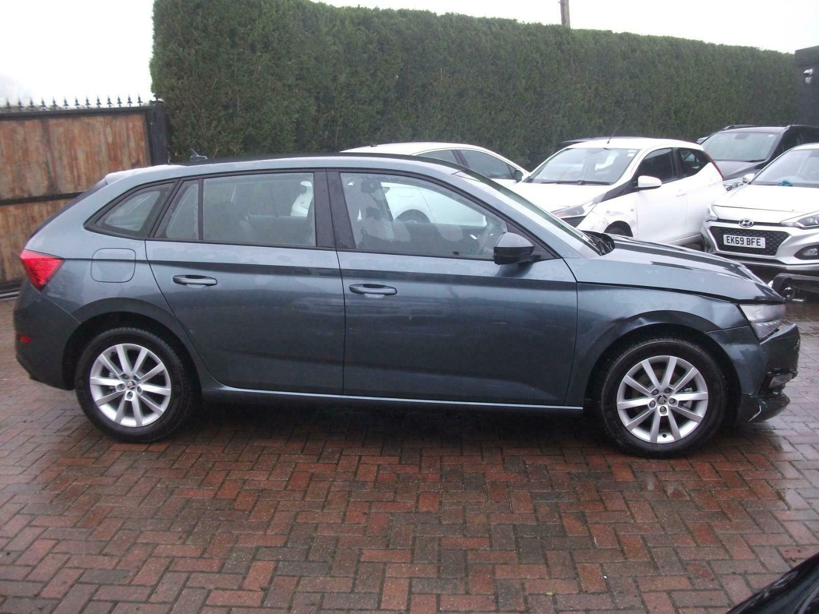

@olliejordan It looks like the car is already at a place where they have decided that the repair ios going to be uneconomic for them to do the work.
Looking at what damage is visible and making a guess i reckon the quotes where between £4,500 -£5,000 on a Skoda Approved Repair.
That could have been more. Loan car is in the cost etc.
If you wait until after March you might find more used Scala coming back to dealerships and prices being asked and for them and availability being greater than it is now.  No idea what asking prices might be though.
Have you driven one to be sure that a Scala 1.0 TSI / DSG is really what you want?
Edited by e-Roottoot
What would it be worth in undamaged condition?
The category S marker is going to hammer its repaired value.

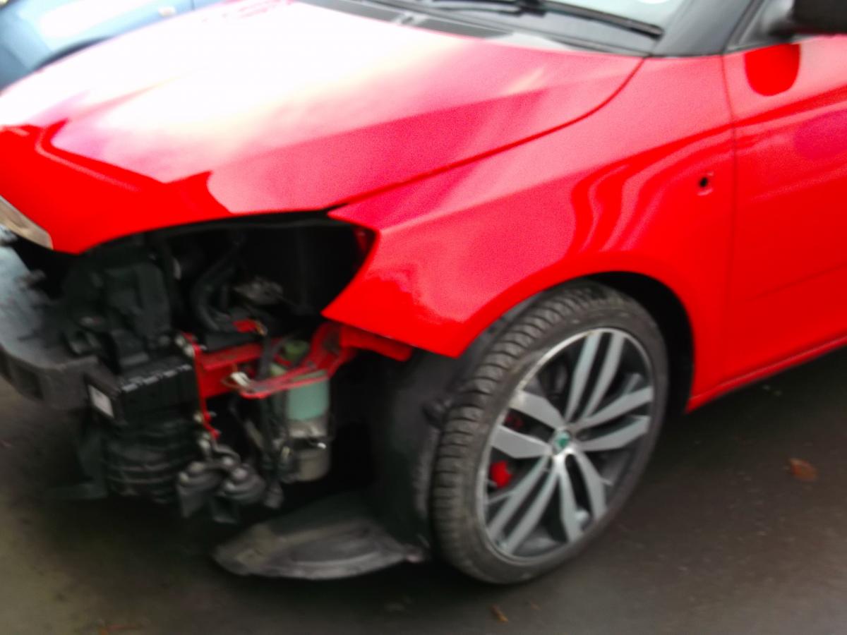

Aircon condesnor holding pressure is a good sign the radiators behind it will be OK, it will just be a bumper beam replacement or straighten it on a press, the one for my Yeti straightened but one crumple zone was slightly deformed and the alignment of the wings, bumper, headlights etc are all reliant on it, for £60 it was better to replace it.
Headlight mounting lugs can be repaired by plastic welding, I repaired & retained mine as spares.
There will be a couple of bits of plastic cooling ducting damaged, probably the bonnet catch.
Its very repairable but if you are paying someone to do it then forget all about it.
It looks like one for someone in the trade or a DIY'er that has previous experience and the tools to do the work or with mates rates from those that have.
Considering its young age & low mileage it looks like a good deal and is certainly an easy & relatively cheap repair if DIY'd and the bonnet, wing & bumper were sprayed for cash in a low bake booth.
It makes what I paid for my Yeti seem expensive although it was less than half that, more airbag/dashboard damage, less bodywork but in fact the newness is the achilles heel unless you sell it on straight away, any notional profit would soon be wiped out in depreciation.
