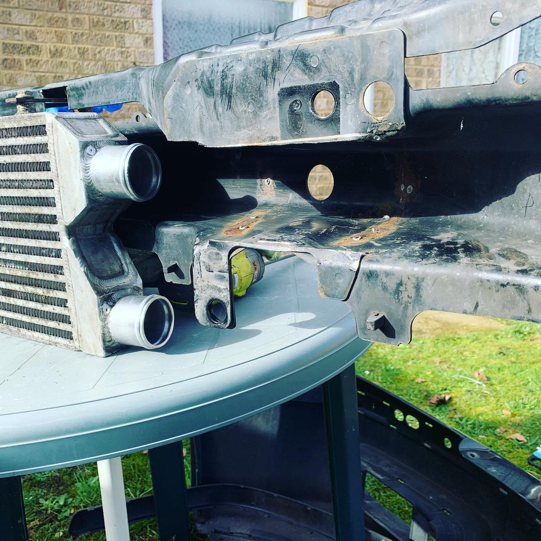

I have a THS setup. A very small amount of modification to the slam panel, I didn't want to hack it up as it's obviously quite important.
Small cut here to allow the top pipe to sit in
98434607_1163015450704374_8627375616142367098_n.thumb.jpg.729bfbadc81187e6486091b366ff7ac1.jpg

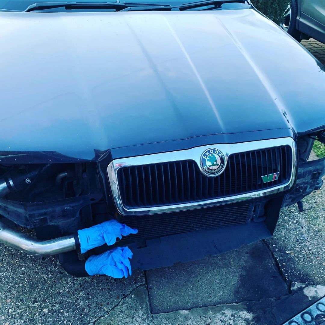

You'll see how it all sits here
97328381_111242837262746_3495854069564289632_n.thumb.jpg.5d486648226a703028694e2b98ce654d.jpg
Thanks, that's actually a big help I'll have a look into those as it looks like you've got it in there quite nicely!
