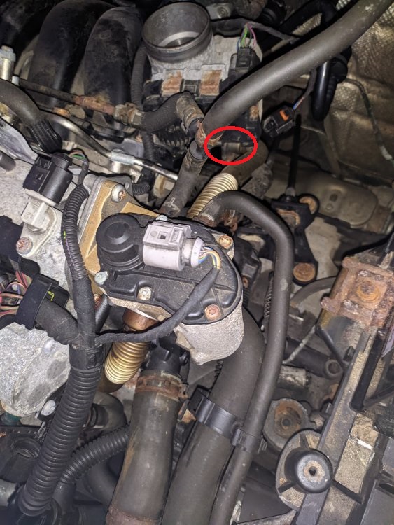

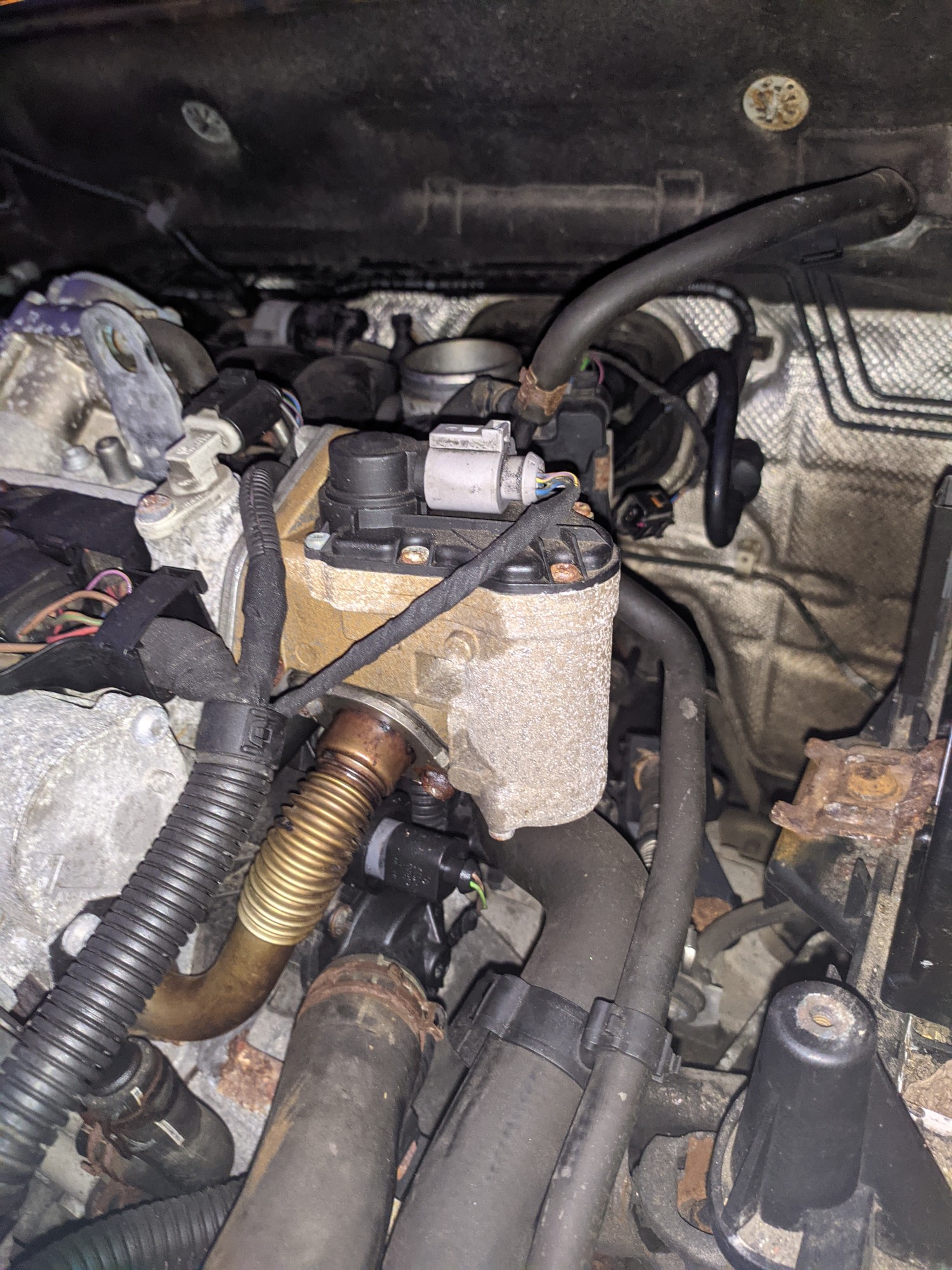

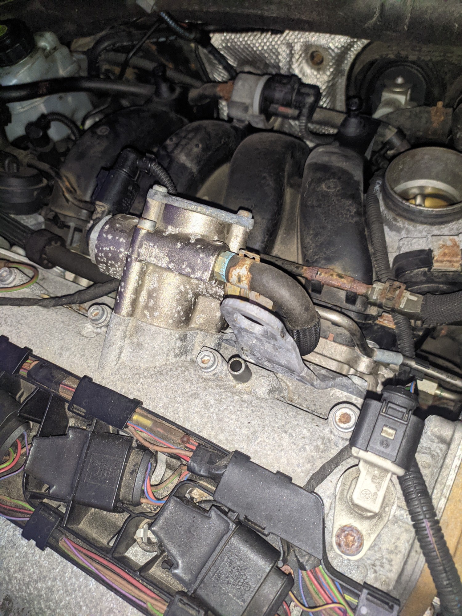

This is what I thought was the EGR but I also see a component on top of the inlet manifold which could be it. So the first 2 pics are what I initially thought and the 3rd pic the other possibility though both may be wrong. It was dark and I only spent a few minutes looking.

Those first two pics do look like an EGR, but not a type I'm familiar with.
  • Sponsor
The fitting at the inlet manifold, where the EGR output flow joins the airflow coming down from the throttle body, would still be the area I think you are most likely to find blockage.
Ringed in red here:
