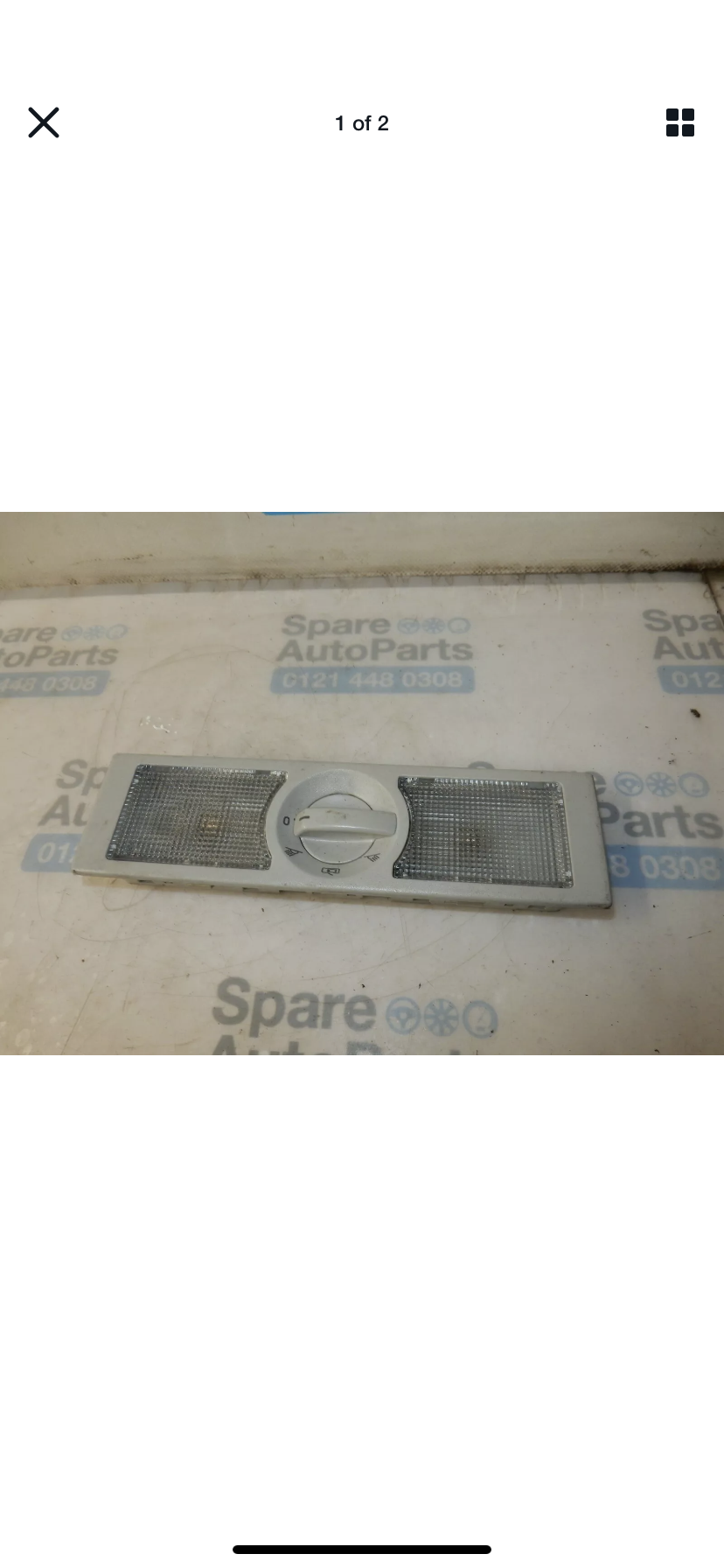

Hi. I have purchased a polo rear interior light to fit to my Fabia.
The plug connection has 3 pins on it, but we can't figure out the combination of the wires to get it to act in the same way.
Anyone done it successfully?
what light from what year of Polo ? piccy ?
2012
Ok, so that means.......
PIN 1 is connected to earth / ground. Brown wire
PIN 2 is connectecd to the same colour from / spliced of the front interior light (this is most likely a switched earth controlled by the onboard supply unit)..................... Brown with Black trace wire
PIN 3 is the positive / supply connection from the onboard control unit, probably "easiest" to splice from the front light as well. ............Red with black trace wire

edit to my previous post
PIN 2 would be connected to Brown with Yellow trace on the Fabia
