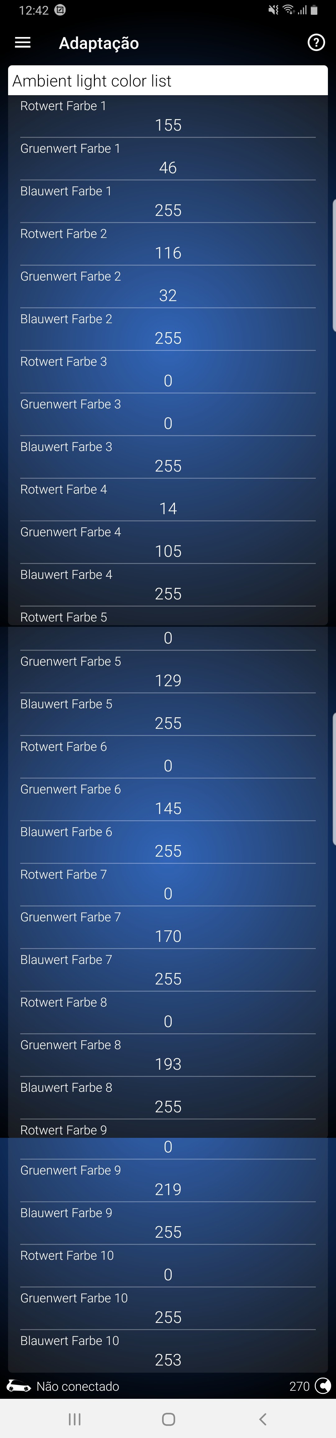

Can some one be kind enough to share the original color codes of ambient light. The 30 color and 10 color version.
Some colors i have tested are a diferent, door vs Virtual cockpit
Thank you

Thanks, i was wasking this too because some colors dont match, colors are diferent from Aid/mib vs doors and dash.
Can you post an adaption map from 09?

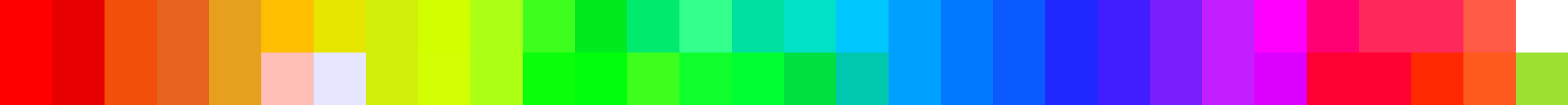

When I was looking, I found a few alternative colour pallets for 30 colours. I'm not 100% on the original sources but I think the below is accurate.
From VCP:
From a Q3:
From a Passat:
From dron420 on drive2:
I think like most things, you just been to pick colours that suit you :)

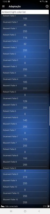

Hello here it is.

The attached file might help people choose color as it also helps in sorting them.
The colors in it are used in vag cars from OEM.
