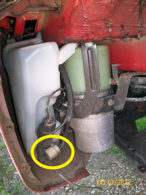

1. The pipe connection at the pump under the wheel arch....

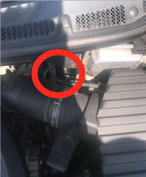

2. One at the bulkhead near the abs unit....

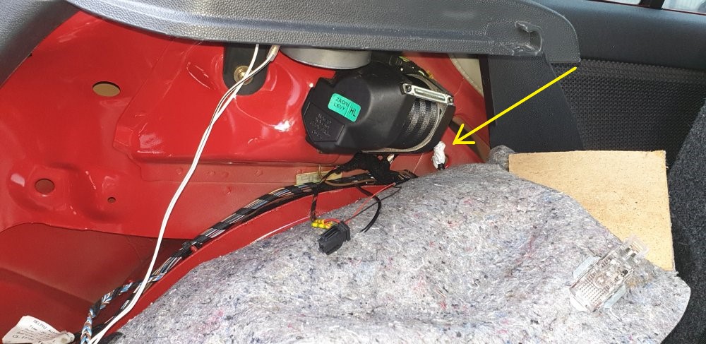

3. One behind the passenger side rear side trim near the rear seatbelt reel....

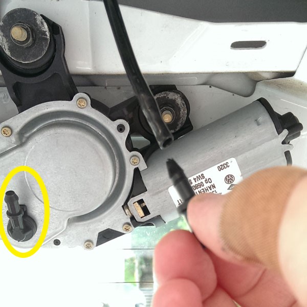

4. Finally, inside the tailgate at the wiper motor....

The bulkhead one is a favourite to come apart so maybe check that one first.
