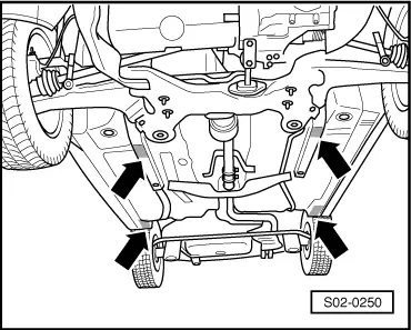

Best place for trolley jack
Just wondering where the places places are to put a trolley jack to raise the front and rear

https://workshop-manuals.com/skoda/octavia-mk1/images/octavia-mk1-3545.png

RE the front placement - make sure the jack is towards the front of those rails - they are not sufficiently strong further back.
I sometimes put the jack on the subframe bolt (with a rubber hockey puck).
Under the front main sub-frame is usually a good place. To the outer edge not the middle. I assume your not trying to lift both wheels off the ground at the same time.
At the rear, the main suspension beam or hub is usually a good place.
But I simply use the standard jacking points when I swap winter wheels. Trolley jack with piece of wood. Bingo.
