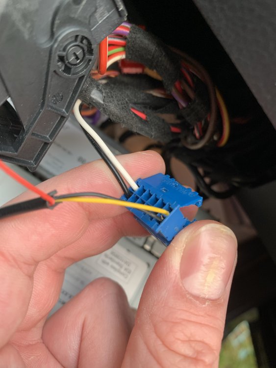

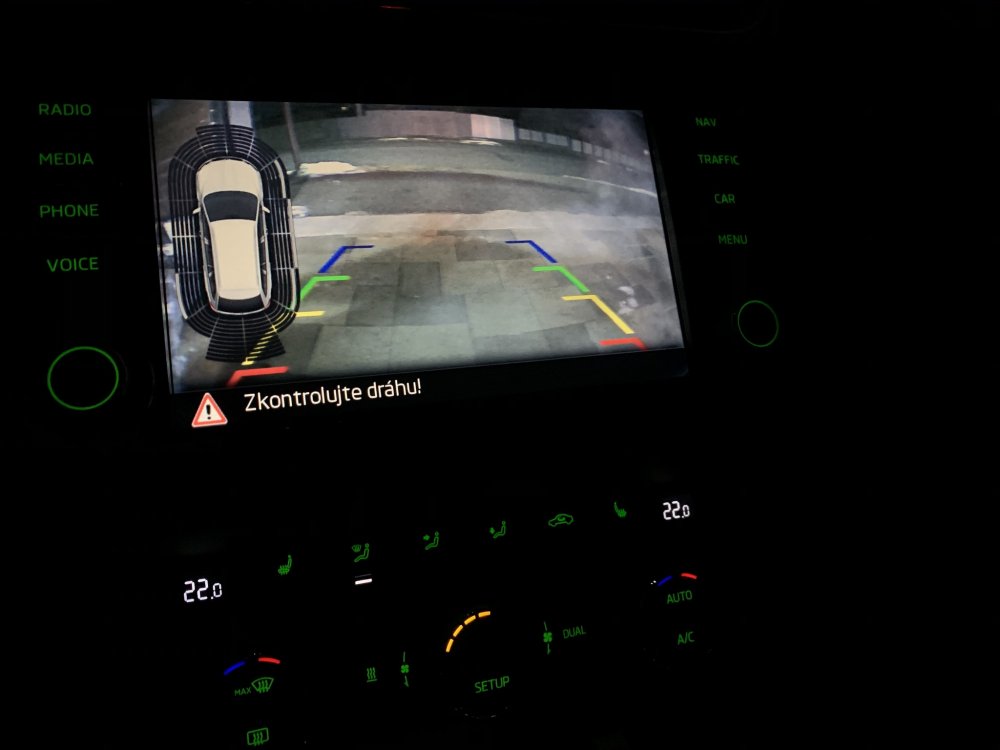

Hi Rabah, the last one is my post at the Czech forum. The picture was provided by the seller. However, I followed the YouTube video guide in combination with the guide forwarded from another forum member.
I have estate, so the video may slightly differ. My camera is lined to the rear wiper connection and video cable is routed through the right side of the car to the infotainment's blue 12 pin connector - pins 6 and 12 (I don't remember which one is ground, but if you have mic connected, it's at the same side like the black wire of mic connection)
