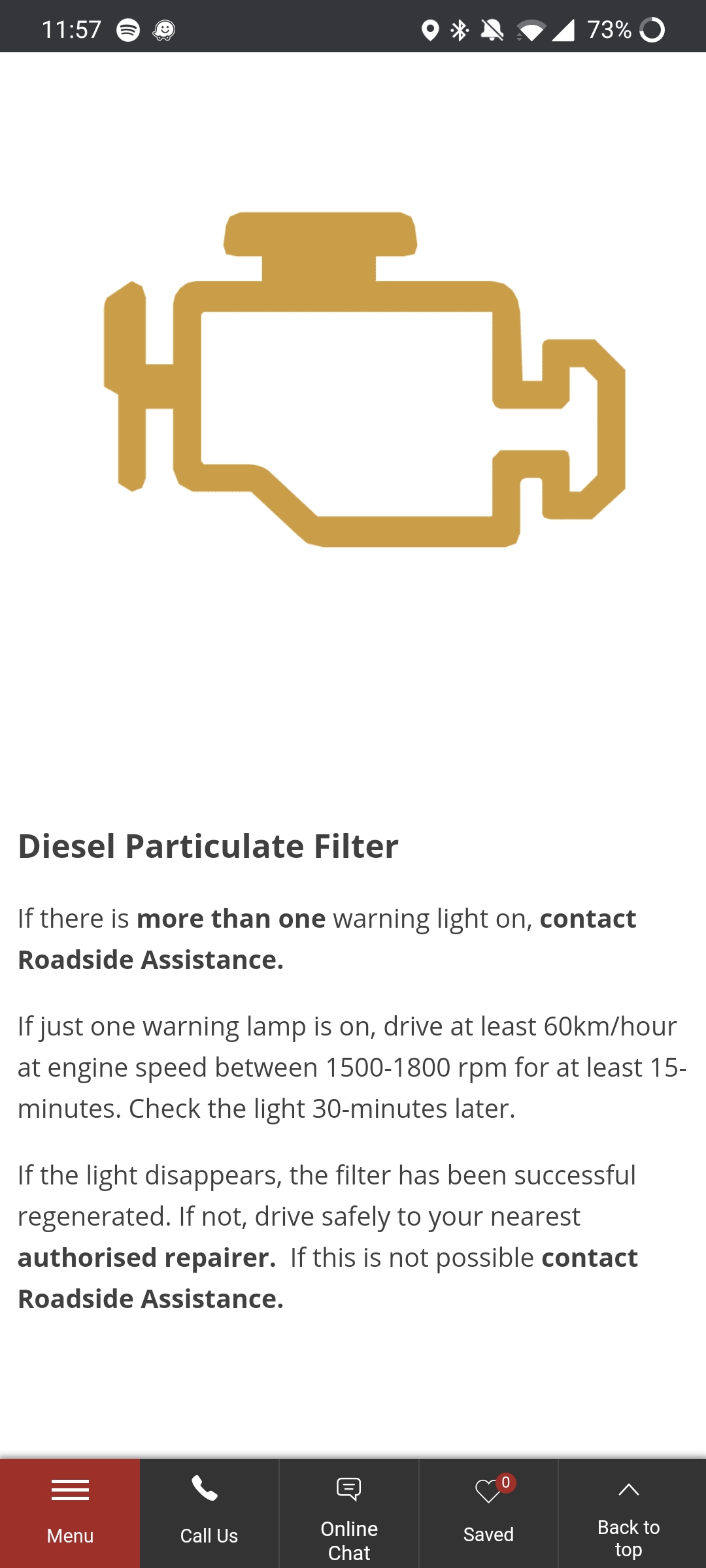

Out of nowhere, a warning light popped up on my dash, it's funny because i passed the inspection until 2023 like a couple days ago. Googled the problem, seems like it might be related to emissions. I've also read it can disappear after driving 60km/h for 15 minutes. Anyone had experiences with this warning light? Should i be worried?
https://ibb.co/ftsLSbH
I think that is the check engine light, so it could be dpf related, but you will only know by having the fault codes read.

I think it might be because I haven't been driving a lot lately, all i do is to work and school both once or twice a week
Probably something blocked like a filter or EGR valve.
Have had it several times since lockdown . I make the excuse to have a run at 50mph on nearest motorway and it clears after 20m.

Yes I have has it twice. Its the Emissions Control Light. Both times it was a glow plug so a simple repair. Needs the fault codes reading for you to know what is causing yours.

Trouble with that is they charge £60 for putting it on at Skoda dealer.
