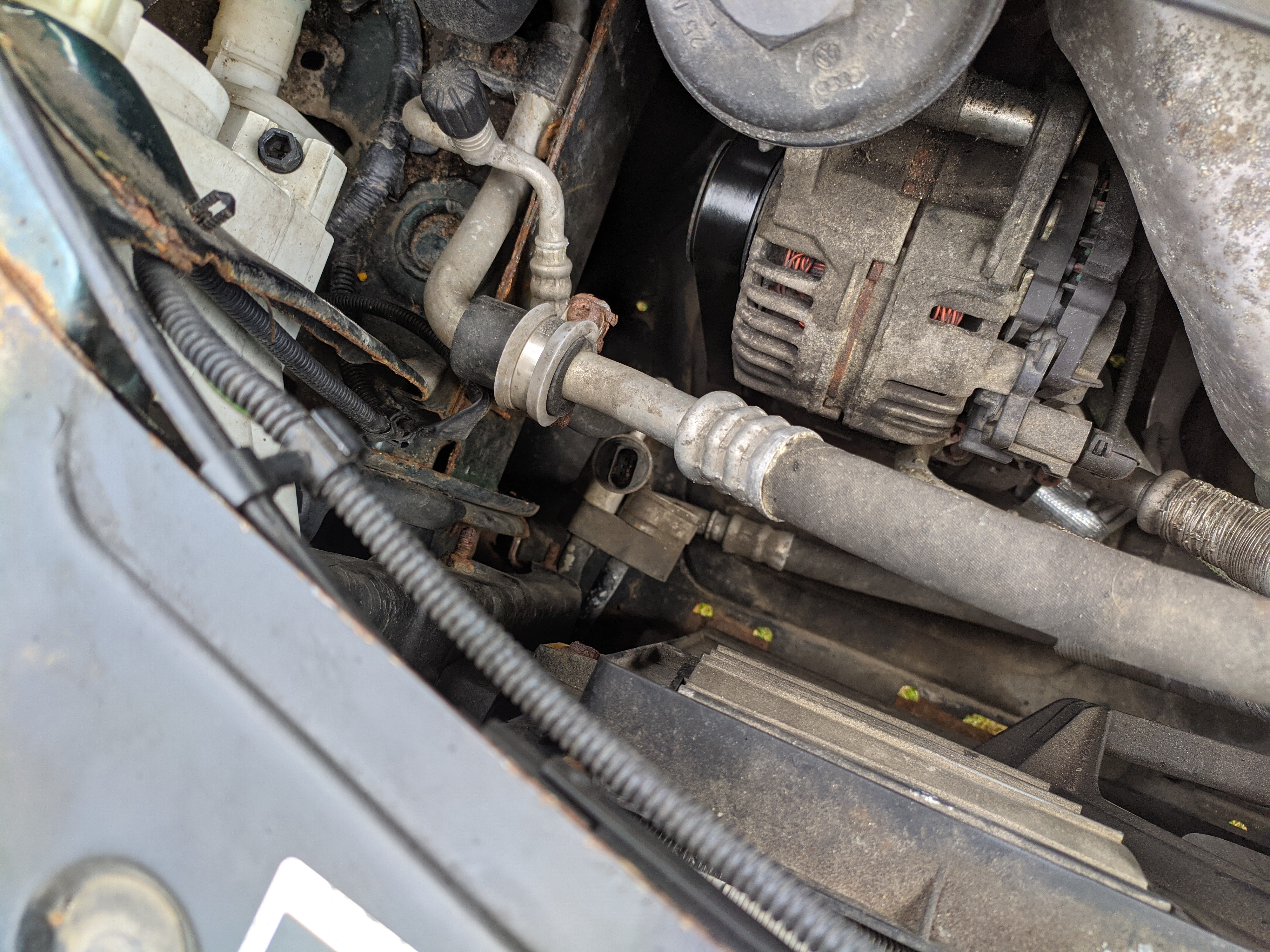

What is this unused connector?
İ think it's attached to the AC pipe front lower left in engine bay, there's no connector attached to it.
1 hour ago, Wino said:
G65 pressure sensor; item 18 here: refrigerant circuit; a/c condenser - Octavia(OCT) [EUROPA 2006 year] (7zap.com), I think.
Presumably your A/C isn't currently working?
Correct, not working. I assumed it was just needing regarded but maybe not.
So it's unclear if anything actually plugs into this pressure sensor?

I can't say offhand where the wiring goes but will have a look at mine when the rain stops.
I'm fairly confident my G65 is mounted on the condenser rather than where yours and the diagram depict, a variation also mentioned in the bottom paragraph.
Sharing your vehicle's details may help.

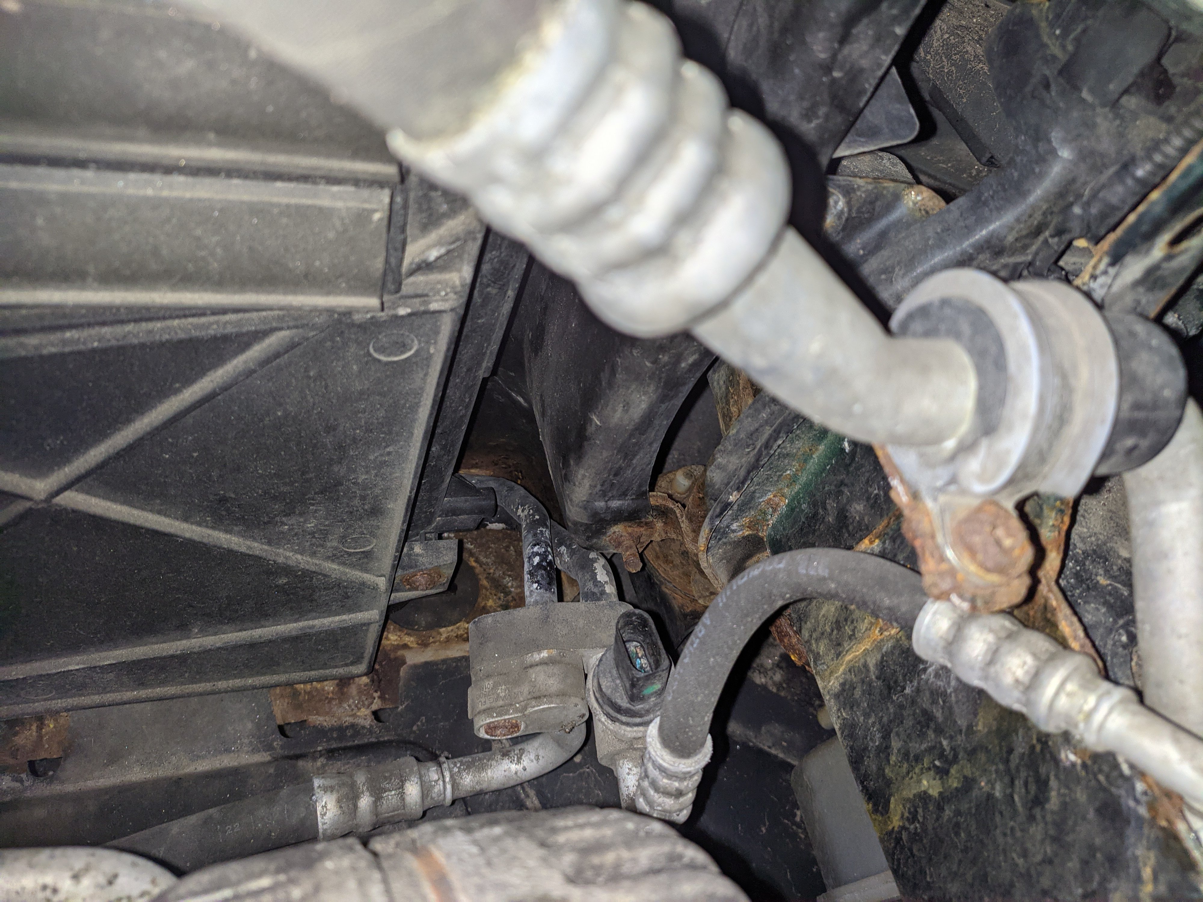

Could you take another photo from further away? It's not very clear to me exactly where that is in the bay.
8 hours ago, Wino said:
I'm pretty sure that the system requires a connected G65 sensor in order to operate.
It could be that someone has bodged in some pipework (including that sensor) from a different car, and that your working/connected G65 sensor is elsewhere. Trace round all the engine bay refrigerant pipework looking for another.
Another pic.
This is the connector but it seems previous owner has removed this wiring loom.

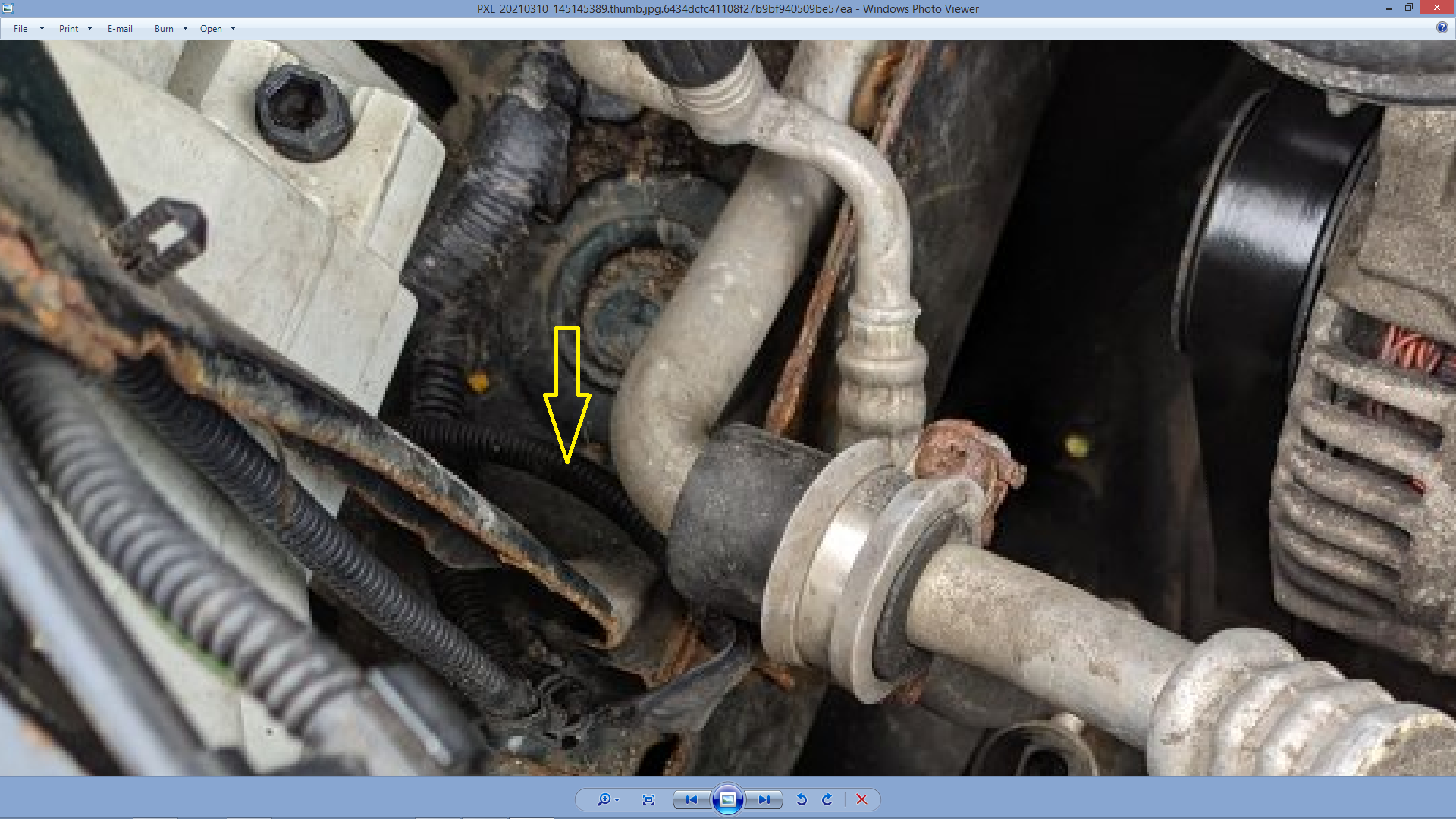

Not a clue.  The wiring must be there, close to the sensor. unwrap some loom near the sensor and look for those colour wires, all quite thin ones.
  • Sponsor
What's this bit of cable trunking going to?
I found it including connector it was indeed buried under that pile of cables you referenced, impossible to see until you moved the cables back. Thanks again.
