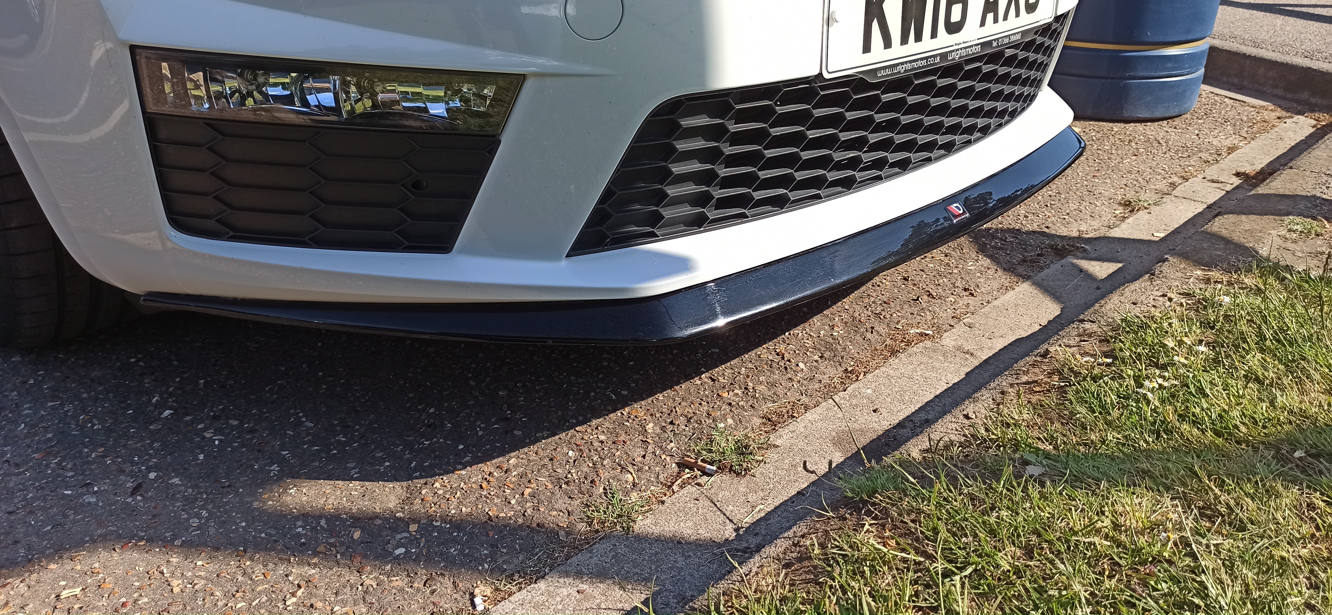

I have a Maxton front Splitter on my 2016 Vrs. I fitted it myself but it would be easier with two people, I used various props and low tack masking tape to hold it in place. I didnt use the bolts supplied as they advise removing the front bumper. Used push in expanding button trim fixings, a couple of self tapping screws with prefixed washers and some Evostik Sticks like clear, which is the best grab adhesive. Wouldn't trust double sided tape.
How much ground clearance did you lose, if any?
Very little as there are other bits of the underbody and wheel arch trim that sit lower. Makes the front of the car look like ought to have been in the first place. Its OK with standard kerbs although I did get out and check it the first time. Still get ribbed by the wife about not catching my shiny bit of plastic.

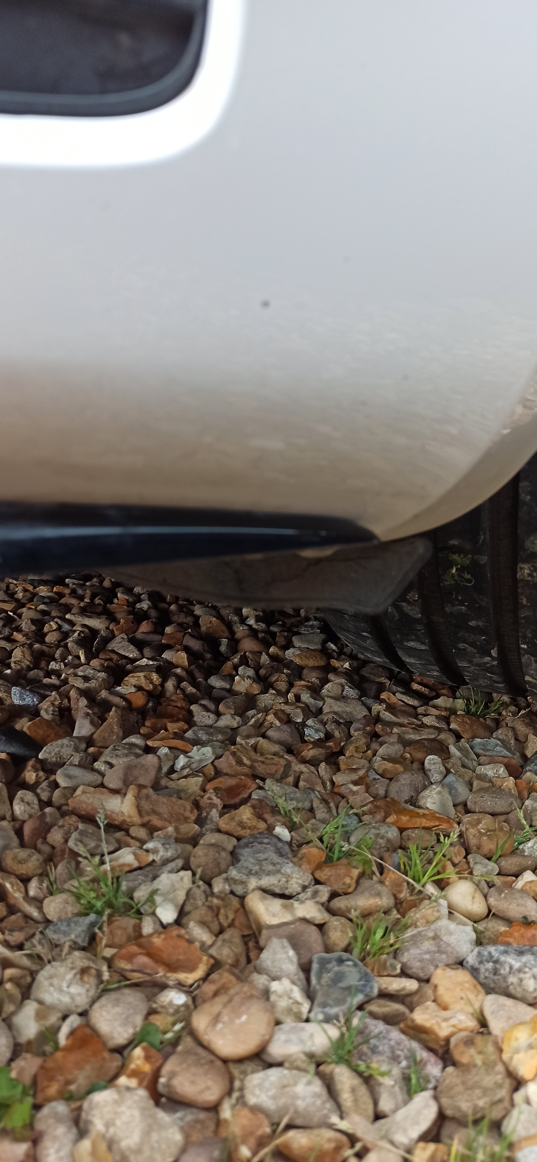

I will give it a measure later for you. I have been over a number of different speed humps without issue.
OK so in the centre at the front from bottom of the Splitter to the floor is 195cm at the point closest to the wheel it is 175cm but there is a part of the car lower than the splitter
