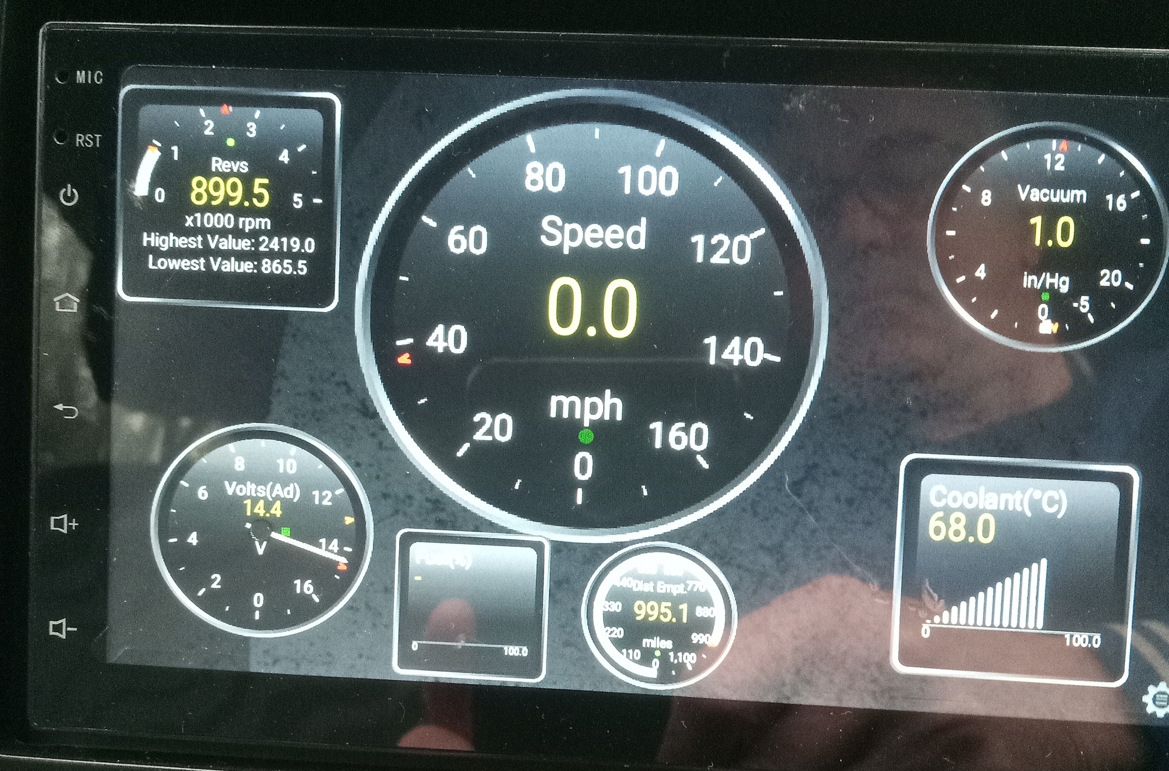

£5 Bluetooth ODB device came today, (good shout Keith). Put it on car about 2.5 hours after a 40 min run from work. Coolant temp started at 56 degrees, left car running, heater fan off bonnet down. Coolant temp climbed slowly to 90 degrees, there was a 2 degree drop at 90, maybe stat opening and then it climbed back to 91 but never got any hotter, radiator fans didn't come on. I could still put my fingers in the expansion tank. Heater comes on luke warm then goes cold as always.
I am guessing we are looking at aux coolant pump, aux coolant thermostat or it needs bleeding with VCDS. The local guy who I used many years ago on my own VW car has shut up shop so looking to find someone with diagnostic capabilities.
