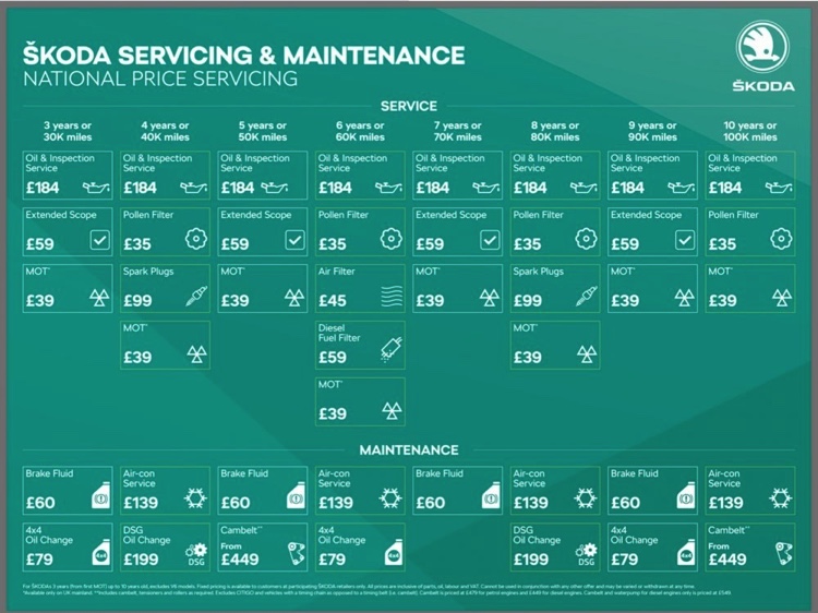

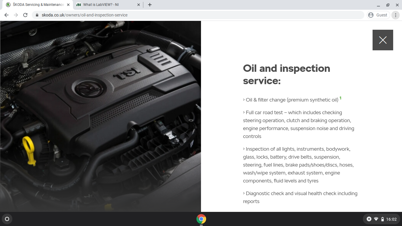

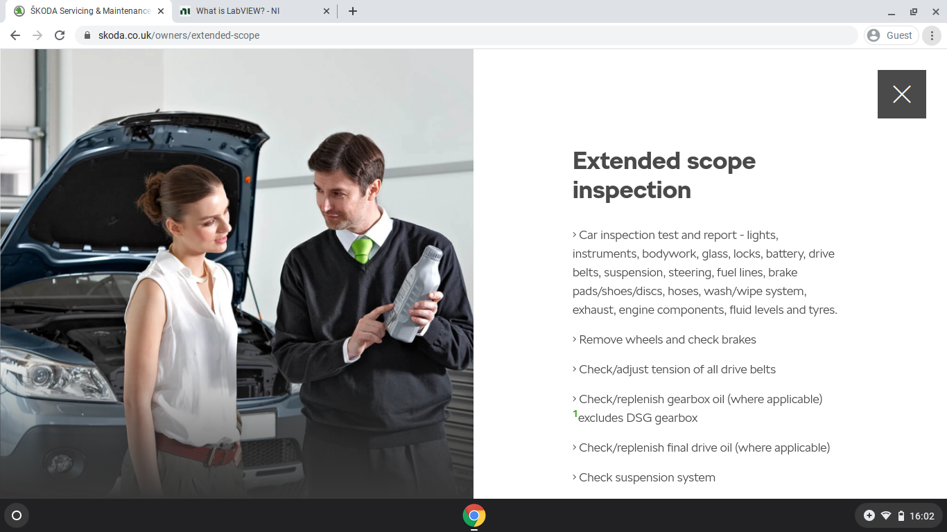

Is there anywhere online where I can find out what should have been replaced and when on a Skoda of this age?
The servicing was called, Minor & Major, and this was Major each 2 years / 18,000 - 20,000 miles.
Then that changed to Skoda calling it Interim & Major if Fixed Services.
Changed again to Oil & Inspection Services and each 3 years Extended Scope.
This is what they now show for cars on Fixed Service Intervals '9,400 miles / 372 days' which ever comes first.
That is showing for car 3-10 year old on the Fixed Price Servicing & Maintenance at participating dealers.  You can get stuff done cheaper.
