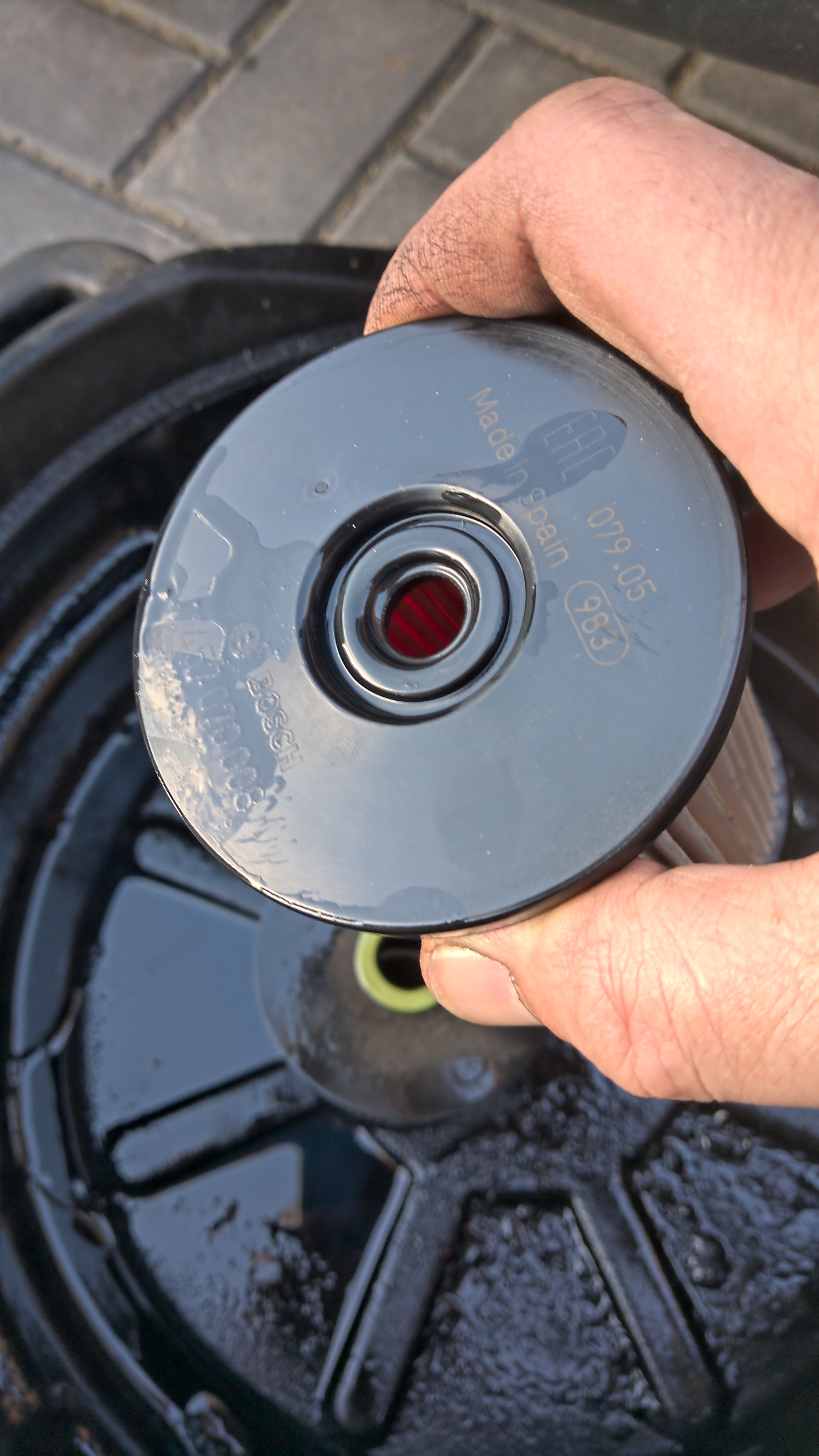

Eurocarfarts have listed a Bosch 1 457 070 008 fuel filter for a 2012 Greenline 1.6tdi but it don't fit mister!

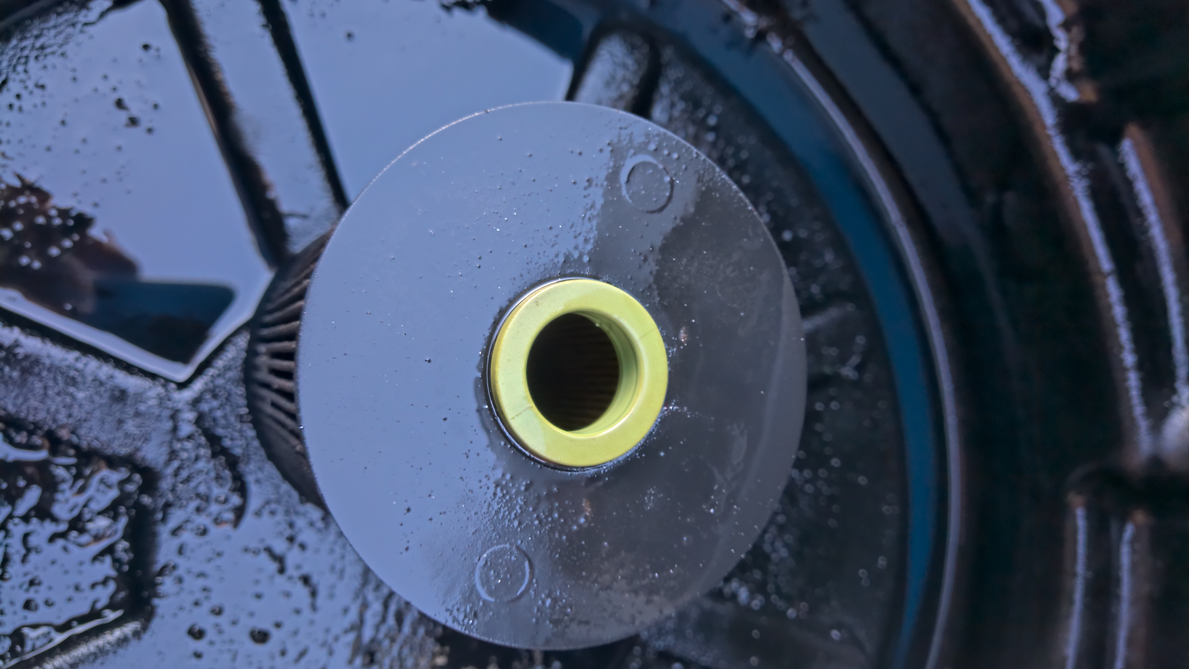

The old filter has the green seal, the hole in the top of the Bosch filter is possibly 2mm in diameter too small, and this is pretty annoying when you're half way through a job.
I can't see a part number or makers name on the old filter, can anyone recommend a part that will fit?

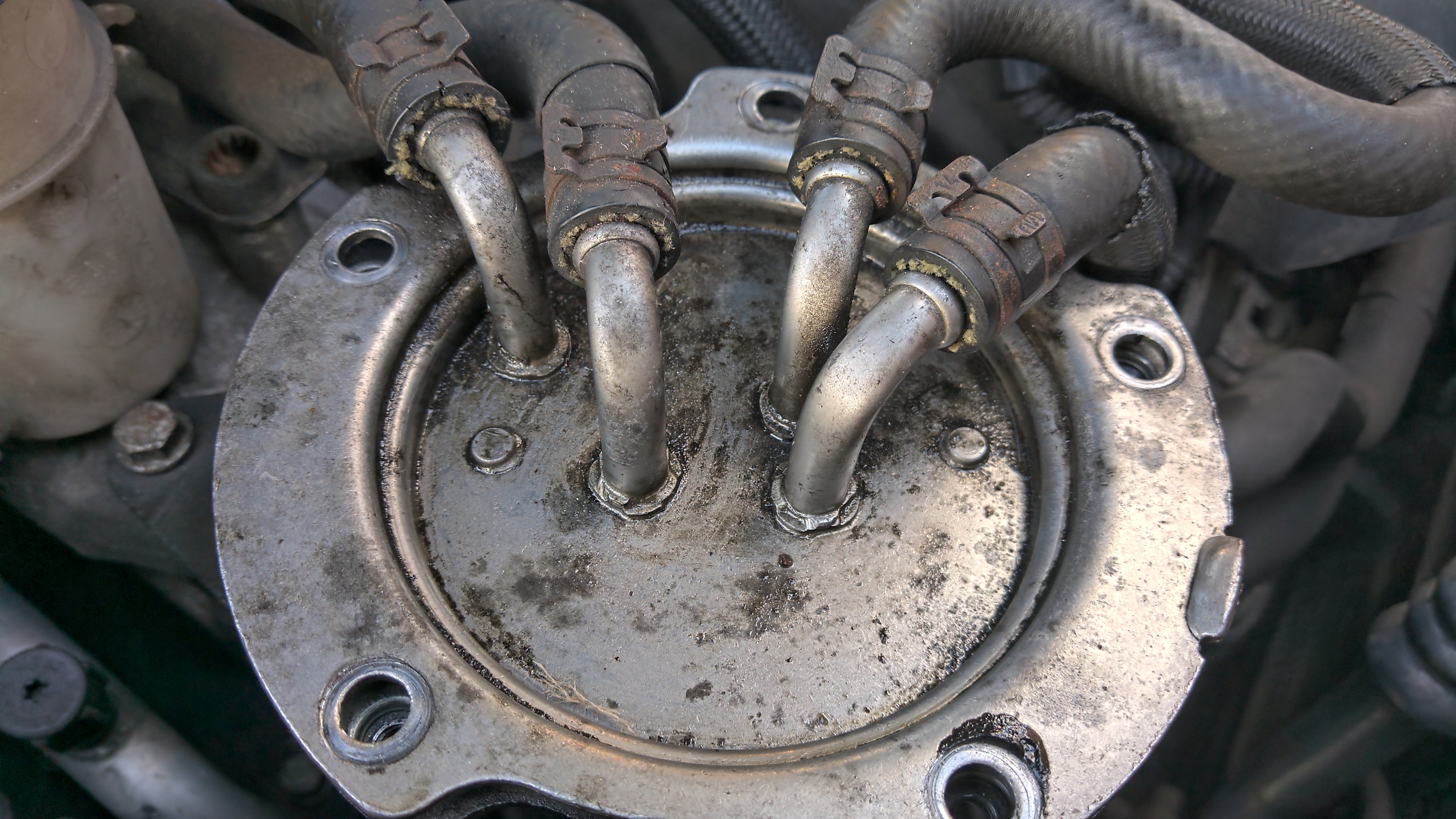

I've tried to put the old filter and seal back on the car and the top of the housing is now sitting about 2mm too high - I was VERY gentle when prising the top off, are they really soft or am I missing something?

There is a 2mm gap between the fuel filter housing and the lid, no matter what I do I can't push the lid down further.
Lid? I am wondering whether I may have caused the problem when prising the lid off - but I don't think the lid is that flimsy.
Could the refitted (original) lid seal be causing the problem?
I have changed a dozen of these on previous VAG diesels and never had any problems, this is a puzzle

These filters, the top needs a bit more force to seat properly, the seal is a little oversized. I've had to use a small block of soft wood and rubber mallet to get some to sit right before.
As for the filter, does the new one not fit over the pipe on the lid at all? The part numbers on the box match up to what you have there.
@HeavyMetalRichyes, part numbers on the box match.
The previous filter fits right onto the pipe on the lid and slides all the way up, the Bosch filter won't fit on at all.

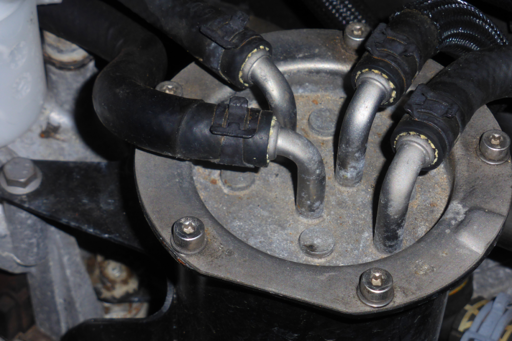

This is mine.

I'm thinking you've possibly gotten the wrong type of filter in the right box.
I have to say though, I've changed a few of this type of filter but I've yet to see one that actually uses this slightly smaller element. My Roomster 1.6 TDi had a different kind again which was a sealed canister.

Mine is the same as the one you have taken out.
