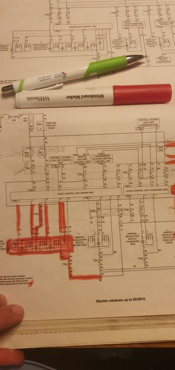

I see. I'm still trying to fix my windows 😞 I downloaded a wiring diagram and trying to go step by step on what my issue is. I'm contemplating to buy VCDS unlimited vins use it and then resell it, from what I understand, the unlimited VINs version holds its value.

I'm not sure but I don't think that unit has much if anything to with with the working of the electric windows.
Which bit(s) of the wiring info make you think it could be important?
I don't know to be honest lol I see that is connected to one another so I thought why not swap it around since I have another never Fabia. I might be wrong but I guess I have to eliminate all possibilities

My electric Windows are not working. They are intermittent when the battery or the harnes is disconnected. They will work for 5min then stop all together. Did fuses, check wiring + continuity. Swapped battery, swapped switches. No luck.
