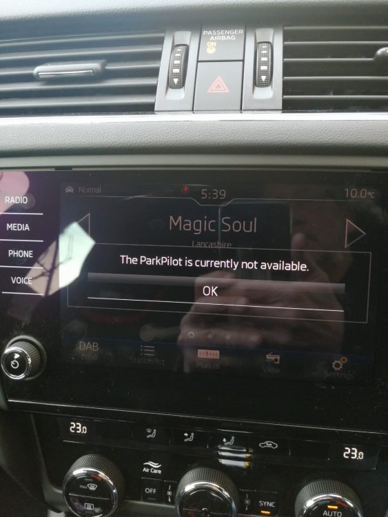

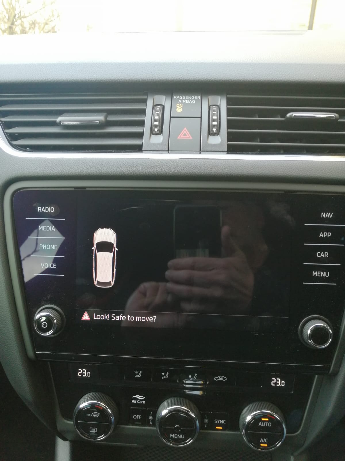

Now, with the camera disconnected, a park pilot error exists when the infotainment starts up: "the park pilot is currently unavailable". Then when reverse is selected, only the small park pilot image is displayed - the same one when the camera image was displayed. See photo below. When drive is selected, the actual park pilot is displayed, which is clearly an error also.

Without seeing an autoscan from VCDS or similar, it's hard to offer advice. It might need some faults resetting to get the original behaviour...
I'm also slightly dubious about how the Chinese camera's are plug and play without coding. If it has changed the coding, it should be possible to correct it, but again, we'll need to see what's change to offer a best guess :)
Might be worth checking the VCDS owners list and map to see if there is anyone local who can take a look?
As above, I’m not sure how they do it with no coding, it clearly injects some kind of code but in any case the clicking noise is likely to be the extra loom hitting against the blend door in the footwell. A careful reroute will sort that for you. I would suggest trying to go to 5F Adaptations, Car Function List BAP Gen2 and checking if VPSx0B has been activated as that might be it. It’s basically looking for the camera but not finding it which is where the error message is coming from.
