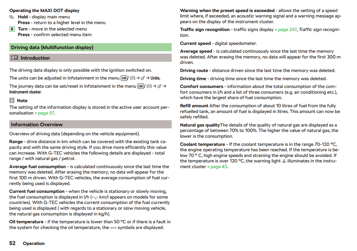

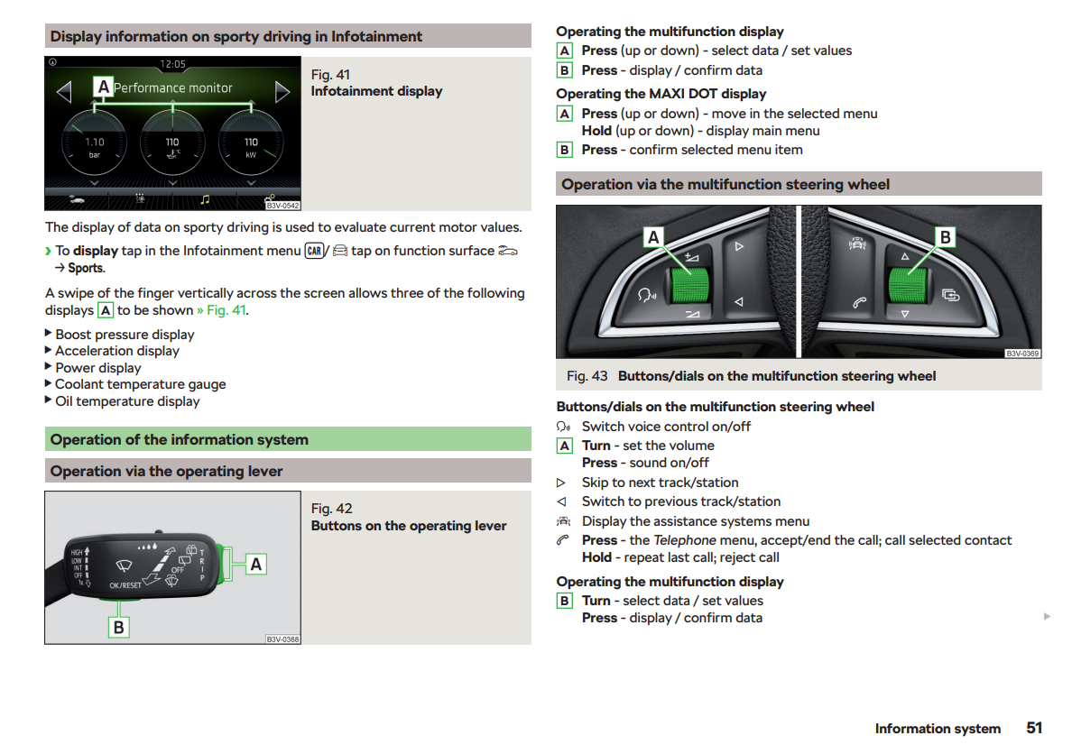

Go to the 'display main menu':
- for a MFSW, press and hold the right most buttons
- for a wiper stalk, press and hold either end button
Find 'driving data':
- for a MFSW, turn the right thumbwheel up/down, then press the thumb wheel to select
- for a wiper stalk, press the end up button up/down, then press the button underneath to select
Find the MPG:
Simples ;)

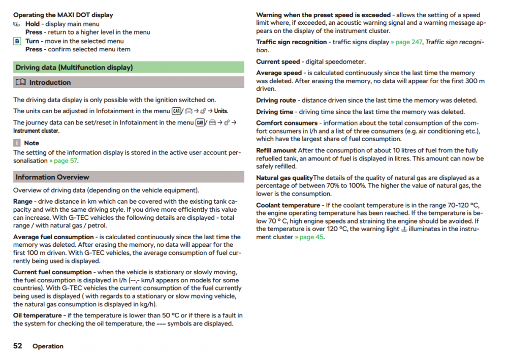

Couple of snippets from the manual:
