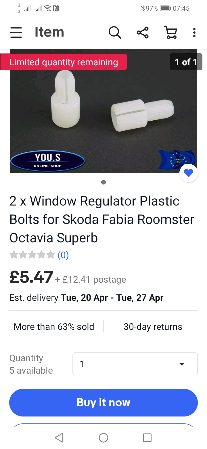

On looking this thing could be a "dowel" or "straddle pin" or a plastikboltzen fensterheber
maybe this?
I've only ever seen those cause trouble when badly fitted.
Where can i buy from?
"probably" having proper Skoda regulator and new pins fitted by dealer £300 but only the best for my baby
