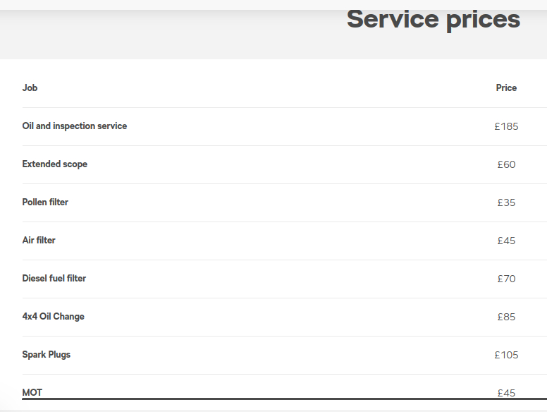

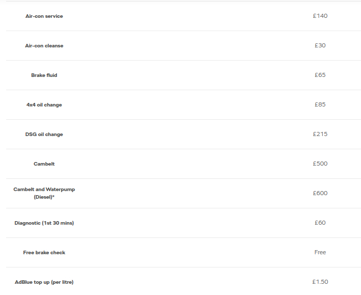

This is a regular thing discussed as Skoda Main Dealers & Skoda UK do not know which answer to use on any particular hour of any day.
This is the SKODA UK FIXED PRICE SERVICE & MAINTENANCE LIST on cars 3-10 years old on Fixed Service Regimes.
@ participating dealers.
Some can do cheaper and some can charge more.

So they are telling you prices of stuff including those not required like the DSG Oil Change.
