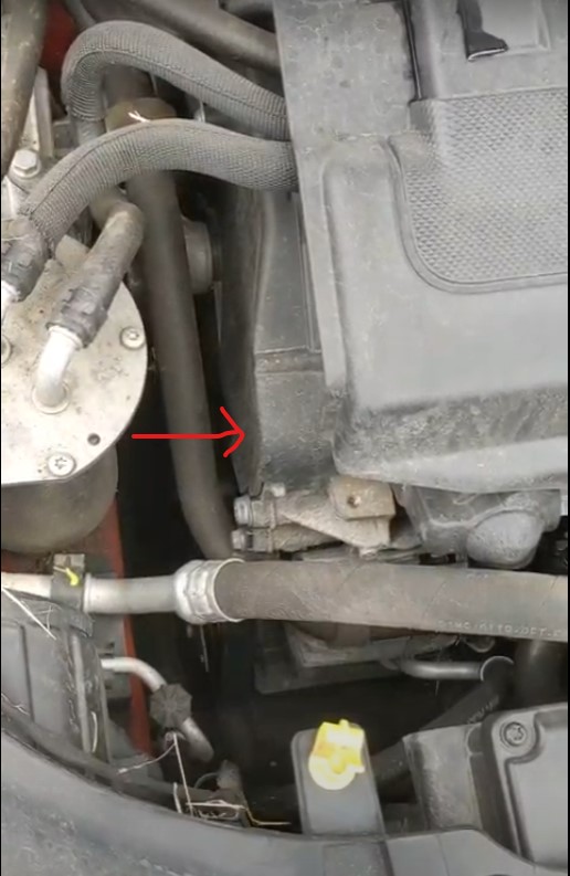

Having had the bonnet open and running the engine, i've noticed a weird "grumbly" noise coming from the drivers side. It's a bit weird, and doesn't seem to overly change at increasing rpms. You might be able to hear it in the video behind the normal engine noise. Something that was a bit un-nerving was that putting even slight pressure on one of the side covers (the cover physically moves in a small amount) causes a rubbing sound (like a pulley rubbing on the cover).
Water pump suggestion immediately springs to mind :(
Edited by micro
" Something that was a bit un-nerving was that putting even slight pressure on one of the side covers (the cover physically moves in a small amount) causes a rubbing sound (like a pulley rubbing on the cover)."
I can't imagine that you could do it but are you sure you are not pushing the cam belt cover onto the pulley or belt? If you continue to lose coolant,  a water pump leak maybe drying on the block, so as Nick suggests, bring forward the belt change and change the pump if you find no other leaks. A dealer or garage can do a pressure test before you waste time effort and more driveway cleaner. :biggrin:
Well, that's exactly what I thought I was doing. Which in my mind should not be possible... I've noted the coolant level and will keep an eye on it
I've inquired with some local garages as to cost and availability!
Edited by micro

Micro, I had a similar noise (although not whilst pushing on the covers). Turned out to be the air con pulley which requires a new air con compressor.
Hi mate,
I've had a good push/pull of the aircon pulley and nothing seems out of place.
It's gone in to have the belt/water pump done at a VW dealer, and i've asked for the water pump to be retained so I can see it. A good deal on it really too, they beat the fixed price of Skoda/VW even after Skoda's "you need to do this" discount of £60.
