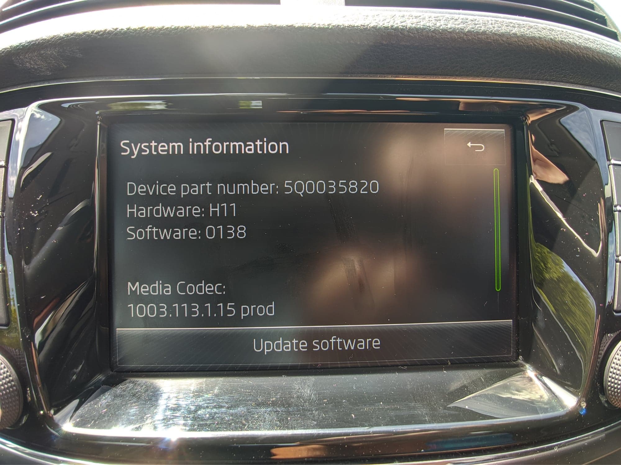

I've attached photo of her head units software info anyway...
You must have the glove box unit (installed behing the screen, to the left of the glove box) replaced - either to Bolero 5Q0035842x or Amundsen 5Q0035874x (x - A, B or C). New unit must be hacked.

I checked the system page and Device no. is 5Q0035842A, Hardware  H24, Software is blank, media codec is 2101.0.0.8

Our Fabia is a similar age and has the Device number and hardware number you gave above, but ours has software 0245 and media codec 2101.0.0.10
It has "smartlink". It definitely works with Android auto for "satnav" on the Bolero screen - but it needs the USB lead in, and bluetooth paired to work. I have not used it for streaming.
I believe "smartlink" should work with Apple play, but I don't use apple stuff so I can't confirm if it does.
@PAB567 will likely know if it will work,  and if the missing "0245" software in the display is significant.
