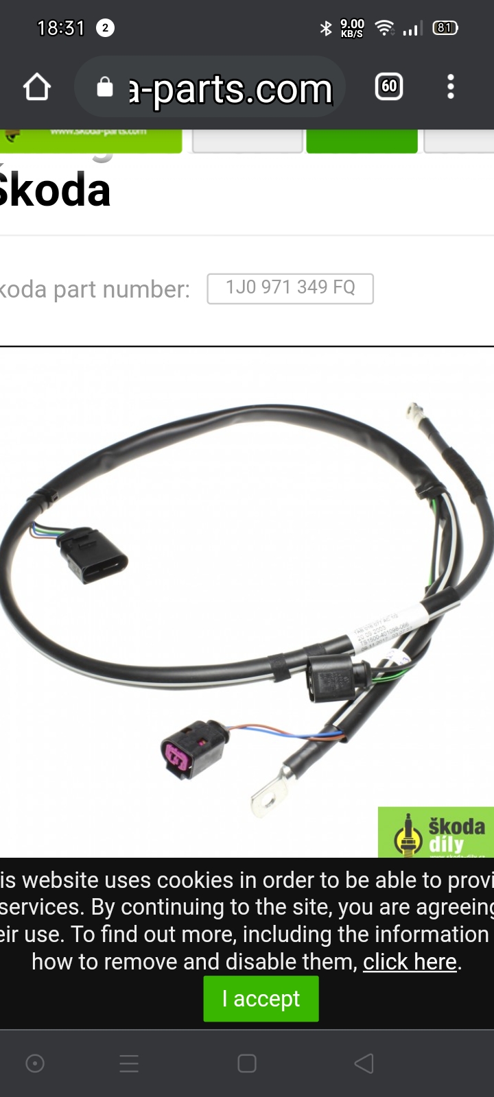

HOW MUCH FOR A CABLE??
£75 BEFOR ETAX AND SHIPPING FOR A CABLE FROM ALTERNATOR TO BATTERY??
And my turbo justwent. waaahh
Anyone know whether other  cars such  as the 1.9 tdi audi or vw on similar engine will have the same cable?
code is so similar
mine is 1J0971349FQ
I really don t want to scrap the car but its been adding up
Anyone got one of these cables from a mk1 1.9tdi ASV or AHF engine
TIA
  • Sponsor
Can you not get one made? Is it just the main high-current cable you need, rather than the 'alternator loom' which that part number seems to be?
that cable  has  plugs going off of it other wise I would - unless you think that the smaller wires with plugs for ac etc are completely seperate and can be added back in?

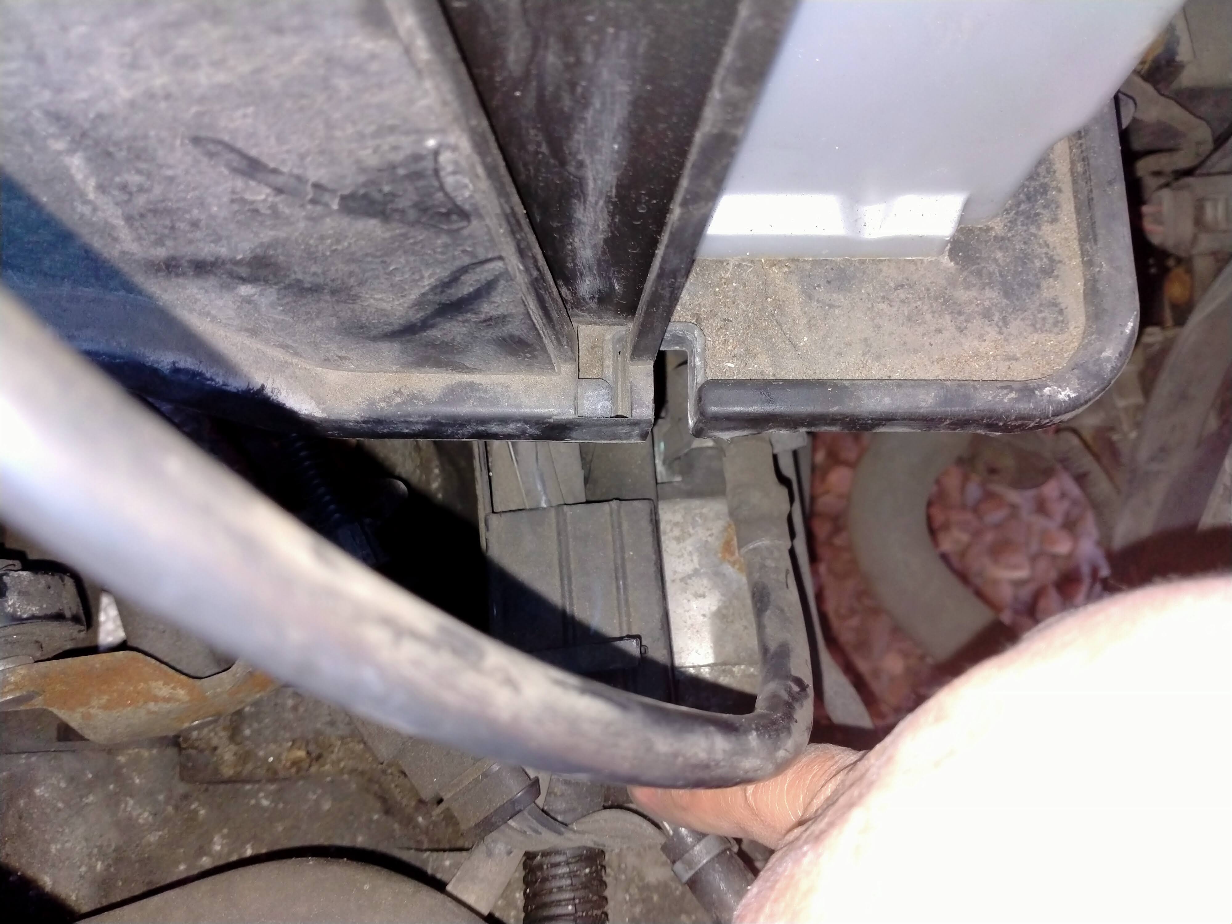

no signs of melting but the battery end of this cable  is under the battery not on the top bit

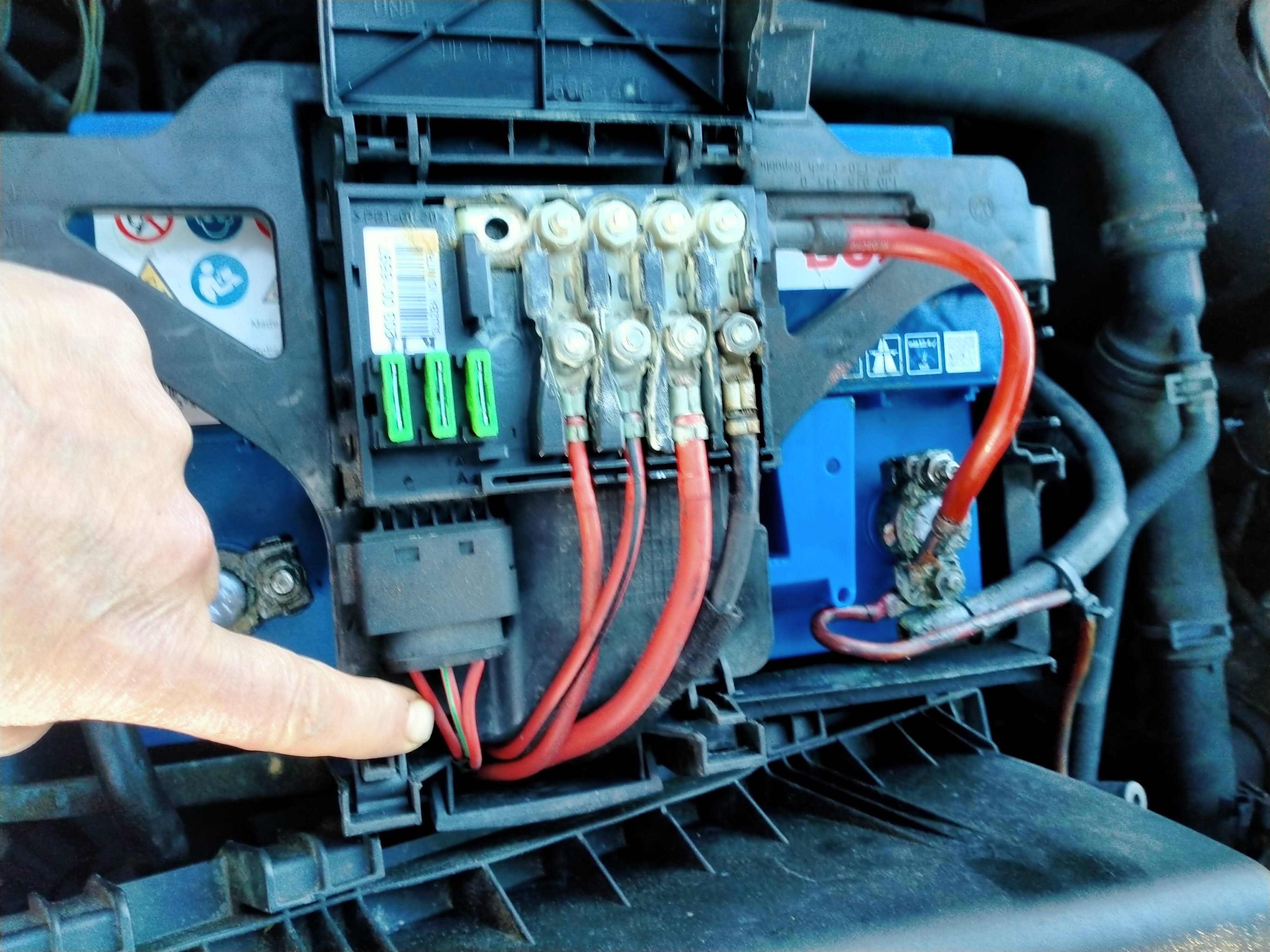

Are you sure the battery end of it doesn't go to the right-most of the strip fuses?
not unless  it goes under then comes up again
I have put photo of me pointing to where I think you mean
I also took a photo of where it disappears under the battery (finger on it)
There are loads much cheaper  of similar harnesses with same  OEM number save for the last 2  letters but unless it is a 1.9td ASV or AHF with airconditioner I do not think it will be a swap

Pretty sure it's only that black cable on the right-most fuse that's going to the alternator output stud.

Yes it does go under battery but also as you said comes up to the battery terminal. Mechanic here now. I got in the end an exact copy of the cable from a Seat Leon mk1 for £20. Took me days to figure out what other cars had that cable as new they are £60-80.
By any chance do you know what the 3 plugs are for? One must be for air conditioning but all of the diagrams I found have them numbered as 7,8,9 and 11 but no corresponding ledger

One of the two-ways will be to A/C compressor, the other for alternator signals.  The four way takes these wires onwards to their final destinations, I guess.
I was thinking you could leave all of that stuff in place, cut off both ends of the thick cable and just tyrap a replacement thick cable to the existing loom.
Do the end crimps of the thick cable on what you have bought look to be in better condition than yours?
Compare colour of the battery fuse end crimp to your discoloured/overheated-looking one from the photo above.  Is the replacement shinier, like the other wires' crimps going to the other strip fuses?
