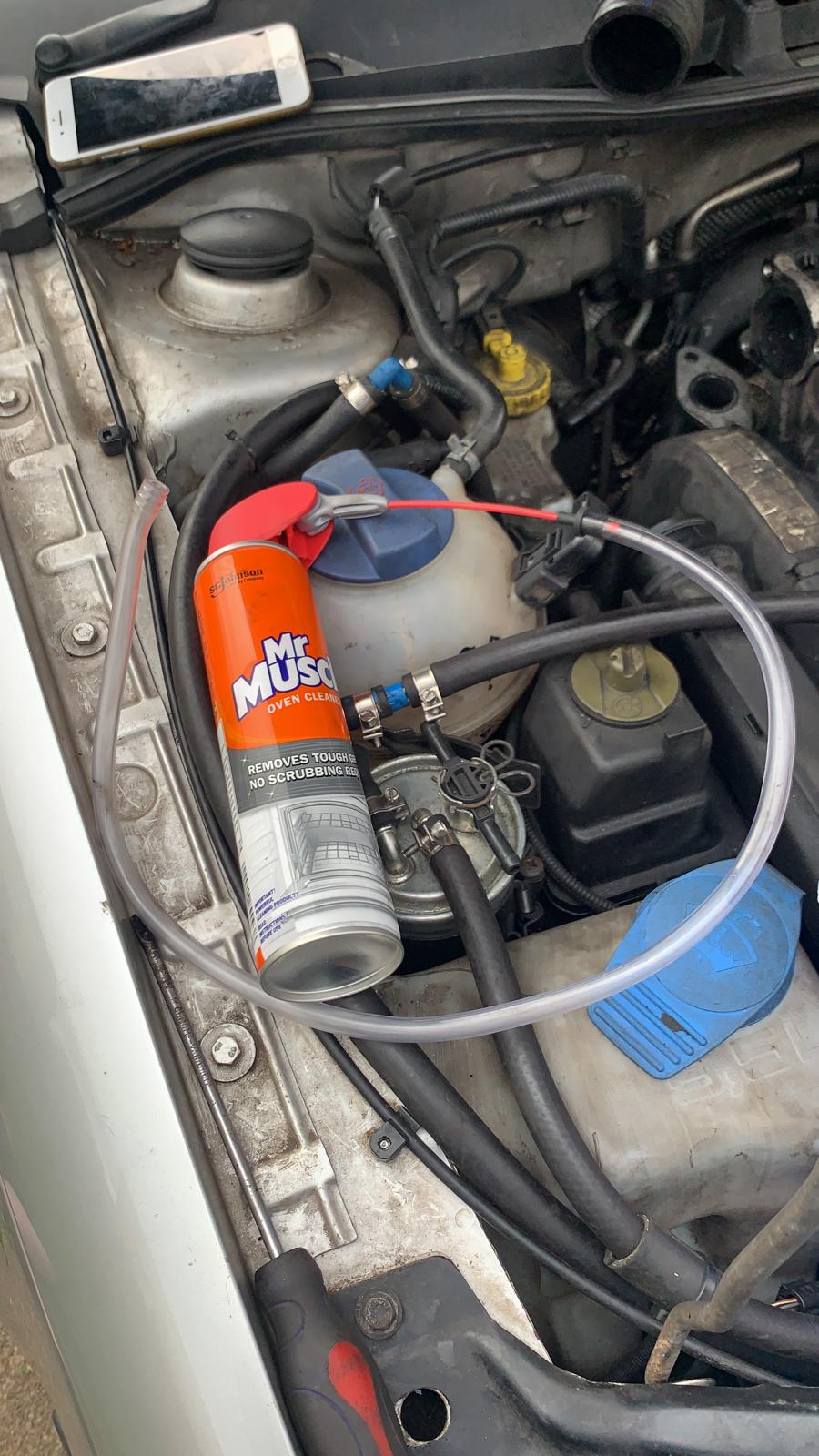

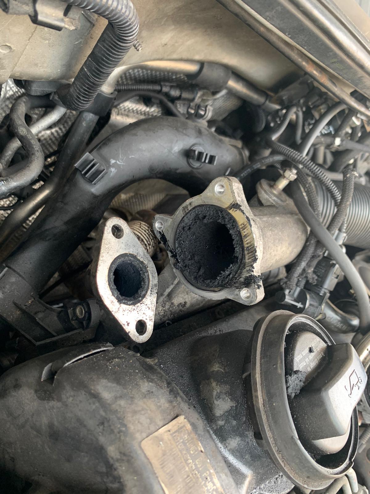

  3. What happened to Lofty I cannot thank him as he seems rto have disappeared off the forum. Anyway I had low pressure boost on my 110 ASV Octy 1 (see my thread) So this is not just for limp mode and Overboost. I never had a single light come on nor went into limp mode - I just has no power and on Scottish hills it sucked. Motorway not so bad - could get up to speed but MPG only around 42-45mpg. Now all the vacuum lines are replaced, the wiring checked, the MAF , MAP and intercooler pressure sensor cleaned and a couple of tiny holes in intercooler were epoxyed. After one Mr Muscle treatment things seemed a wee bit better. Second treatment the next day and we heard the tubo whine ...it has been silent and dead as a dodo since i got the car 6 months ago. Today Mr Muscle three and we have lift off!! Turbo spooliNg and actuator moving as it should. Then my mechanic installed an 130 BPH ECU that I got for £100 and now I have a fab car. Anyone in need of a hardworking , thouroughly decent mobile mechanic in or around Ayrshire , drop me a line- I told him about MR Muscle and he was willing to try and do the rest of the work. I am 100% certain that a garage would have charged £1000 plus to install anew turbo and that would be without the cleaning of the other componenet and finding the tiny holes in the intercooler. I can now return the new oem trubo I bought (a Garrett from Catsand Carbs) for £225 I will report back on the mpg next week once i have clocked some miles avec turbo
  4. Anyone know what happened to Lofty79? Want to thank him for his Mr Muscle thread. So despote this being an underboost, the actuator was stiff and there was a lot of carbon. brian spent upwards of 10 hrs changing all the vacuum lines , cleaning MAF, MAp and intercooler pressure sensor. There were a couple of holes (tiny ) in the intercooler [pipe now epoxyed. N75 ok. Did Mr Muscle once and the turbo whined which is forst sign of life from it since I bought the car. Today Mr muscle again and BINGO we have power! BOOST Then Brian installed a 130bph ECU that had been in a freinds old ASV octavia and now it all seems to be working fine. Many thanks to all who chipped in and I am off to add to Loftys old Mr Muscle thread First time I have had a properly working vehicle since i bought it!

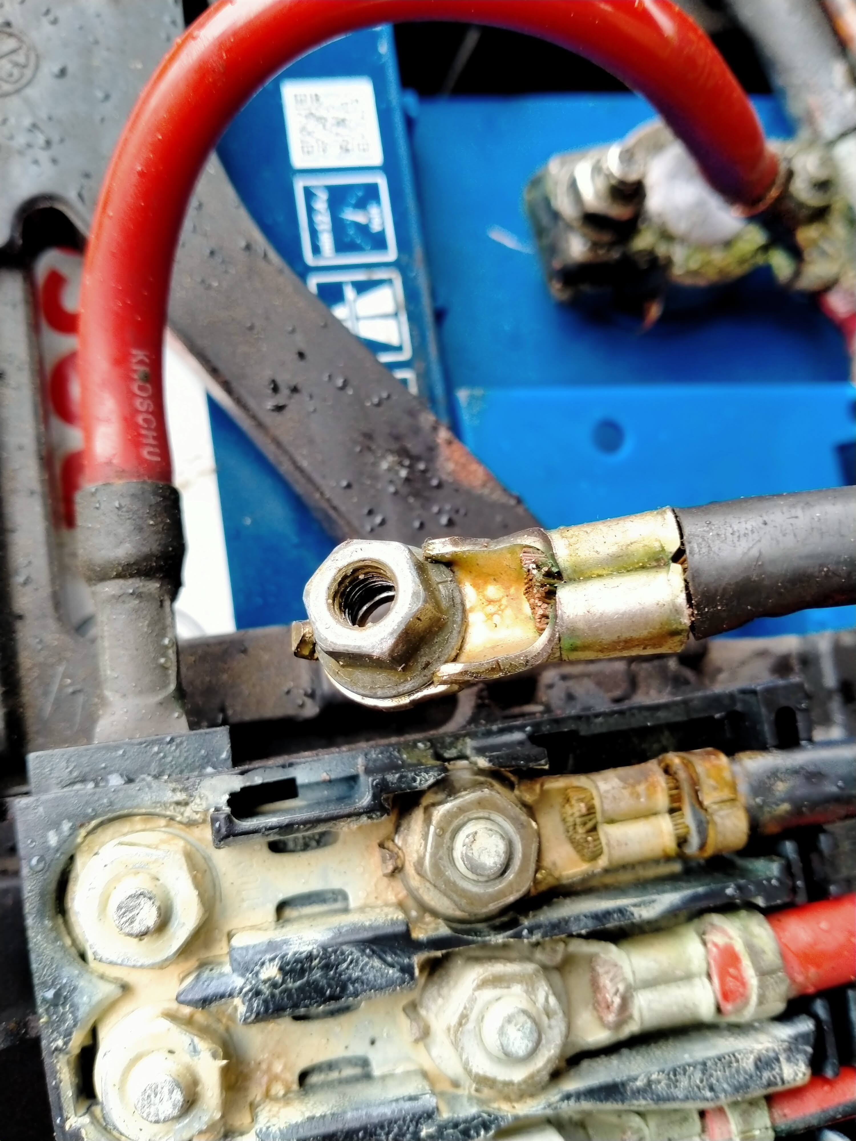

  5. battery new alternator changed and good N75 seems ok but wait there is a control for that N75?- photo of wher please? I guess Brian wanted to know the psi (or inHg for each component so he could put the mikki on and not have to change every single bloody pipe

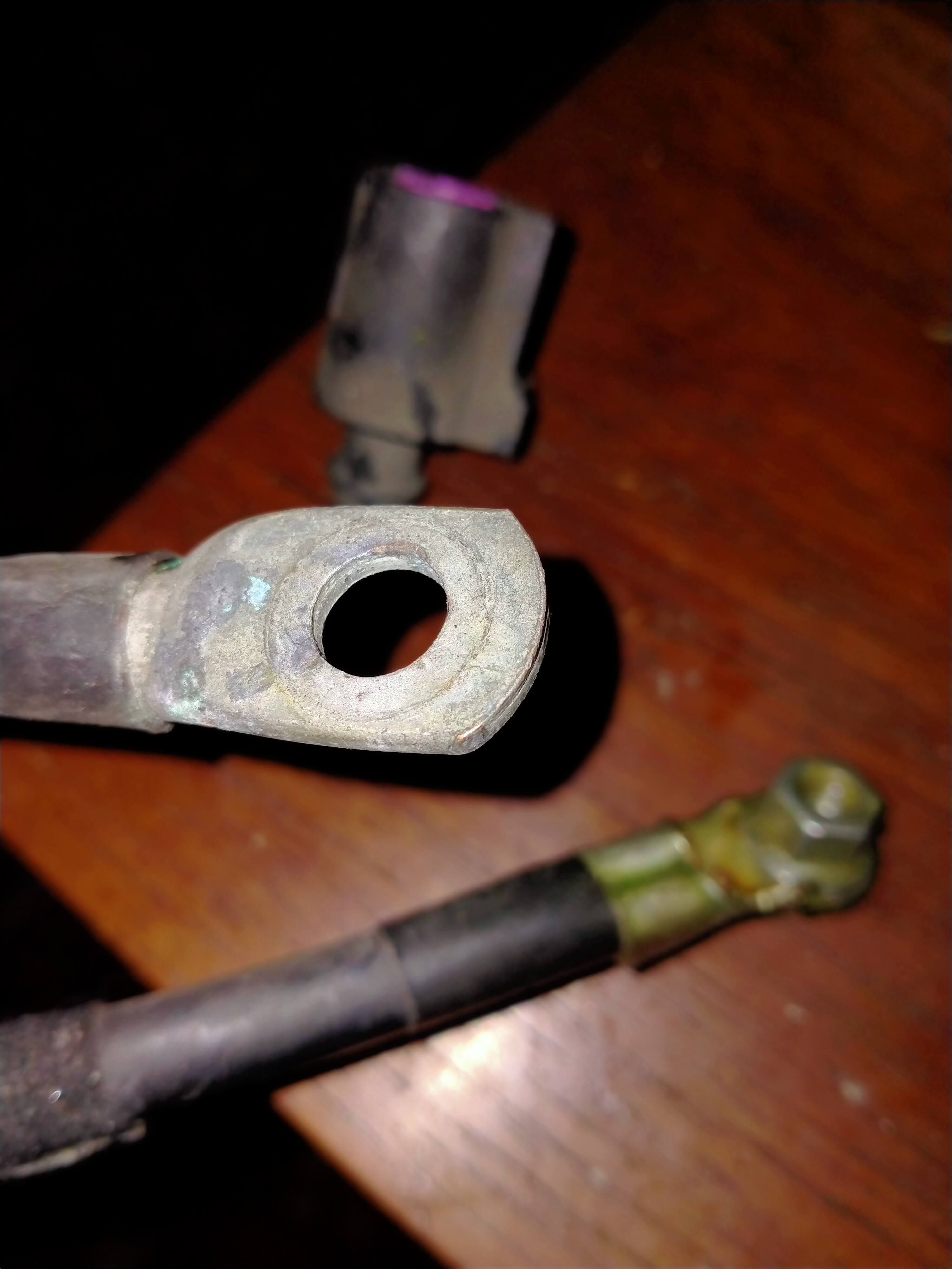

  9. will do. Hopefully this latewrnator will work as it is a ****** getting them out - werdly going back in was easy. This has more do do with my veg oil set up than Skoda design. Next week replacing turbo- decided on a new one with warranty rather than a used one . £240 before paying for it to be fitted. Sigh.
  10. Looks ok to me. old one not off yet but photo of the two ends side by side and photo of bioth ends of the 'new ' one

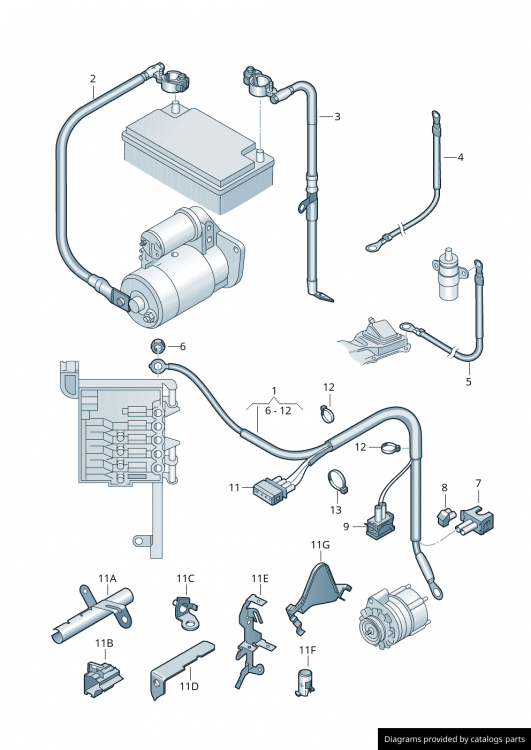

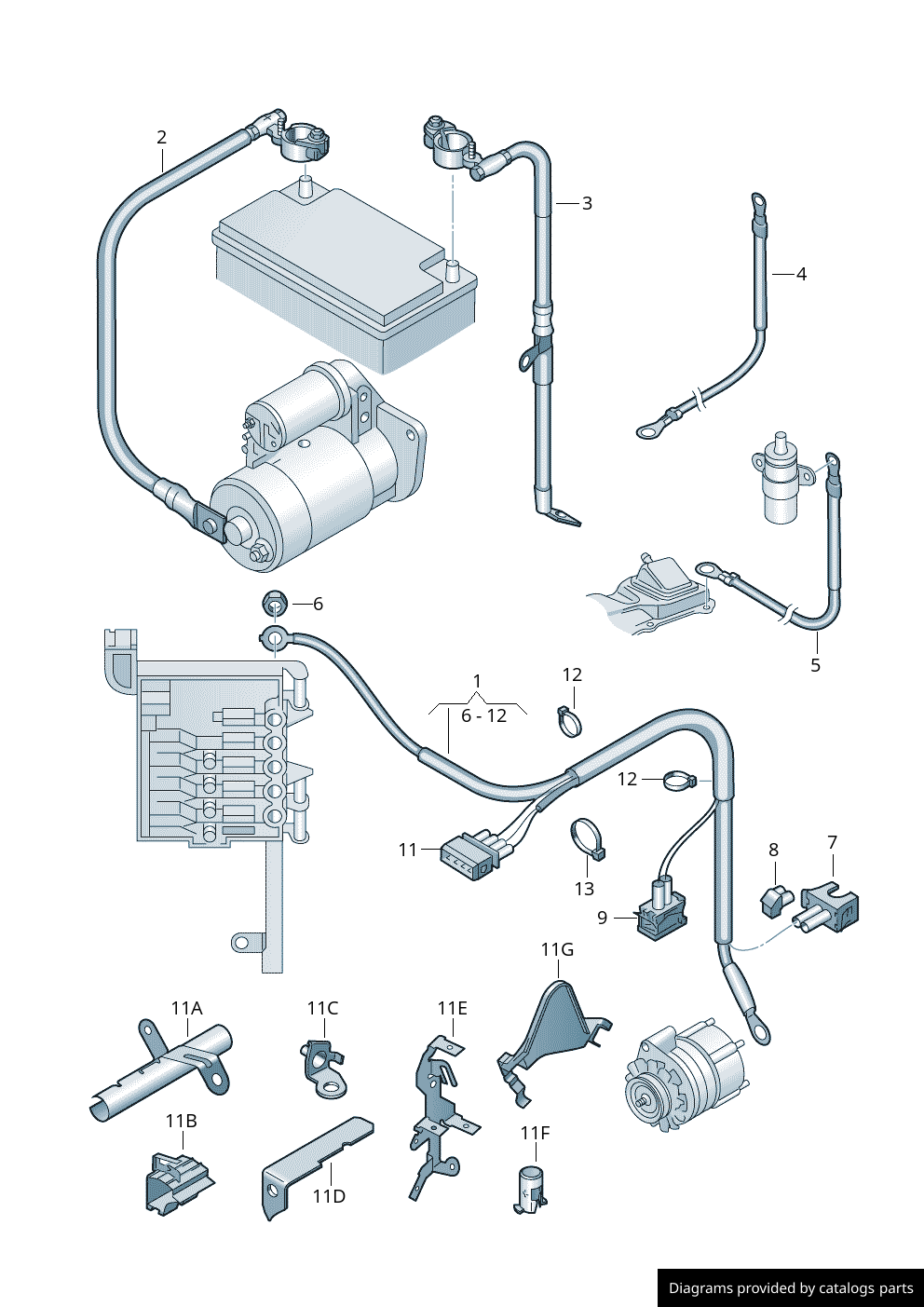

  11. Yes it does go under battery but also as you said comes up to the battery terminal. Mechanic here now. I got in the end an exact copy of the cable from a Seat Leon mk1 for £20. Took me days to figure out what other cars had that cable as new they are £60-80. By any chance do you know what the 3 plugs are for? One must be for air conditioning but all of the diagrams I found have them numbered as 7,8,9 and 11 but no corresponding ledger
  12. ok thanks. i will show all this to my mechanic when he changes the alternator next week
