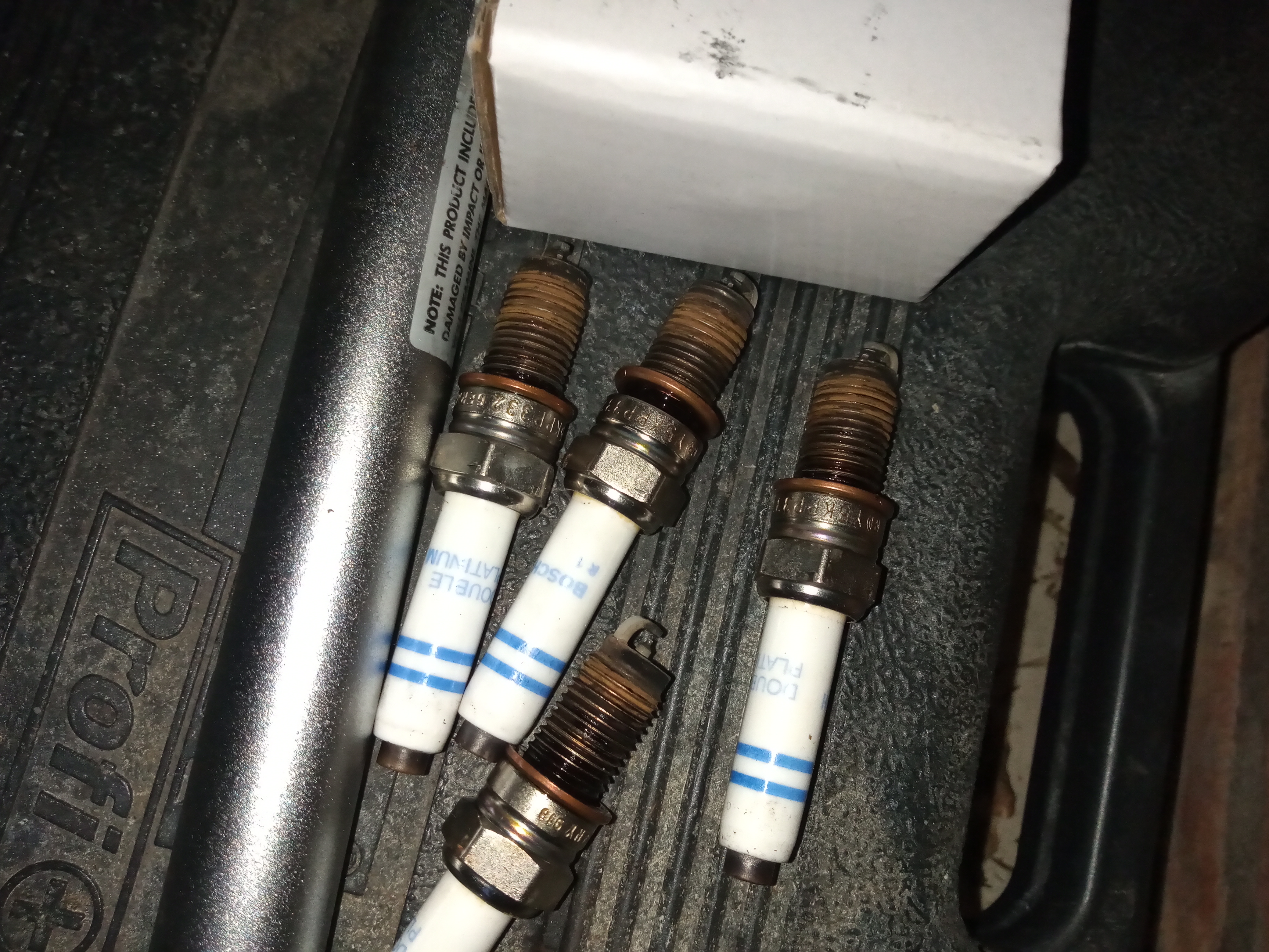

So yesterday i fitted my new Bosch Double Platinum spark plugs. Old ones looked to me to be originals from when car was new- see photo. Im pleased to say that the slight misfire/hesitation has completely gone and car feels slightly livelier and engine is definitely quieter and smoother. So as i suspected this car did not have a service when we bought it and taking it to a Skoda dealer for a check over to find out what was causing hesitation/misfire at a cost of £65 and being told it was fine had been a waste of time and money- lesson learnt check car and service it myself - get hard jobs done by an independent trusted mechanic as i have done for past 15 years too👍
