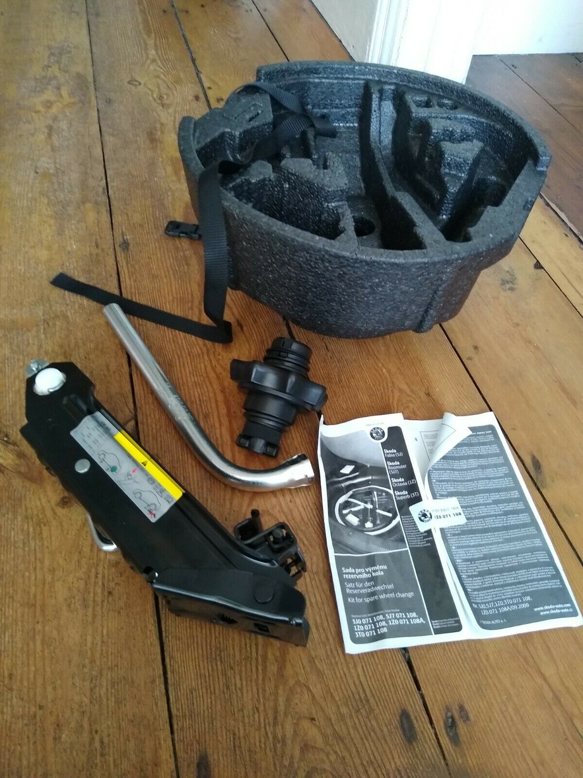

will this type of jack fit my skoda superb 2020?

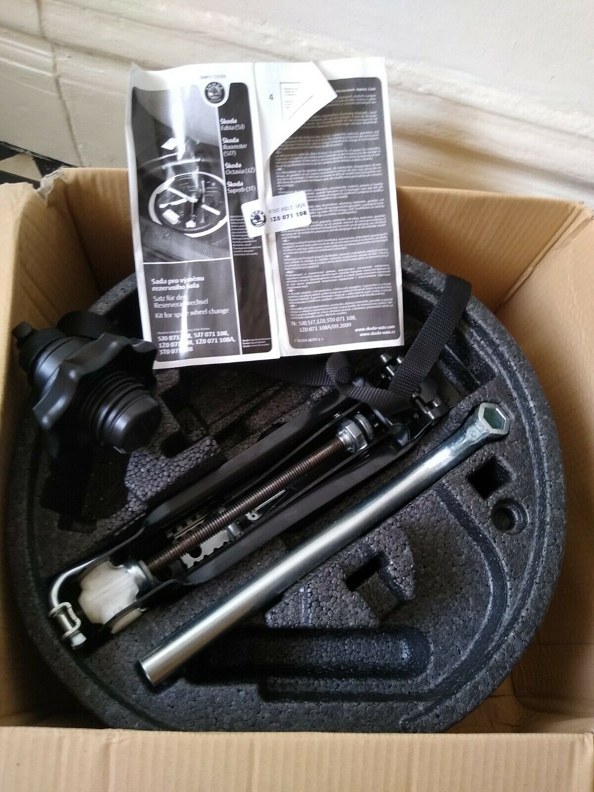

This kit is on Ebay the leaflet says octavia and superb T3 so will it fit a newer superb.
Yes the jack and looks will fit.
That kit looks like this one from the Octavia MK3 Scout. 1050CZK is about £35
https://eshop.skoda-auto.cz/cs_CZ/sada-pro-rezervni-kolo-octavia-scout/p/5E0093860D
It's being sold for an Octavia MK3 Scout so maybe you need at least a 17" rim.
I would try something like this from the standard Octavia MK3. However, I don't know if it will fit the Superb MK3.
https://eshop.skoda-auto.cz/cs_CZ/sada-pro-vymenu-rezervniho-kola-pro-octavia-iii/p/5E0093860B
Then maybe you could use a 195/65R15 6.5Jx15 ET43 spare wheel from the Octavia MK3 (or Vredestein Quatrac 5 205/70R15 6.5Jx15 ET43)
https://eshop.skoda-auto.cz/cs_CZ/kompletni-rezervni-kolo-16/p/5E0601011J
You wouldn't be able to use a 15" spare wheel on the front of a Superb MK3 as it won't clear the brake calipers, so use a 15" spare on the rear only.
Some of the more powerful Superb MK3's have rear brakes discs with a diameter bigger than 288mm. If the rear brake discs have a diameter bigger than 288mm, at least a 16" spare wheel would be needed.
Edited by Carlston
The kit shown above is a single lever jack as used on Octavias and below. The jack supplied by Skoda for a Superb is a heavier duty scissor jack. The jacking points on the Superb 3 are further inboard than an Octavia, and have a deeper plate , its not just on the sill lip like the octavia, so I wonder if that jack will fit properly around the jacking point and lift up the body where its supposed to. The shape style of the mating end is completely different and symmetrical iirc.
Some pics in this thread
https://www.briskoda.net/forums/topic/443549-additional-jack-points/?do=findComment&comment=4986932
Thanks for the info lads, i have a skoda 16" space saver wheel coming on monday so i was trying to get a jack to go with it, but like one of you mentions  I need a scissor type jack with a groove in it, i have took the foam thing and compressor and gunk can out i will try and sell them i think?
