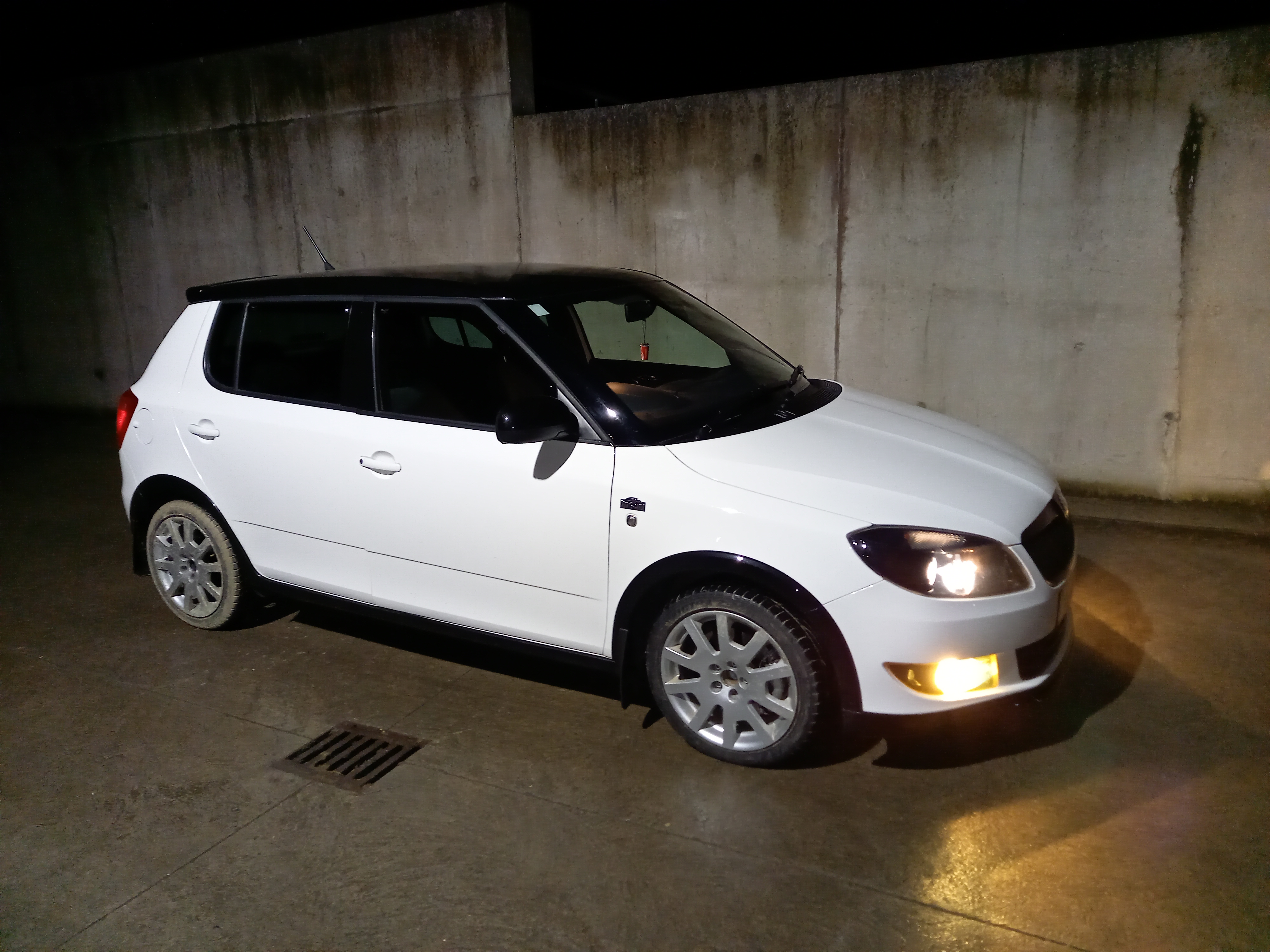

No, both mk1 and mk2 are 5x100 stud pattern.
See the picture I've attached of mk1 vrs wheels on my mk2.
You need to get them painted black. Will look so much better lol😀
They were only put on to test fit. I kinda like them in the silver though, they look better in silver on the mk1. I only wanted to try them out as I intend on using these as a winter set this year.
