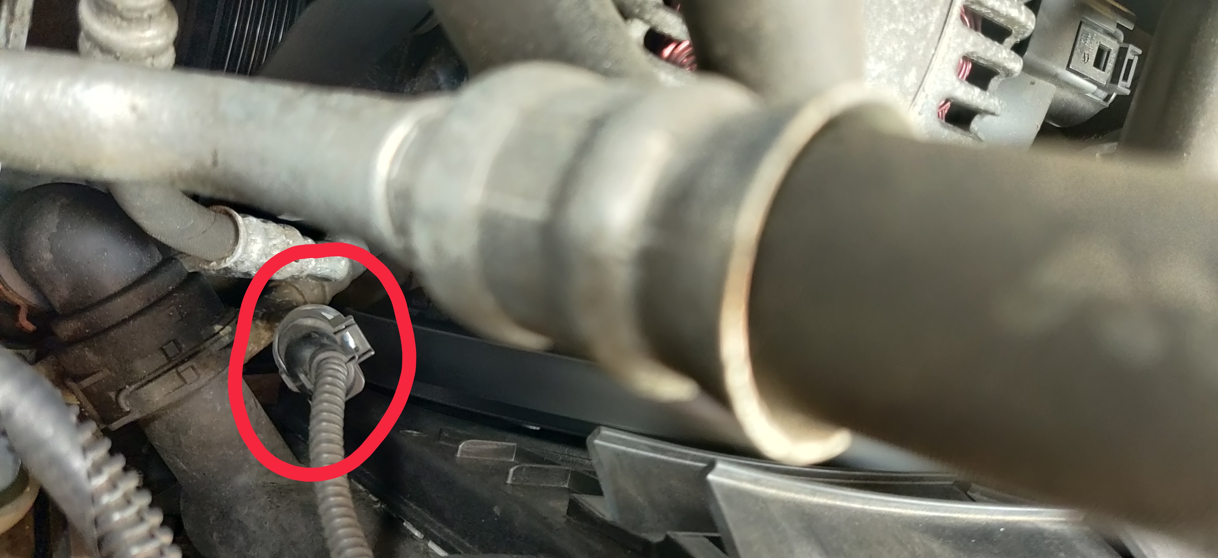

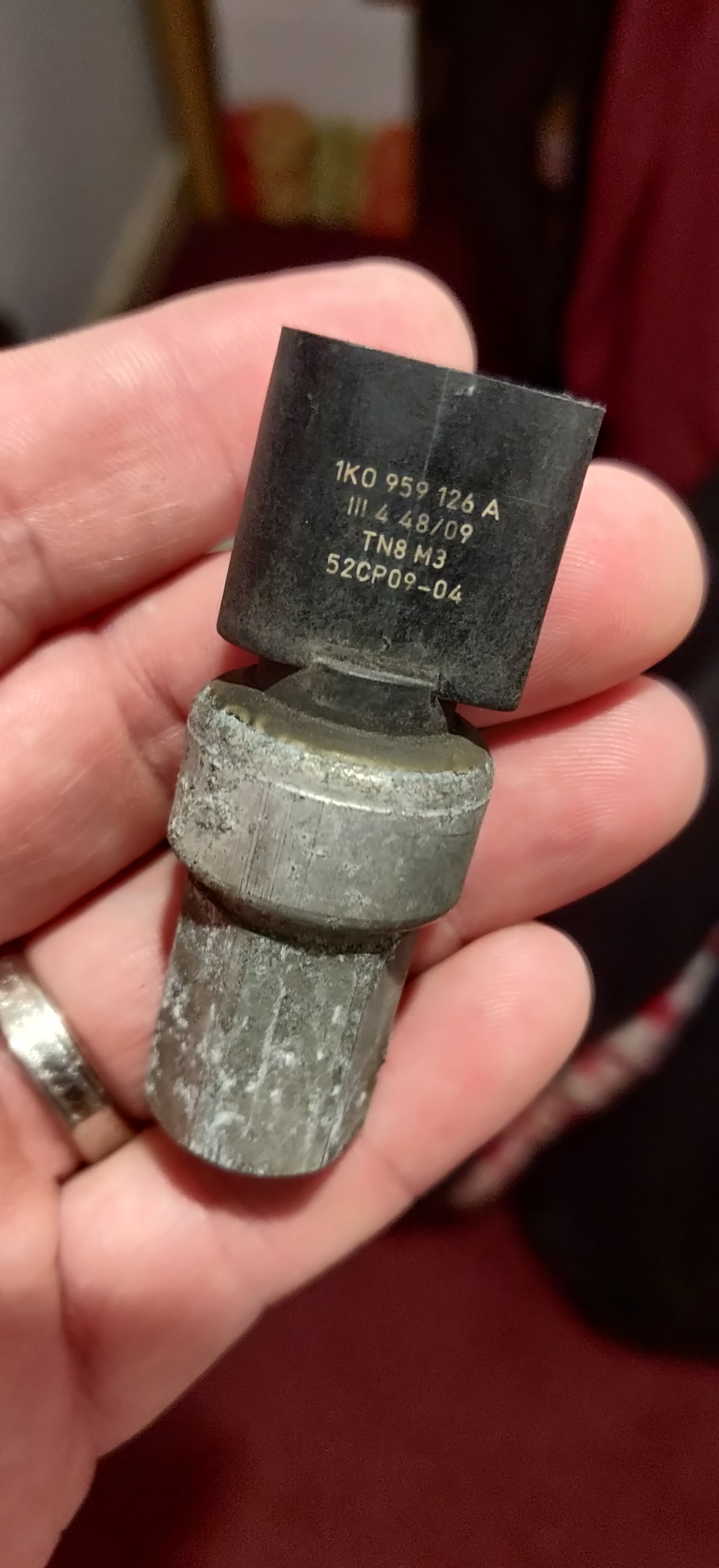

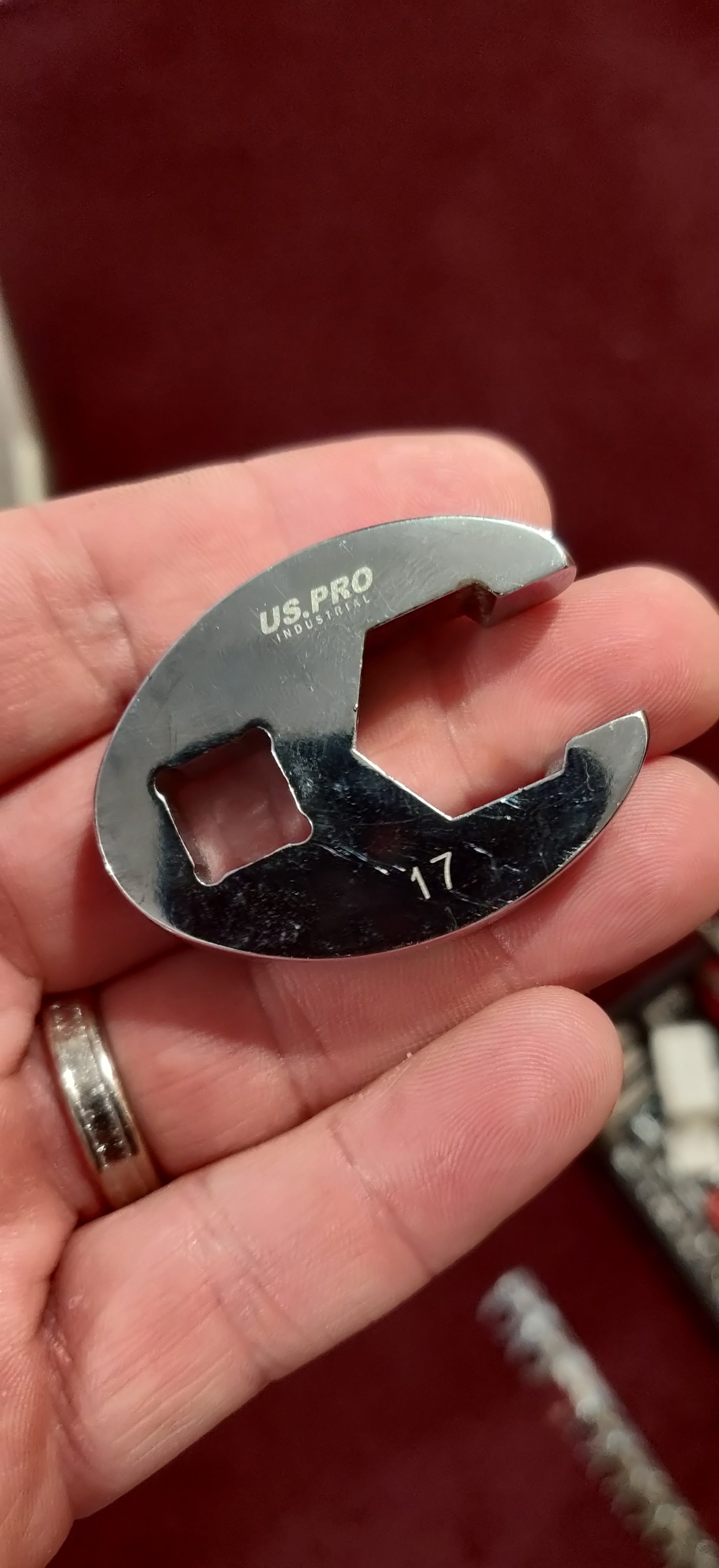

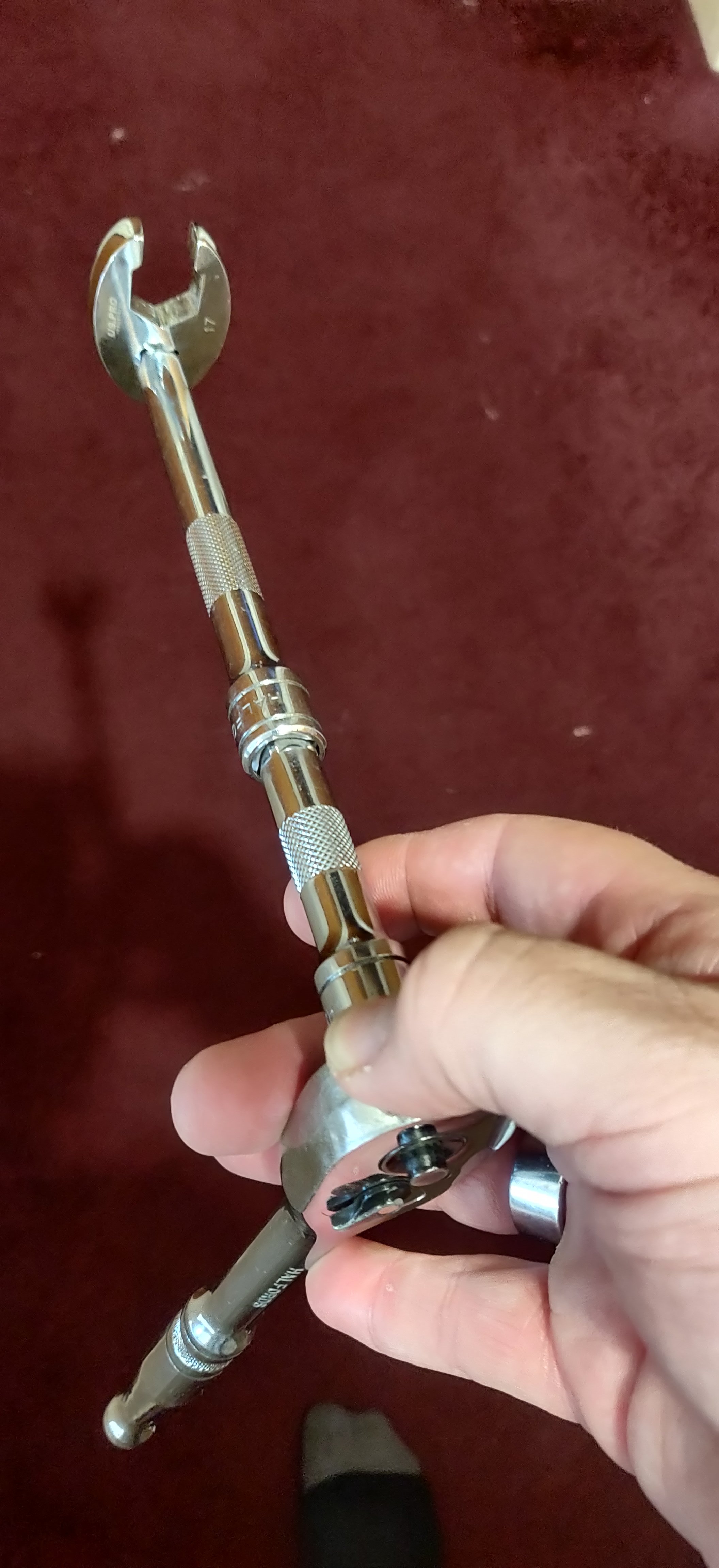

So I replaced the a/c pressure switch situated at he front of the a engine bay on the left (circled). You will need a 17mm crow foot spanner (pictured) attached to a long extention to get the old pressure switch off and the a/c system won't need degassed as it's on a schrader valve.
Fans spin now and a/c works perfectly👍👍👍
