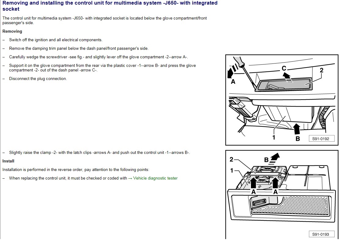

Can anybody let me know how to remove the media in box that is underneath the glove box please. I think I may want to remove it and put something else in that space as I will not be using it in the future. I can see 2 notches down the side is it a case of sliding radio unlock keys etc down the sides?
Thanks
Thanks very muchly.
Is that elsawin manual?
yip
Thanks may have to purchase
