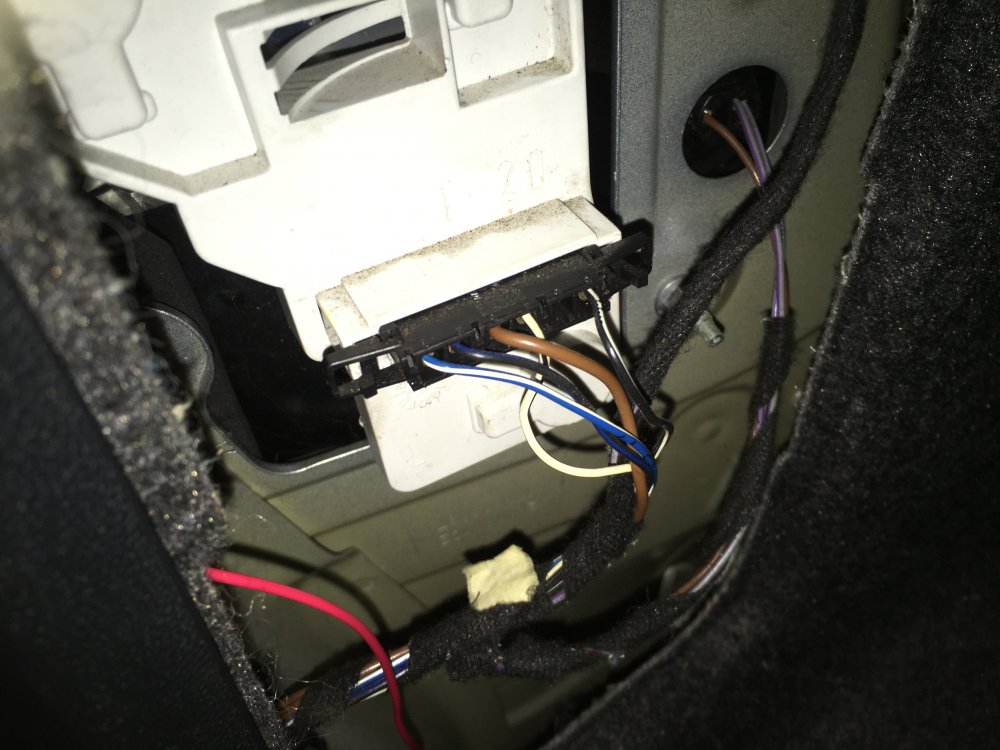

Hello, i am new on this forum and have couple questions, but trying to first google it and found it here, but about this one i am not sure at all.
I bought my first Skoda two days ago, cool, right?...
I bought dashcam as well and i dont wanna some how ruin my car straight away, i did wiring without troubles (i guess) and now have just little problem,
i am not sure at all, where to put my red wire (signal for reversing, so back dashcam will record). I did maked picture of my back light and i just secretly hope,
some good soul will know and tell me, which wire is the reversing one, thank you very much.

Black wire with the blue stripe is the reverse wire
