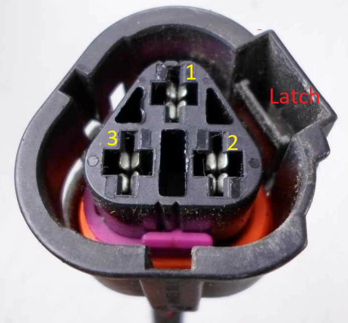

Have you tried linking pins 1 and 2 of the radiator thermoswitch loom connector (the contacts either side of the connector latch?
I will try that... would this cause the fan to kick in?

Yes, if the fans work at low speed they should both come on when those contacts are linked, if everything else is OK.
If they don't come on when you link 1 and 2, turn on the ignition (engine running or not, doesn't matter) then link contacts 1 & 3 instead. This should bring both fans on at full speed.
Nothing is happenning when connecting 1 and 2
when these two connected I can hear a click and to me souds like it's the relay but no fan is turing
I've tried it with ignition on.

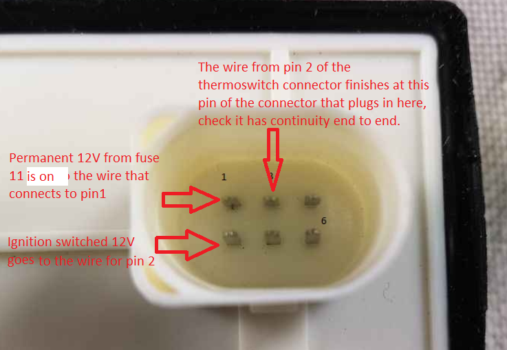

I would expect at least a click from the module, if the wire between pin 2 and the fan control module is unbroken, maybe check the continuity of that brown/blue one; pin 3 of the 6-way connector at FCM.
Were all three of the fuses I mentioned OK?  Check that you have 12V (always) at pin 1 of that 6-way and at also pin 2 when the ignition is switched  on; while you're there.
Both fans may have completely worn out and failed at both speeds; they are 20 years old if original.  Brushes sticking in their holders seems to be a common fault, as well as the super-common low speed resistor burnout.

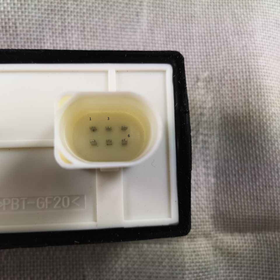

COOLING-HEATER-FAN-RELAY-CONTROL-UNIT-FABIA-MK1-MK2-OCTAVIA-MK1-1J0919506M-1J0-919-506M-1J0.jpg_q50.thumb.jpg.dd94a4ddff7fde5c5342d326b9a5563c.jpg
Would it be them  three to check or on the plug which would go in to this socket?
  • Sponsor
Nearly, not pin 6 though.
