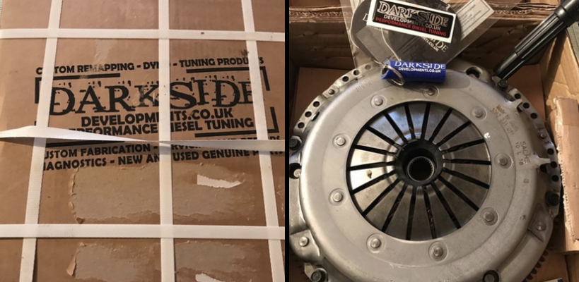

Can’t complain with the Darkside kit. Pricey but rated to 300ft-lbs. Holds the power well and with launch control. 😂

I've got experience of both the ECS and Darkside kits. The Darkside kit definitely wasn't £900 though. This is the one needed for the VRS:
https://www.darksidedevelopments.co.uk/products/darkside-silent-g60-single-mass-cast-flywheel-clutch-kit-for-5-speed-02j-02a-02r.html
I put the ECS kit in my previous VRS and went for the lighter flywheel option. That was about 10 years ago when the kit was about £200 cheeper than it is now. My Dad has the car now and the clutch still feels just the same as when I first installed it. Nice light pedal feel, perfectly smooth operation and no noise whatsoever going from dmf to smf. If you didn't know it had been fitted, you'd assume the car was still running the standard equipment.
My current Octavia has the Darkside kit, which I installed in 2016. I went for the Darkside kit this time rather than the ECS purely down to the price hike. The Darkside kit is just as good, as ultimately they're pretty much the same performance wise, but if I had to give a preference, the ECS is definitely smoother, particularly when pushing on.
