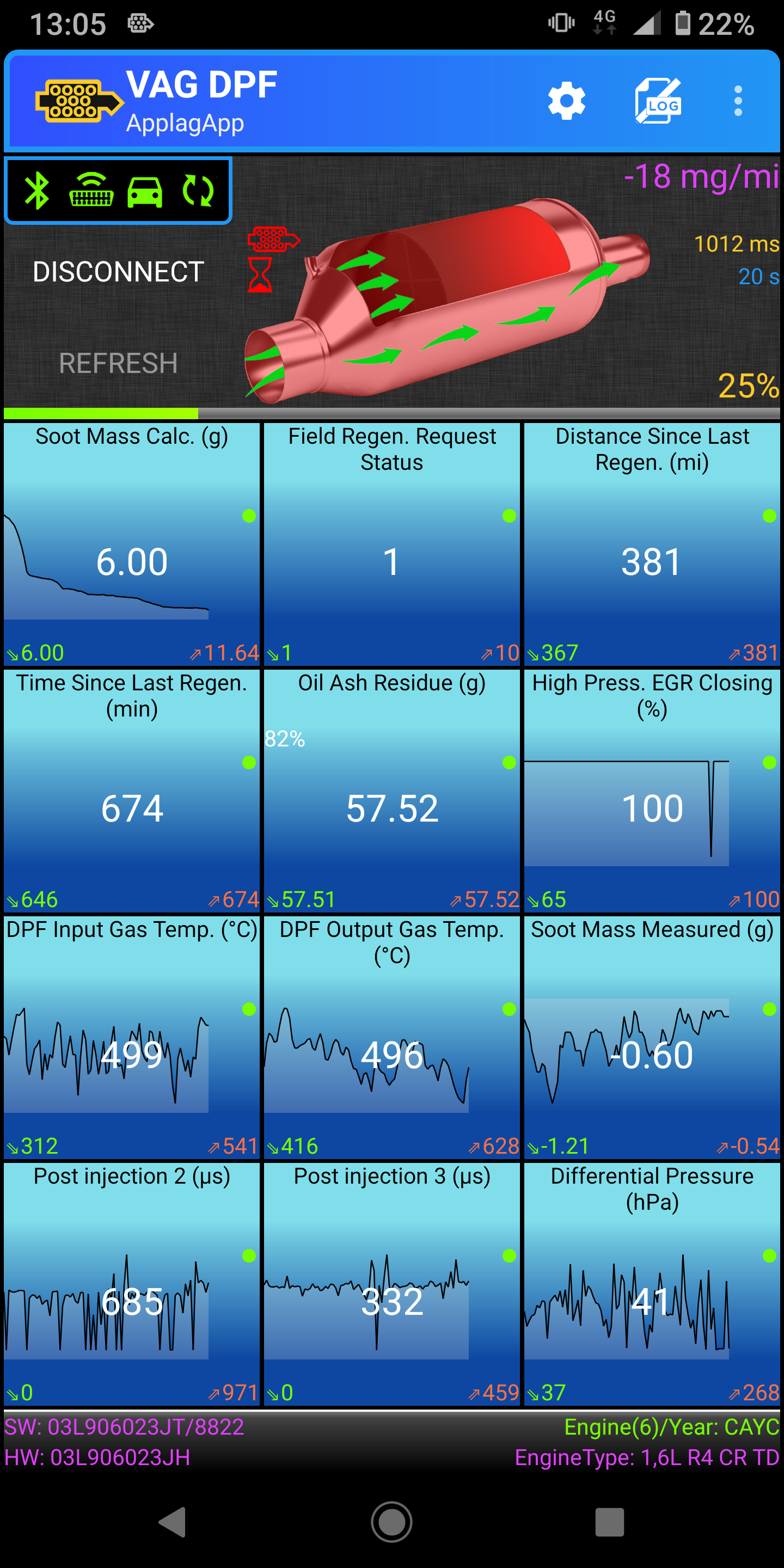

What ECU software version is yours running, mine is 8822.

Although EGR is now blocked on the inlet side of the block, and mapped out ... I still get limp mode during regen.
A live scan by VAG DPF shows a constant 100% closure of the EGR, except for a minor flutter down to 0% closure when limp mode is activated.
Why should EGR have this effect when 1) it's blocked and 2) it's remapped out ?

Proper remap and a blank.
I just wonder if one blank is sufficient.
I'm not sure why egr values are still showing if it has been mapped out. The issues we had were at you said egr related in the end, just put a new one on and the problems have gone. If you have a blanking plate for the other end, I'd be inclined to put it on anyway just to eliminate that side of it anyway.
