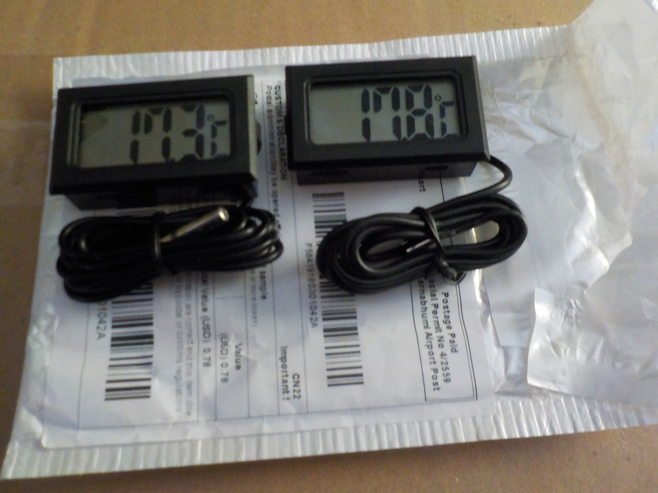

Many ways to get intake temps, OBD etc,  i use the simplest,  a £1.99 Digital Fridge Thermometer works.
That is good for reading Cold Air Intake temps, engine compartment temps and many other things like, tyres, brake discs or  a passengers temp.

I have used them in a dipstick tube to check oil temp.
