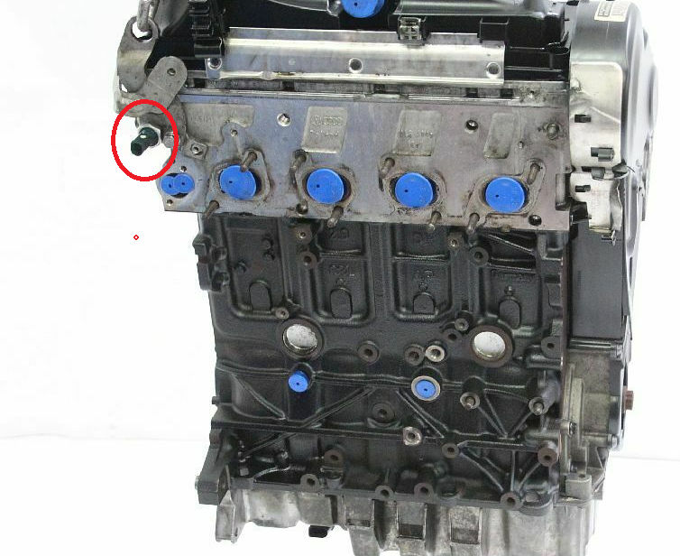

Does anyone know where on a yeti the oil pressure sensor is fitted, because i can not find it .the yeti i have is a 2011 2.0 tdi 140 b/h/p not 4x4,any help would be very welcome

Hello and welcome.
Engine code would help, look on the build codes sticker in the boot, or service book.
I'll try to find without, but always easier with.
the engine code is CFHF for the yeti

This looks like it here, I think. If it only has a single wire connection, that's almost sure to be the oil pressure switch:
🙂, thanks for your advise on the location for the oil pressure switch. i have found it so all is well so far, just got to put all the pipe work back on now as it up on the passenger side bulk head.
That photo will be very usefull for the next time I remove the upper cam belt cover for an inspection, I knew that it was hanging up on something at the rear and its a leap of faith with these things working blind to deduce how hard you need to pull to release a sprung fixing or that you have missed something and are likely to break it.
