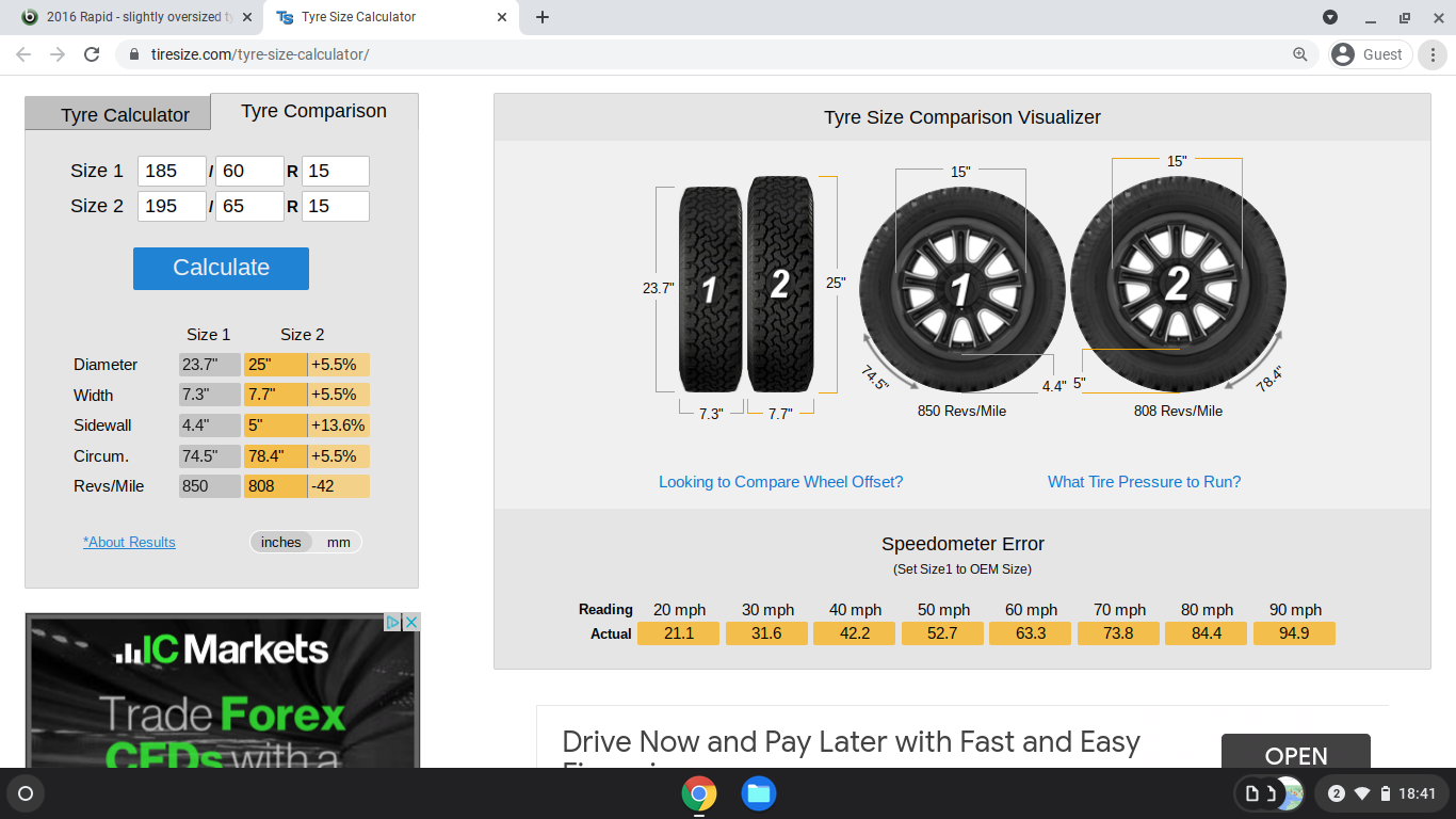

httpS://tiresize.com/tyre-size-calculator/
Having an over reading speedo reading accurately with tyres bigger than OEM is something i like.

If you want oversize tyres, 185/65R15 has a 3.1% bigger outside diameter than the standard 185/60R15 size.
195/65R15 has a 5.2% bigger outside diameter than the standard 185/60R15 size.
With 195/65R15 there's a risk that rubbing will occur when the suspension is fully compressed.
