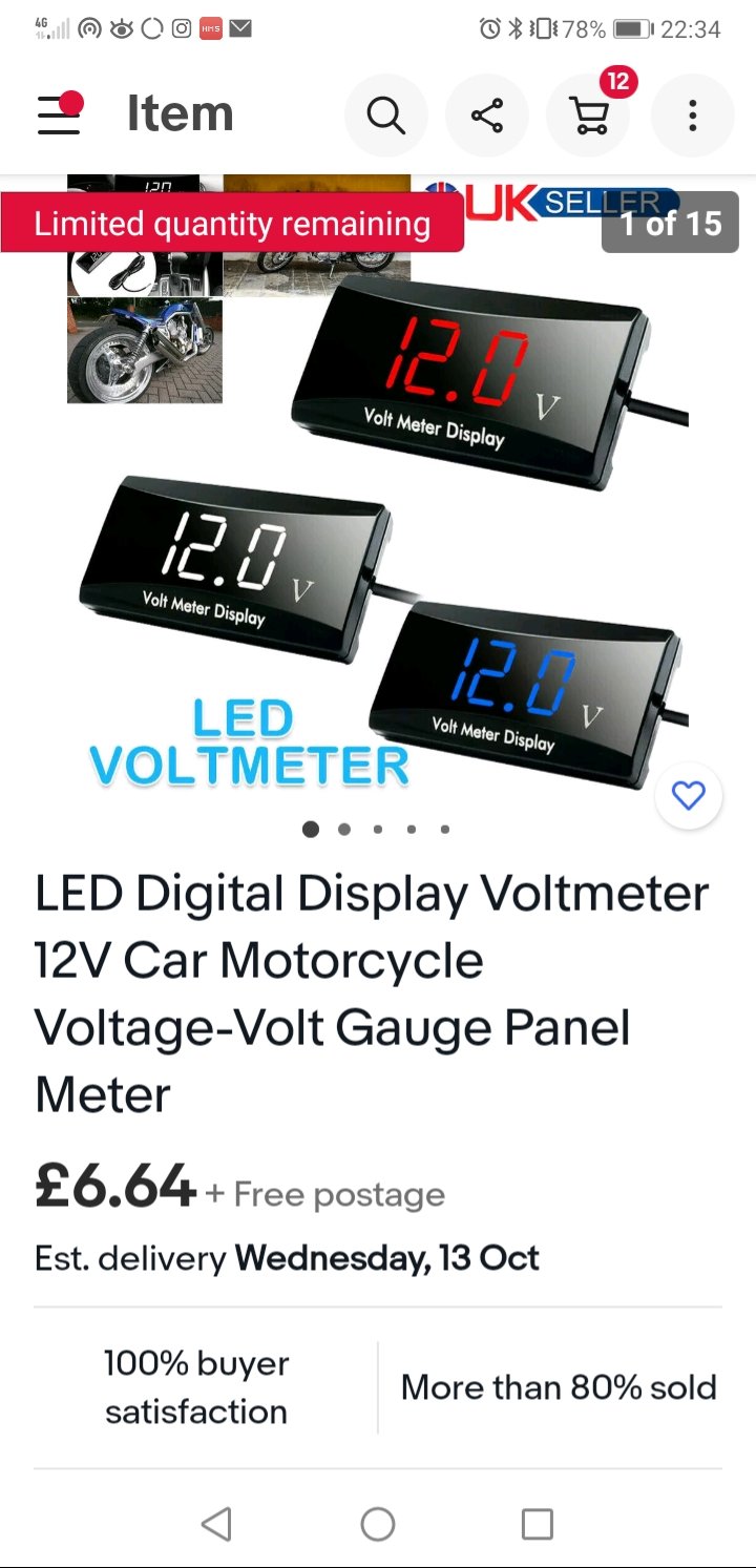

You could use it to test the battery voltage, but if I was using a dumb car battery charger I would connect up a constant voltmeter possibly using something like this cigarette lighter socket with crocodile clips and with an LED/LCD cigarette lighter voltmeter plugged into it. You can then see what voltage the dumb car battery charger is charging the car battery at. However, I wouldn't try fully charging the car battery using a dumb car battery charger, because if you keep charging the car battery when the battery is full you will damage it permanently (and new car batteries aren't cheap):
