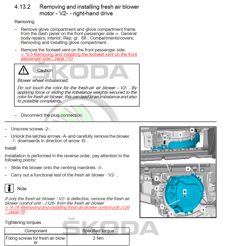

Mk3 RHD Superb heater blower motor removal
I have a 2017 RHD Superb with all options including entertainment box which is located in glovebox. I have watched mutliple youtube videos prior to trying to remove my blower fan which is making the well known squealing sound and it all looked simple. These all seem based on Octavias, Golfs and other MQB platform cars. When I followed the instructions and removed the glovebos and foam insulation I was amazed to see there was no access to the unit. I then unscrewed the surrounds and removed that all but still co clear access. Does anyone have advice or a link to a video showing how to remove the part on our vehicle please? Any help greatly appreciated.
