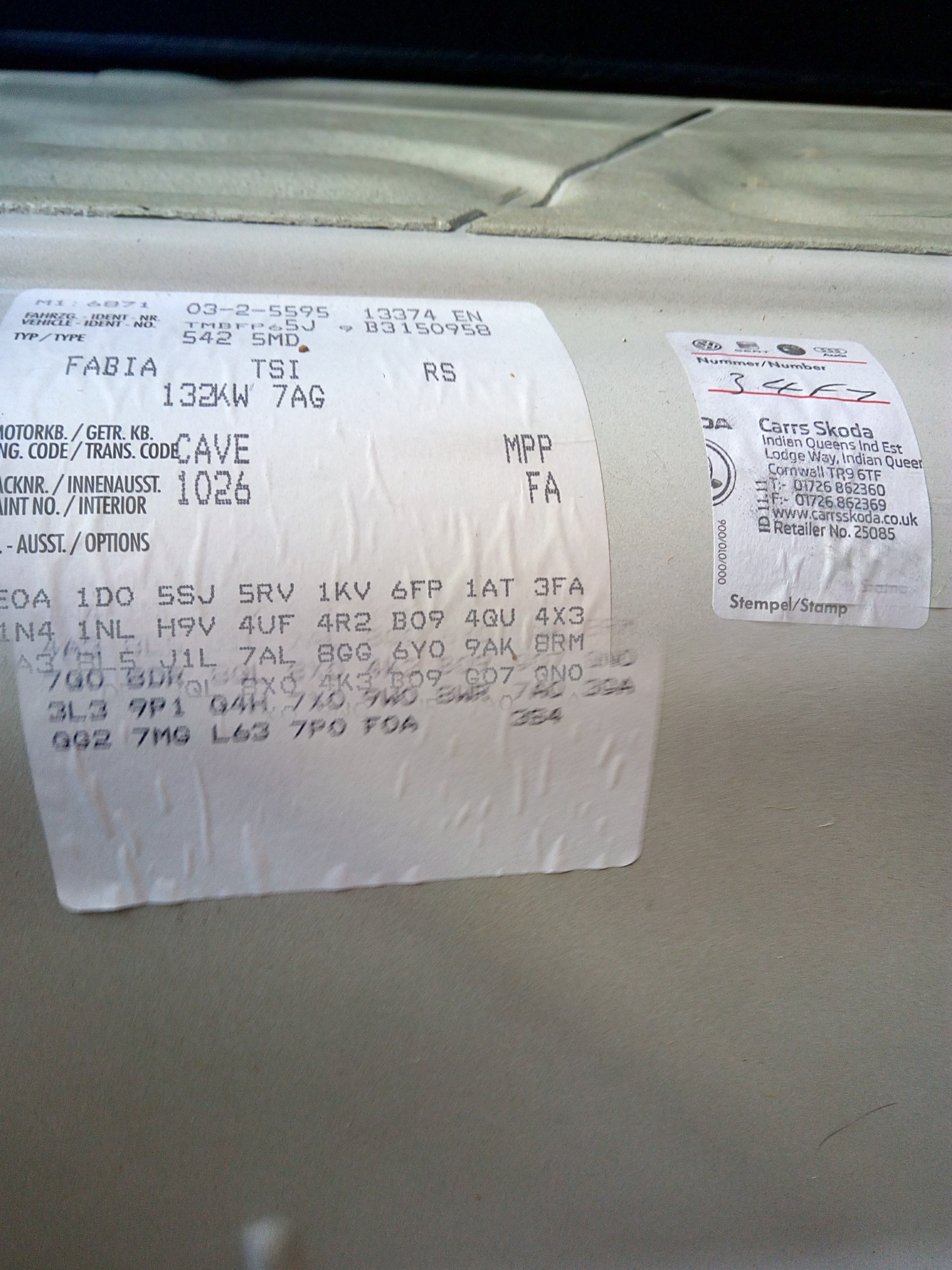

The oil will have been changed if the 34f7 sticker is in the spare tyre well showing the Service campaign done.  That was since 2014.   Look in the Mk3 section and the Famous dq200 clutch slip thread.
 shows the DSG oil change.  And oil spec.  There is 2 oils. One in the box and then the MCU.    Bumped it for you in the Mk3 section.

Skoda UK should certainly know if your car was in for 34F7 so the oil changed and the software update sometime from early 2014.
Or if it was one they oddly said was not part of the Service Campaign.
Some people just never had it done.
It used to not appear on here then it did start to if outstanding.
